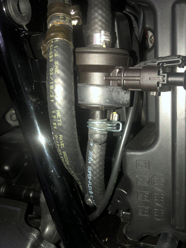

Offline inditx
  • Posts: 1506
  • Location: KC Area
Re: New V7 Special 850 Stumbling
« Reply #33 on: May 12, 2022, 07:58:04 PM »
It's not necessary to plug the hose.  You can see the hose tucked in behind the control valve in this picture.
inditx
