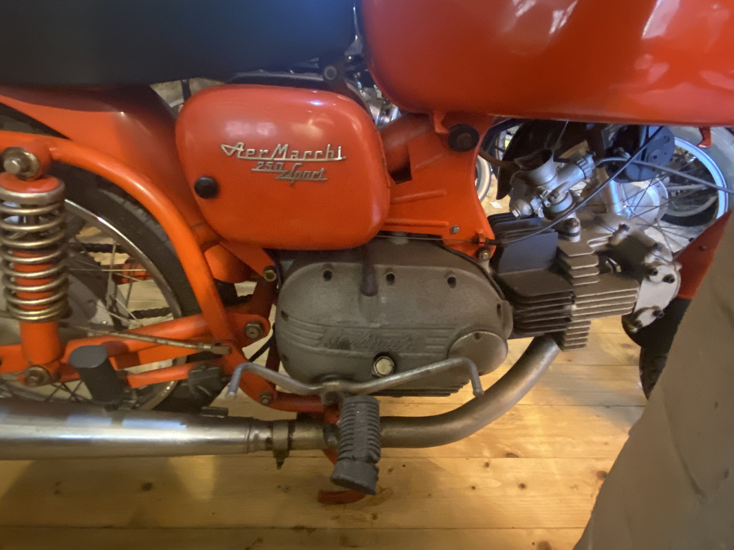

I got inspiration from an Ala Azzura (Blue Wing) that was on display at the Italian Transportation Museum, this was the first model imported to North America that was sold as the Wisconsin, the Ala Verde (Green Wing) has the longer tank, exposed shock springs, slender rear fender, clip on bars

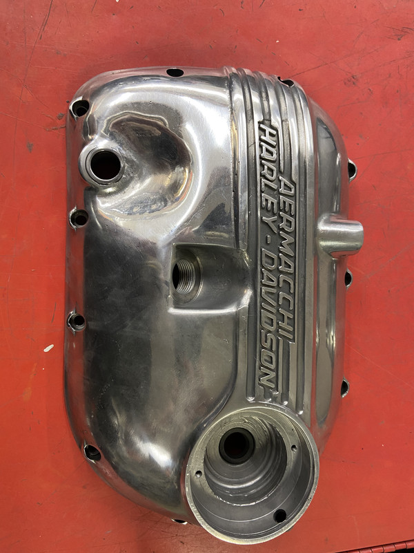

My friend George finished welding up one of the Aermacchi engine covers I got at the Imola swap meet in Italy last month, some time on the mill with a boring bar to cut the points recess circular, and a lot of hand sanding and its pretty darn good IMHO
A wee bit of pitting but thy were not perfect leaving the factory
this cover is the top one in the picture prior top welding and sanding, one more to go

The ‘second’ engine side cover I brought back from Italy this summer had been welded up very poorly. My friend George the professional welder tried TIG welding up the holes but the filler material used was very contaminated and kept popping with each pass. After two attempts to weld the case George decided it would be best to cut out all of the old weld and make a new piece to weld in.
George used a plasma cutter to remove a large section of the case. A new piece of 4.5 mm aluminum was formed in a hydraulic press to create the concave firm and then after a lot of forming with a hammer and anvil the new piece was tacked in
Welded up from both sides
Plenty of work with a die grinder, file and sanding and it’s pretty damn good

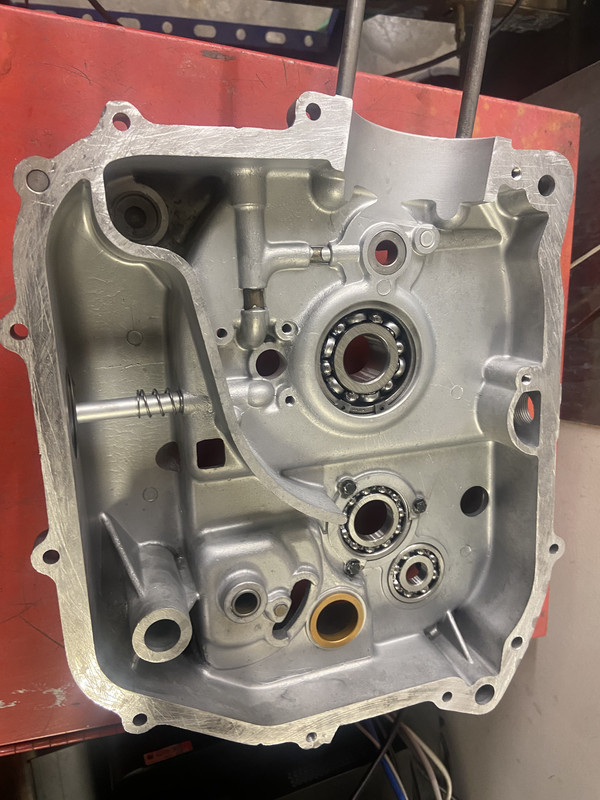

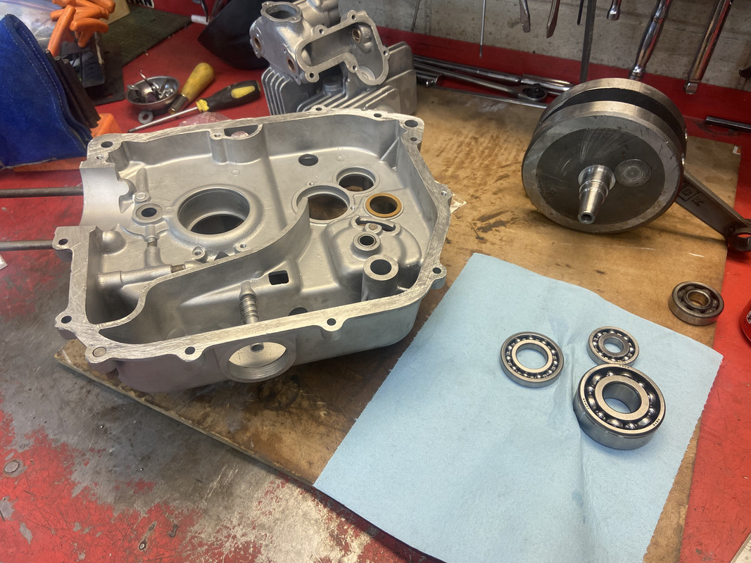

This past Saturday I stripped down an Aermacchi 250 motor and ordered all new case bearings from 123 Bearings in France, amazingly the order arrived this morning including the shaft seals.
Cases heated to 300F for a good half hour, bearings cooled in the freezer, bearings drop in with a satisfying clink.

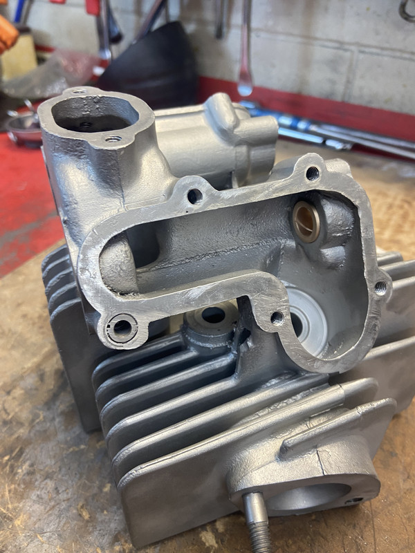

The head has been heated as well and the worn valve guides drifted out, new guides on order.

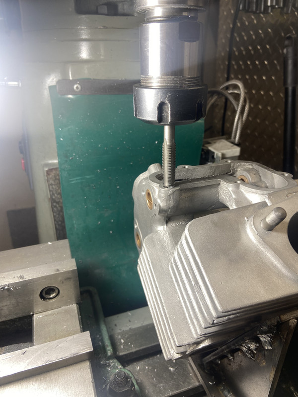

I noticed three of the rocker cover recessed 6mm holes are striipped. Not much extra metal around the holes for an insert so I have to be precise drilling for the inserts. I made a steel plate jig that I can bolt the head to at a sixty degree angle to the milling machine table, some shimming to get the rocker cover face dead level in all directions then drilled and taped for the steel insert.
I set the tap in the mill collet and rotated the quilt by hand to tap the inserts M10 x 1.25 inserts.
Thread the insert down and stake the setting tabs
After locking the insert I flat file the top of the insert flat with the rocker cover gasket face
Three inserts installed and the head is good to go for new guides and a valve grind

The power sport machine shop I use called to tell me the rebuilt crankshaft with new connecting rod, pin and big end bearing was ready and the bored out cylinder were done.
Sonny’s Aermacchi had the NOS con rod kit and Pooles Cycle in Hamilton, Ontario had the 1st over piston kit.
I followed a YouTube series Paul Brodie has run on building an Aermacchi race bike and used his method to shim the transmission shafts, end float shimmed to .004”.
Waiting on the machine shop to finish installing and reaming the new valve guides and cutting the valve seats.
All case ball bearings and shaft seals from 123 Bearing.
