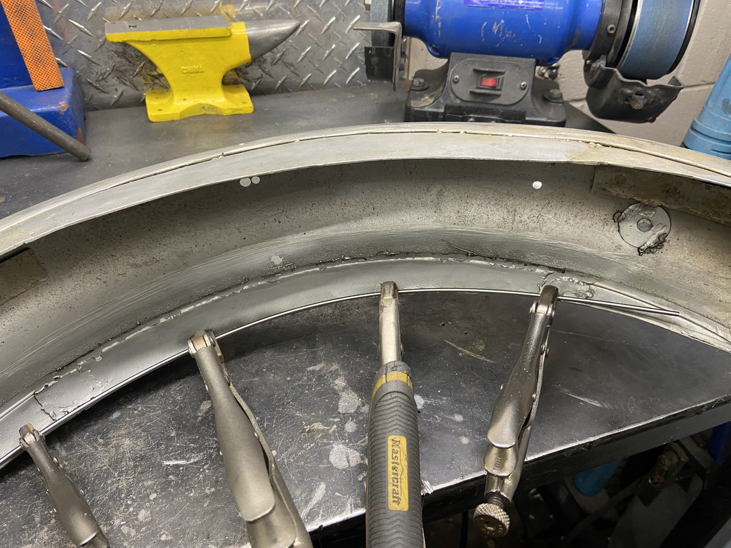

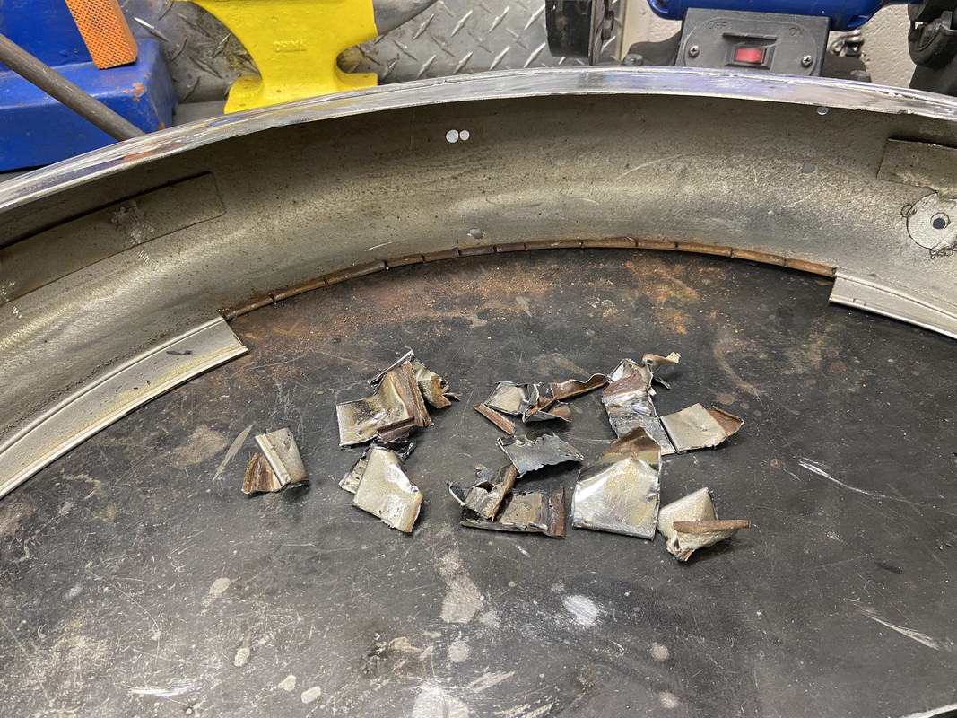

This week I tried my hand at some sheet metal work, the rear fender I am using is off a Sears Gilera 106, it is the closet thing I could find to match the Aermacchi Ala Verde rear fender, like the Gilera the Aermacchi has a 17" rear wheel so the radius and clearance to the rear tire works with this fender. The problem with the fender I have is it is pretty beat up, the rear of the fender is cracked and a lot of rust at the edge and the sides are flimsy and cracked as well.
I decided to cut out the side panels and replace them with solid metal cut from 22 gauge sheet stock. A card paper pattern
Cut out the old steel
I folded the top edge of the patch panel to rest on the lock seam of the main fender
Then welded in the patch
I bought a couple tool steel rods, 1/8' diameter and welded these to the inside of the patch to make a beaded lip
I blended the rod to the original folded lip
I had an Aermacchi rear fender I was not using and cut out the rear of it to patch into this Gilera fender
welded the patch from both sides and ground down the welds
I think it all turned out quite well, I will lead fill the joints and and though it will weigh a lot more than original it will do the job

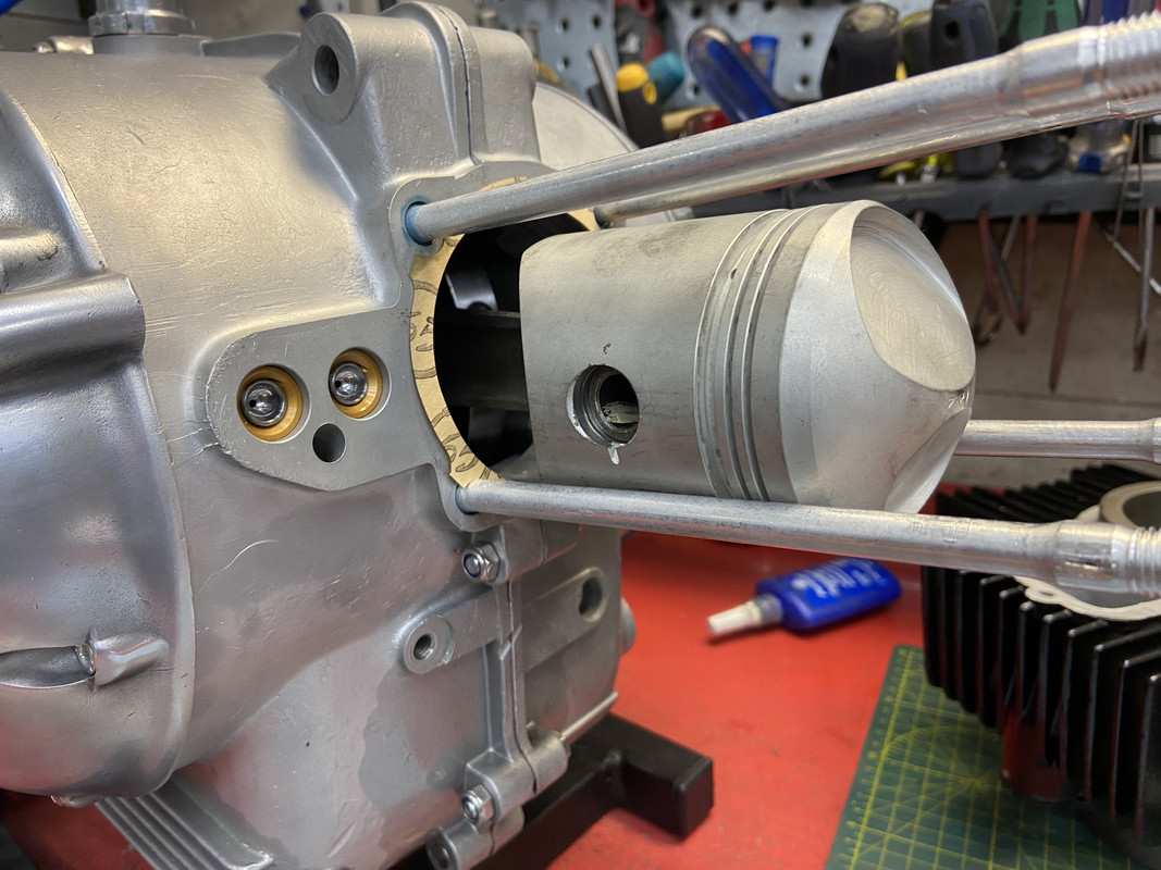

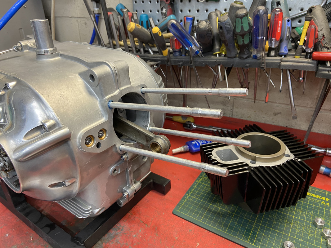

I got the engine head studs back from the plating shop and torqued down the studs and installed the piston, waiting on the machine shop to finish the head

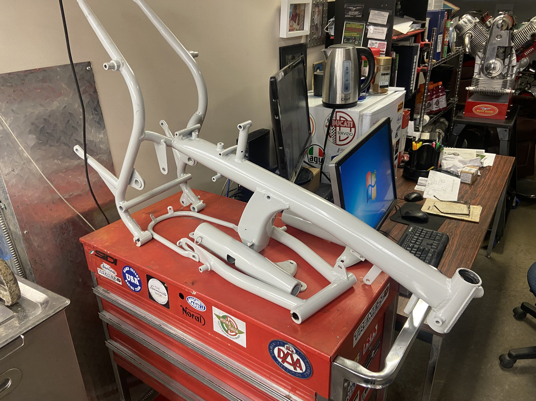

I sent the rest of the frame parts off to be media blasted and given a coat of primer powder so I can reassemble for the dry build.

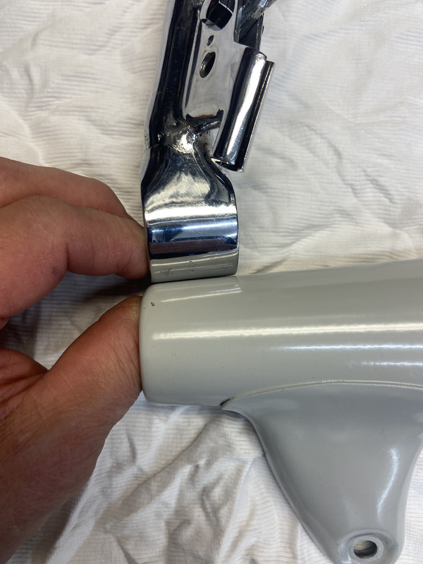

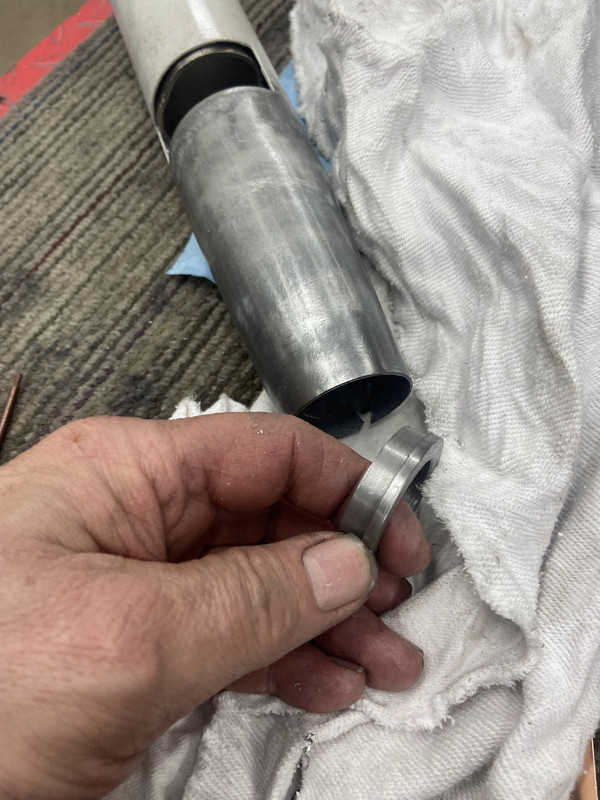

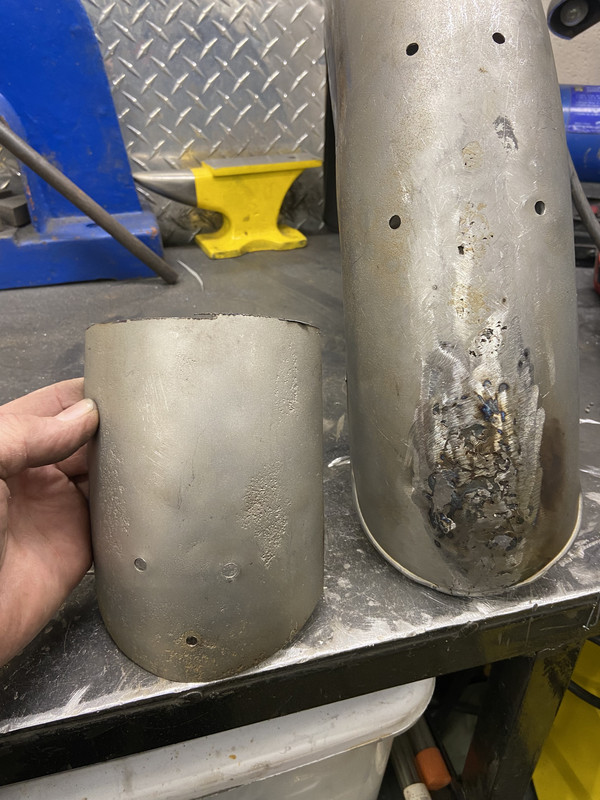

This is what I need to modify, the clip-on bar neck is 30mm tall so the fork shroud needs to be reduced in height the corresponding dimension. It is not a simple matter as cutting the fork shroud down 30mm as the welded on head light ear is attached less than 30mm from the top of the shroud and the upper half of the shroud is tapered.
So the plan is to remove the headlight ear with an Autobody reciprocating saw and the re-weld the headlight ear lower down the shroud and make a new steel cap for the shroud through which the 30mm diameter fork tube passes. I made a steel tube section to fit inside the lower shroud section and chucked the shroud in the lathe with copper sheet as a buffer to the chuck jaws and I turned a piece of aluminum to fit into the 30mm hole in the top of the shroud.
Saw and cold chisel to split the spot welds. Then I cut 33mm off the shroud in the lathe.
From a steel billet 50mm diameter I turned new caps that sit 3mm above the cut off shroud and 6mm stepped inside.
I then welded the new cap to the shroud and repaired by weld any damage to the shroud from removing the headlight ear.
The rebuilt shorter shroud next to an original
And mounted in the triple clamp with 30mm O rings either side of the clip-on bar.
It worked out very satisfactory and I finished the second shroud to match. Next to repair and revels the headlight ears in place. I have a second set of shrouds with identical headlight ears but different shroud dimensions that I will carefully cut the ears off and then weld to the shroud.

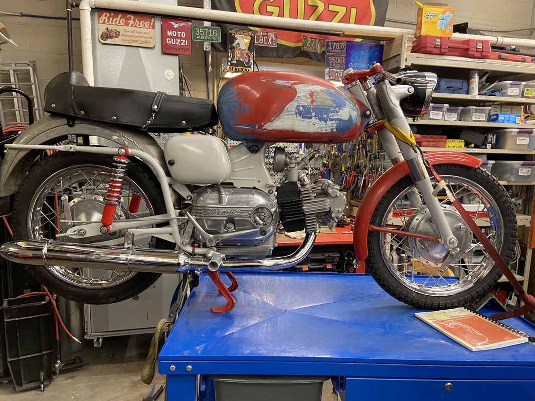

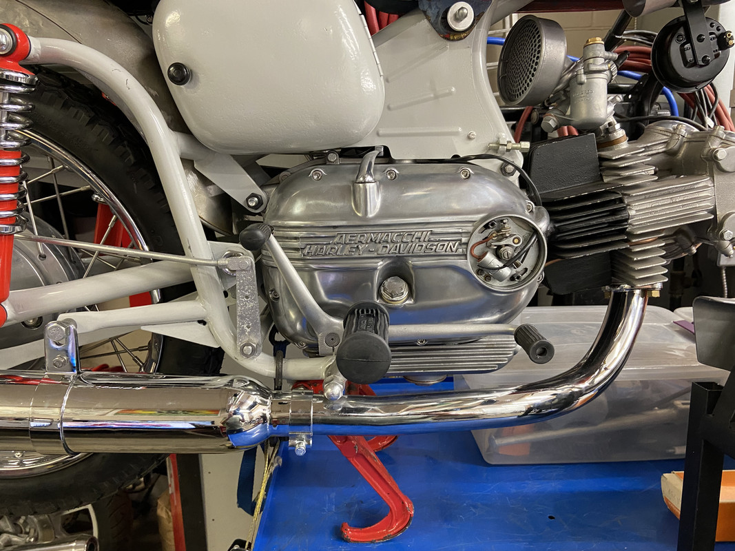

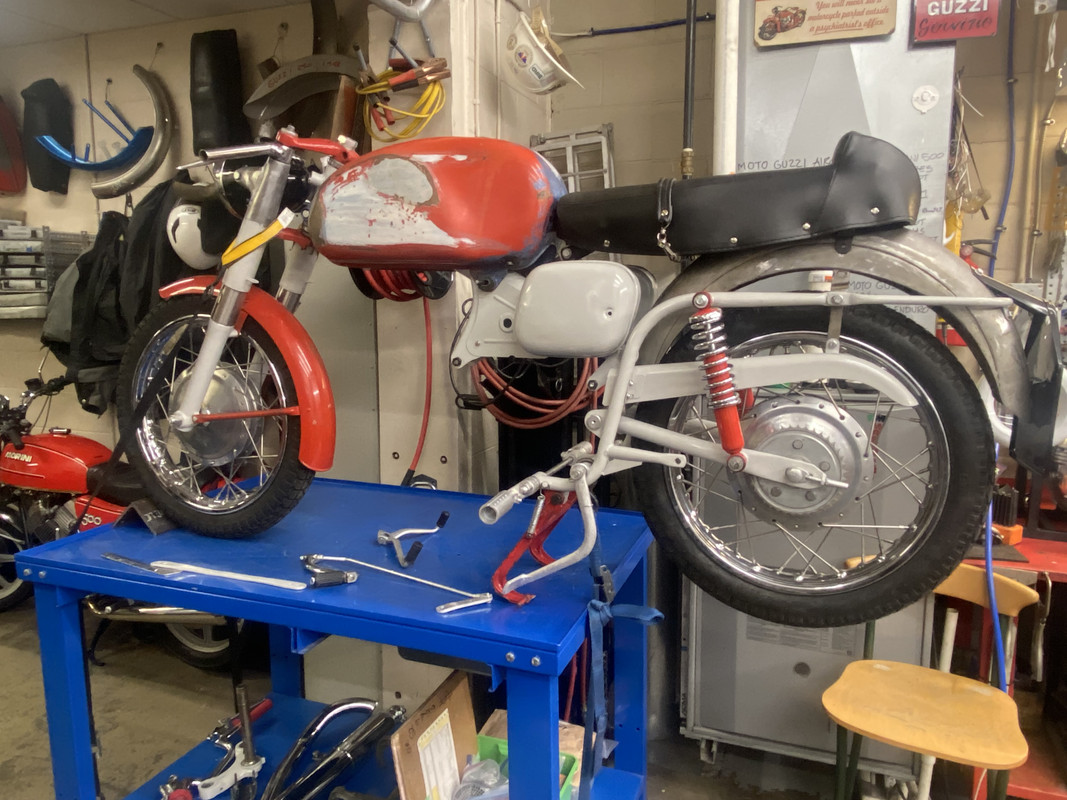

The Ala Verde tribute dry build continues ....
I opened a box of reproduction rubber parts I bought from Italy and the foot rests stamped "Aermacchi / Harley Davidson" will not fit the riders foot rests that came stock on the North American market Aermacchi bikes. The Harley marketed machines have a robust foot peg that folds up and has a complex mount bracket to the frame with notched mating parts to adjust the height of the pegs, very nice!
Just when I think I have the Ala Verde thing figured out a new glitch pops up...
I have learned European market bikes have a rigid foot peg, the shaft is about 5/8" diameter,
My friend in Italy who has recently provided me with some rare parts for this bike sent me these pictures today of the Ala Verde foot rests
Massimo is going to send me detailed pictures of his Father's 1961 Ala Verde foot rests and close ups of the frame mounts.
I can make copies of the European foot peg easily enough.
I also found out I don't have the seat mounting rear bracket correct, the Ala Verde doses not have the exposed vertical straps at the rear, only a single bolt trough the top of the rear fender.
I am getting closer to solving the puzzle.

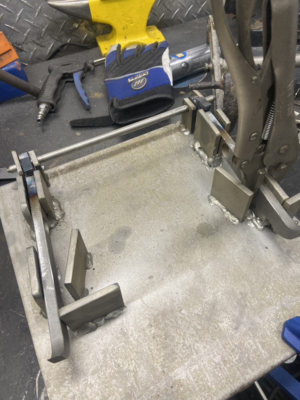

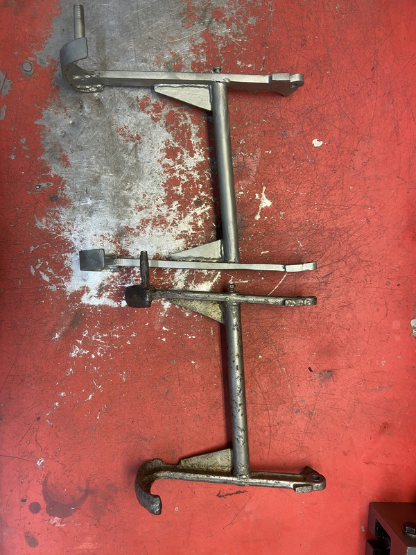

I made up a copy of the Aermacchi center stand, a version for bikes with 18@ wheels and a copy of the original for 17” wheels
I made plans in AutoCAD and had the plate pieces water jet cut from 10mm plate and 5mm plate, the center dowel is 19mm solid rod. I made a welding jig using an original stand to make the jig.
I cut the recesses into the side plates on my milling machine
Lots of fiddling, grinding and welding
Needs some finishing of welds but it’s a decent facsimile of the original

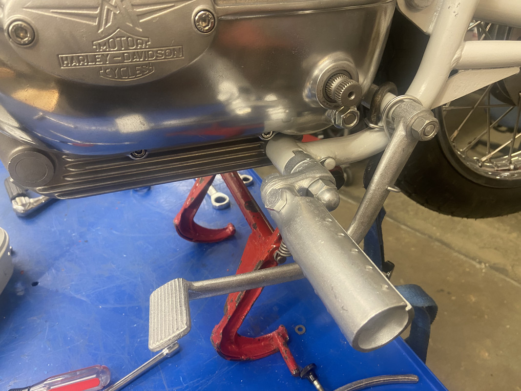

The Ala Verde foot rest brackets differ from the typical Sprint style, to begin with they do not fold up nor do they rotate on their mount to change position.
These are the stock US Import style, very well built and clever design how the castellated mating pieces allow for easy peg height adjustment.
The Ala Verde type cast pieces, provided to me once again by my friend Massimo in Italy! Thank you so much for sourcing these for me.  :bow:
and with the reproduction Ala Verde type foot peg rubbers
little details, but they all add up, I feel like I won a lottery lately finding these Ala Verde unique bits.
