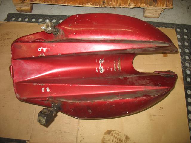

Over the weekend my painter sent me a picture of the bottom of the gas tank. Behind the petcock bungs the seams of the tank have been bent over right at the point where the fuel tank rubber rests are.
Has anyone noticed this before?  I'm thinking it's either the rubber rests were not positioned correctly and the tank was riding on the frame rails or the factory does this to stop the tank from hitting the frame. If its the the former, next question is whether we attempt to bend it back without breaking the weld.

this is an original V7 Sport tank, the seams are slightly folded over aft of the fuel taps, I don't have any pictures of the underside of the other Sport / S / S3 or Lemans builds

Thanks for taking the time to post the picture Jim. Mine is folded over a bit more than that yours, looks like its intentional from the factory, perhaps to just to hide the seams a bit in a visible area. This picture shows what it looks like on the bike... seamless so to speak.
