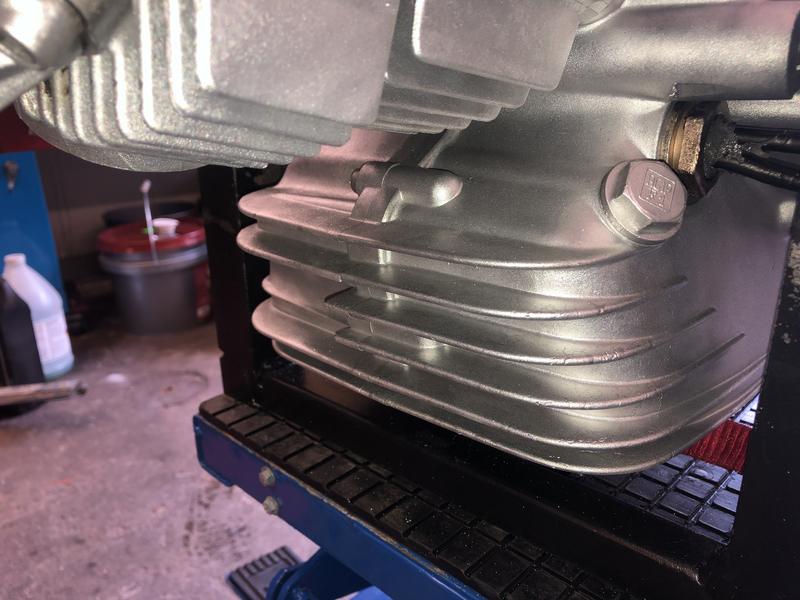

I used VHT Engine Case Silver - over VHT grey primer, after stripping to bare metal. I only painted the rear case of the transmission, everything else is the original silver. It was a bit brighter than the original paint, and it showed more highlights on the curves. I liked it better than the original paint. But from a few feet away, you couldn't really tell the difference.
https://static.imgzeit.com/reduced/881a63f73694baa6/IMG_6528.jpg
I also used VHT Satin Black to redo the entire driveline of a Scura. It is holding up well.

What would you do to get the black off the V85 and do it in silver.
Secondly.
Bring the Norge engine/gearbox back to accept silver as well.

So Canuck and others..
Secondly.
If the black paint is well adhered you could just paint over it. Aircraft paint stripper works pretty good for paint removal, it is available in an aerosol can at automotive paint supply shops.
Really..?
Paint over the black with silver...?
  • Posts: 2165
Re: Engine paint
« Reply #28 on: December 30, 2021, 09:11:56 AM »
Really..?
You might have a hard time getting the old paint off so painting over the original may be your only option. Soda blast will most likely remove the original paint but it’s a messy process if you do it yourself. If you have a strong air compressor and a siphon spray gun it’s worth trying outdoors but do it on a surface that you can sweep up the used soda, the stuff will kill plants. Soda blast is safe on the engine but you still need to seal the motor up.
You have to get that motor very clean  regardless of how you paint it. There can’t be any oil or dirt anywhere or the paint will peel off.
If you leave some or all of the black paint on then I suggest an etch primer first, make sure the primer is good for 400F.
