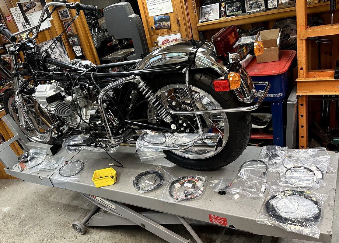

  • Posts: 4431
Re: 76 Convert Restoration
« Reply #89 on: June 23, 2025, 04:24:42 PM »
The brake system bled without drama.  Now it's time to get serious about wiring.
Greg Bender's looms are master class level.
