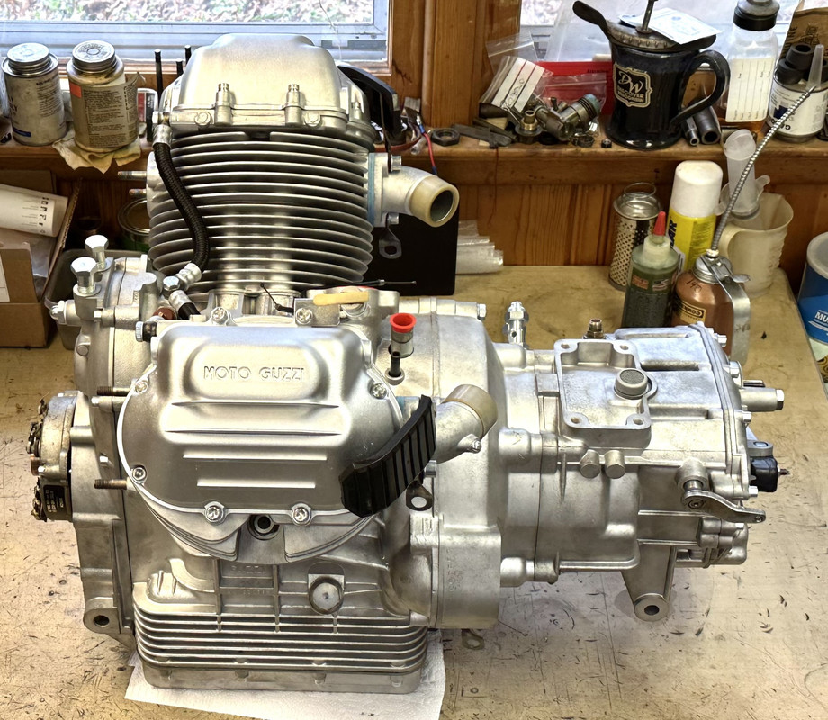

The exhaust valves were quite pitted, so I just put a complete set of new valves in.  The seats and guides were in great shape.
I am currently waiting on my plated stuff to button it up.  Should have all the bits back early next week.

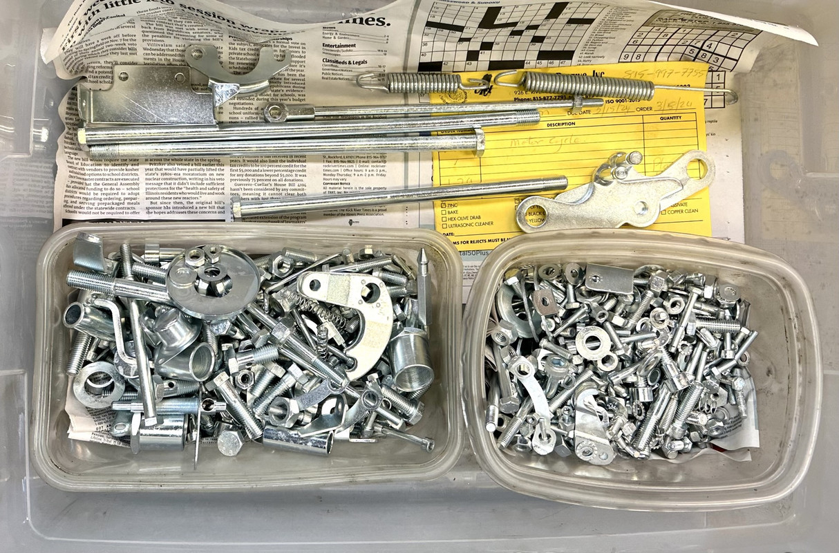

Many hours spent on prep; scrubbing, long sessions at the wire wheel , a few bloodied finger tips (those small bits are the worst to wire wheel), and $93 at the plating company results in this satisfying pile.
One of my favorite times during a restoration - when the freshly plated hardware returns.

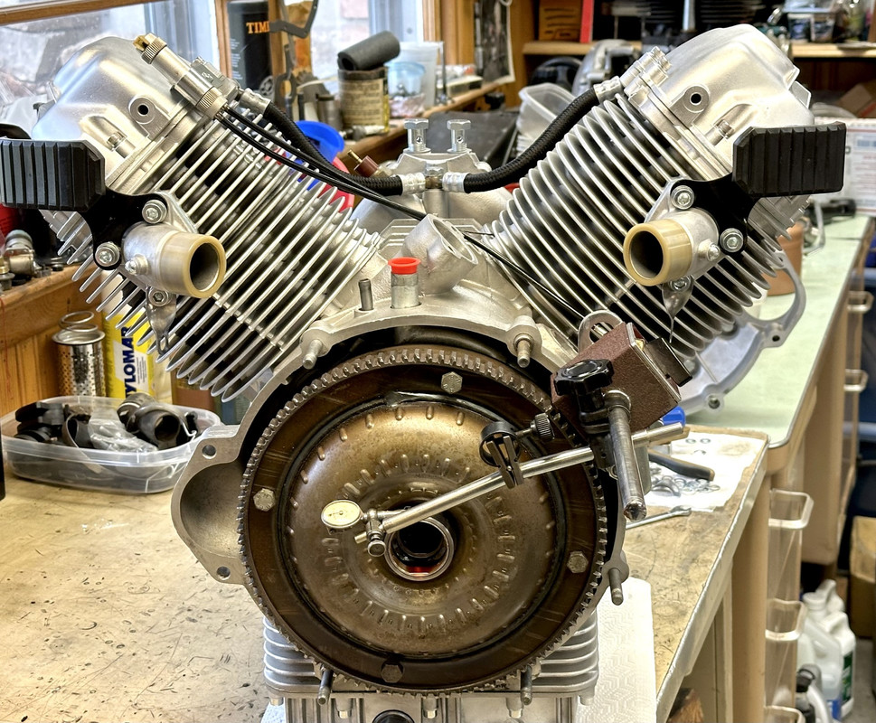

Dialing in the Sachs.
Spec is within .002"  I was able to get it to .001"

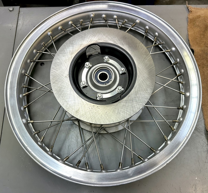

Wheels trued and freshly ground brake disks from TrueDisk installed.  So nice.

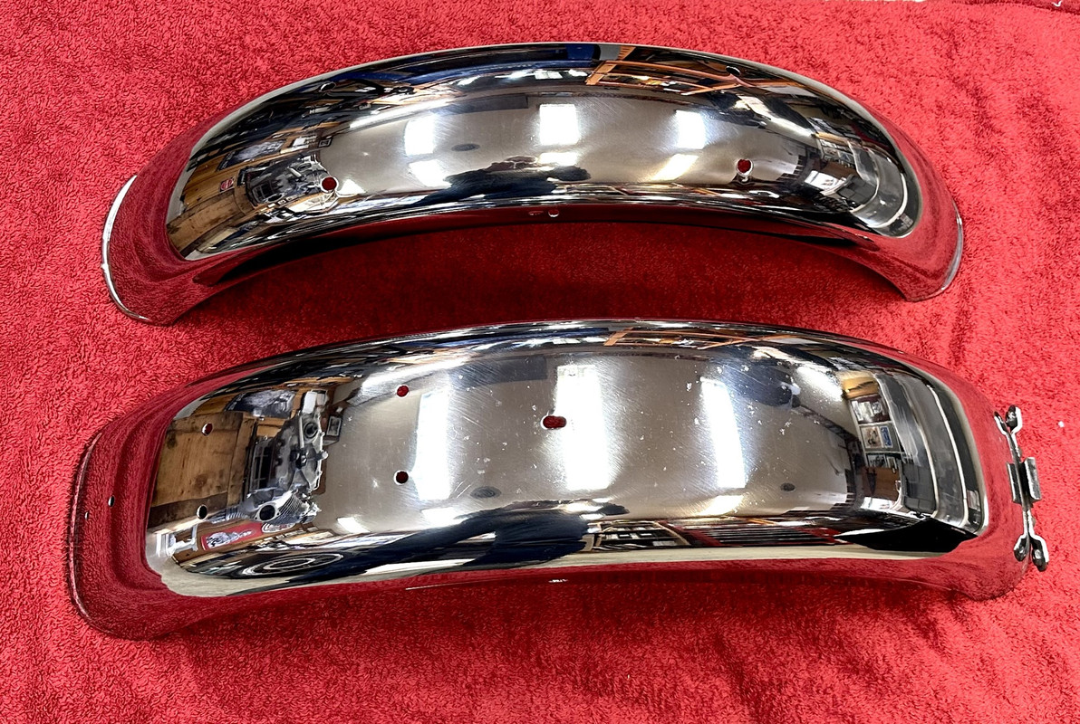

In my continuing effort to be completely upside down on this Convert there was a number of the chrome parts that were too rough.  I had to bite the bullet and have them rechromed.
I am lucky to have a good chrome shop nearby that still does custom work for a reasonable fee.  He is also good with taking dents out of stainless fenders and does a great job polishing.

  • Posts: 15201
Re: 76 Convert Restoration
« Reply #46 on: April 08, 2024, 06:49:53 PM »
Nice!

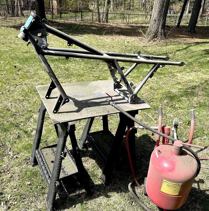

The frame was very crusty and gnarly.  I scrubbed the major grunge off and today I had it outside for open air sand blasting followed by a thorough cleaning session.  It was perfect weather for painting also.

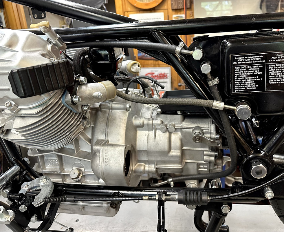

Parking brake is installed and the TC plumbing is all set and primed.  The braided steel enforced lines passed muster but the others were replaced.
