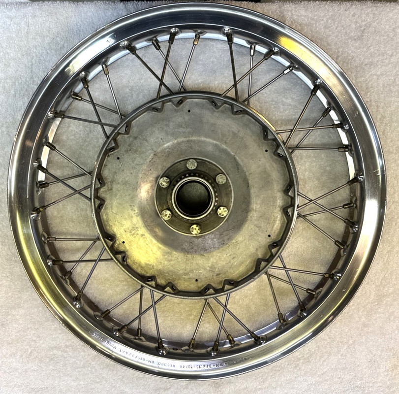

The wheels were too crusty to leave alone so they were taken apart and cleaned up.  Truing next.

Trued, new rubber, and  balanced.  Aahh!  I always love having the wheels finished.  Its a good milestone.
