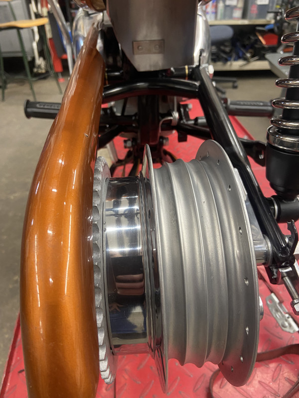

the 5 speed bikes have a wider swing arm and rear hub as the engine drive sprocket sits further from the motor on the 5 speed bikes. I was able to modify the rear hub, sprocket carrier and brake plate to bring the sprockets into alignment with the wheel about 6 mm off center. I will try and offset the hub in the wheel to accommodate that.

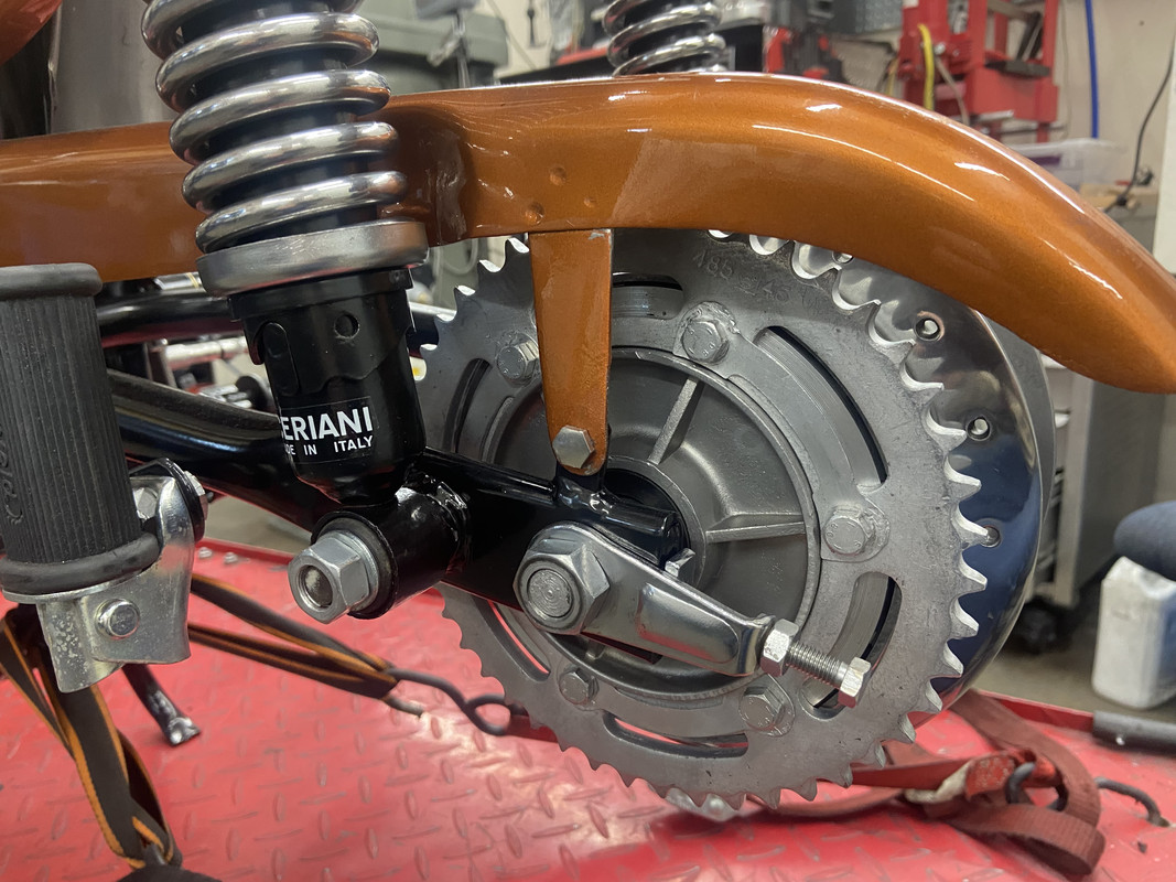

A couple parts came in the mail, new fork seals (4) and a pair of reproduction dust caps, these Marzocchi forks are the same as on my 1972 Benelli 170 Enduro, they take 160 ml of fork oil.
Cleaned the headstock loose balls, fresh grease and fitted the triple clamps, the headlight brackets were polished along with the clip-ons
polished up the scratched fenders with a wool wheel in my 4" hand grinder, man do these FaceBook advertised polishing wheels do the job with a green wax stick, so much easier to hold the fender between my knees and move the polisher back and forth rather than holding the fender while I move it across a bench top polisher.
some pretty deep scrapes in the rear fender but its much better than it was, I think just a finishing polish will smarten them up for good
The chromed spring bands that wrap over the fork dust caps are in pretty bad shape, I need to find some reproductions.
I did order some new '250 Sport Special' side panel decals and a new gel battery that matched the size and look of the original and new 6v headlight and tail light bulbs from B&B Mechanica in Italy - they use the Ebay name 'Bebricambi' plenty of vintage Italian motorcycle parts, new and used on their Ebay store.
Time to move the 'project' to the lift bench before it gets any heavier to lift of the table.

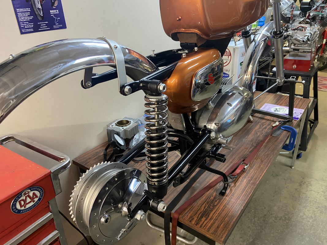

almost out of things to do while I wait on parts to come in, Buchanans's for new spoke nipples, Bennlei Parts.de for exhaust and a piston pin, springs for the rear shocks, the seat to be recovered .....
I had new stainless steel shock springs made, after polishing they turned out great.

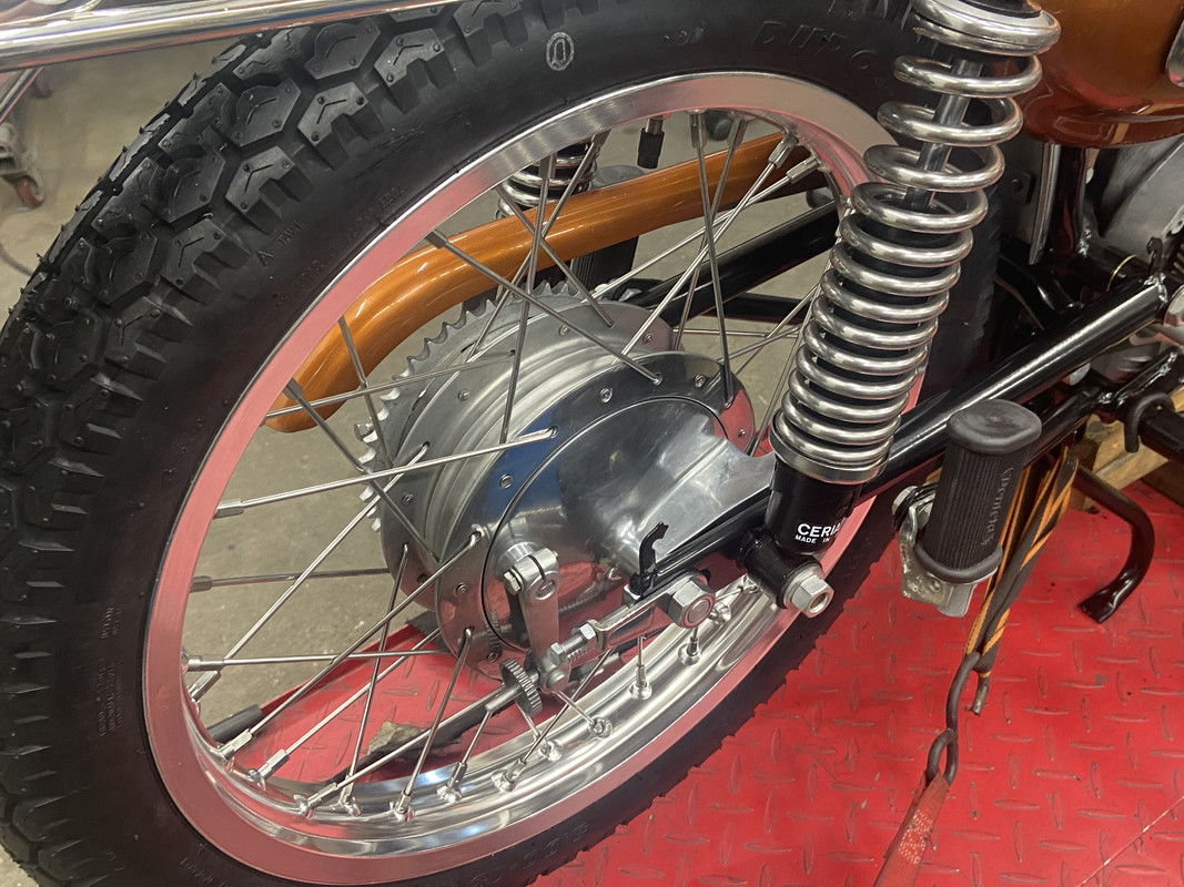

I received my new stainless steel spoke kits from Buchanan’s on Friday, built a pair of wheels today.
The original chrome plated steel Radeli rims are rusty and I don’t want to pay to have them rechromed. The aluminum rims I bought from the Jawa Shop in Czech Republic were cheap at $200 for the pair with shipping but the punched holes in the rims were too big for the original spokes nipples and too small for the new nipples Buchanan supplied. After speaking with Buchanan’s I was told to increase the rim holes to 7.5mm, they were about 7.35mm so it took a second to run the drill through each hole.
I covered the aluminum rims with masking tape as I hate scrapping rims assembly the spokes.
The spokes were made about 6mm too long so after I tried the wheels a due grinder was used to flush the spoke to the nipple.
The rims were probably punched for a bike with a larger hub as the spokes don’t fit all that great, they kink slightly at the nipple, it will work but I wish it were better. I could try and angle drill the hole in the rim but that could just weaken the whole wheel. You get what you pay for….

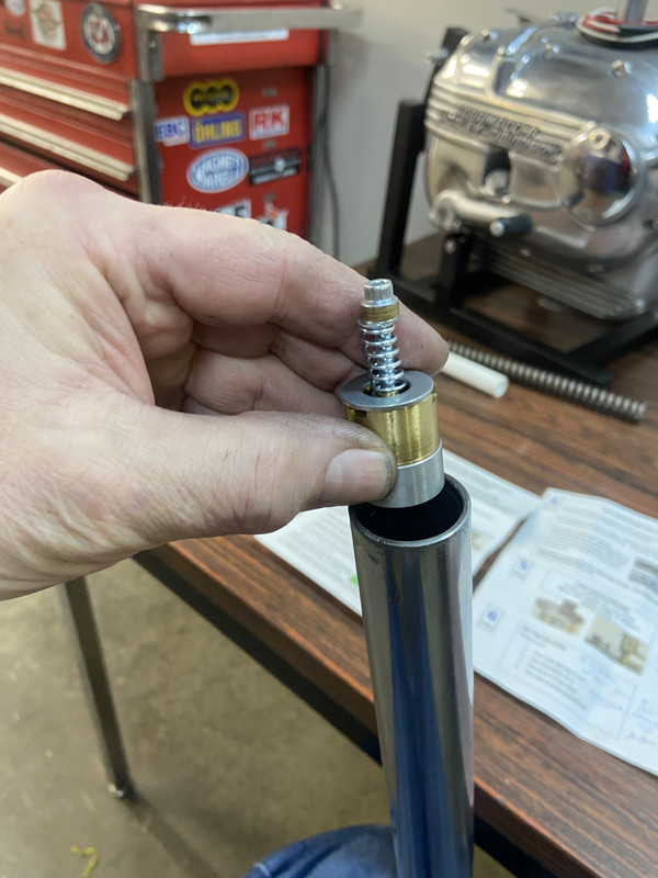

The RaceTech front suspension upgrade kits arrived this afternoon, cartridge emulators and new springs, should make a difference.

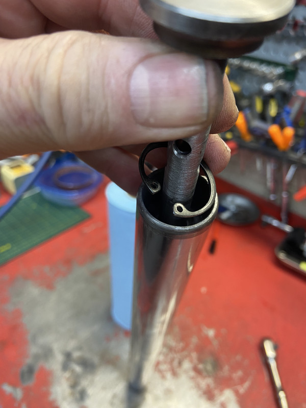

I spoke with Matthew at RaceTech suspension a couple weeks ago, after discussing the potential to upgrade the Marzocchi 32mm forks he asked for pictures and dimensions of all the internal pieces. Matthew called me back and confirmed that he could supply new springs and cartridge emulators to bring the forks into this century.
$415 including shipping to Canada with excellent instructions and everything dialled in according to the bikes weight, intended use and my (over) weight.
Pretty simple to install, the lower damper rods need the four original bleed holes enlarged to 5.5mm and two more bleed holes drilled. The top of the damper rod needed the welded cap machines to fit the emulator and spacer supplied. Also supplied are plastic preload spacers that need to be cut flush with the top of the fork tube. Then just add 110mm of 15wt fork oil and it’s all done.

It feels good to get it back on two wheels,  without the brake shoes, I dropped them off yesterday for relining and arcing.
I got the new piston pin I was waiting on to install the cylinder, the original pin is playing hide and seek in my shop
hose clamp ring compressor
The machine job installed the exhaust guide off center so the valve grind can not be done accurately, damn!! plenty of daylight shining through as a large crescent, it is so obviously not installed right
I put a 200 head on it to see if it would fit but the recess for the cylinder is much smaller on the 200.
Now I am hoping the machine shop can get the guide out and installed true, the guide was oversize and I don't think the machinist put a micrometer on it before he drove it though the head. I supplied the guides and just assumed the shop would measure them before installing them

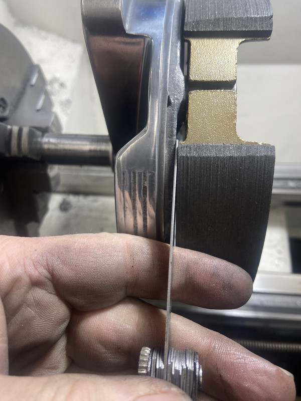

I arced the relined brake shoes on my lathe after shimming the cam arm so the shoes are perpendicular to the brake plate. I welded up a simple tool from scrap metal I had to keep the shoes from rocking while spinning in the lathe. Two 6mm set screws snug up to the shoes and hold them from moving while the tool is trimming the lining. Should be decent stoppers.
A very experienced tech (50 years in the business) at a local brake shop that relined my shoes told me how to properly set the back plate in the lathe, shim the cam arm and secure the shoes to get the best performance out of the brakes.

I finished the front end and then found a pretty cool upgrade for the front brake
Benell / Moto Guzzi used this double sided single leading shoe Grimeca brake on the early 250 cc two stroke twins, I think Ducati used one very similar on the 350 Desmo. Its got functioning vents on both brake plates, the stock Benelli brake 'vents' are fake.
I bought a reproduction exhaust from Detlef Burian in Germany  www.benelliparts.de
Took a little trimming of the header pipe, about 4" too long to fit into the muffler
A new 428 chain fitted

I got this in the mail from the UK yesterday, a Grimeca double sided single leading shoe front brake, I spent an afternoon stripping off a horrible silver paint job smothered in soft clear urethane. Then sanding, still plenty of wet sanding and finishing plus getting the shoes relined.
I think this will be a great upgrade
