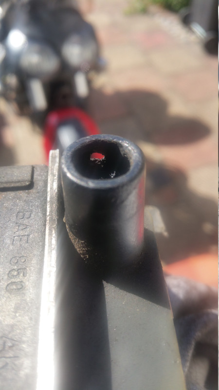

« Reply #24 on: December 07, 2025, 03:03:54 AM »
yep, you never fire a coil without it being attached to a plug that grounded or a grounding wire
May i ask what ignition system are you running?
I see the points housing and dyna (?) coils but no idea what drives them
Whats the history of the problem? meaning, same setup has run good before and then didnt or you are sorting it out now?
what color do the plugs have?

Dyna III. I swapped the existing Dyna III for a brand new one. No difference. It's been an issue since the bike was re-started. plugs had a nice tan color before I started changing main jets. (155,165,175,185, 195, 205,215, and 225) the 225 caused a secondary flat spot and the bike did not like that.

I cant even tell you how much i dislike Dyna ignitions......
Try to aim a timing gun at the flywheel at very high revs, you might discover something, tell us what you saw.
Shouldnt be difficult to go back to points just to verify.
That said, if you are so all over the place with main jets, go to a dyno and find the right one based on best WOT power, you are just confusing yourself like that,
anothe ridea, have you tested that you have enough fuel flow to carbs?
did i already asked for  :gotpics: ?

« Reply #28 on: December 11, 2025, 11:19:00 AM »
When I first bought my Stelvio, it really didn't like running if there was a bit of  dampness in the air.
The spark had preferred to go sideways from the coil...
« Last Edit: December 11, 2025, 01:37:08 PM by theoneandonlymin »
