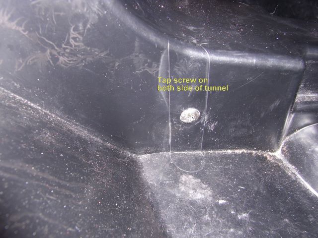

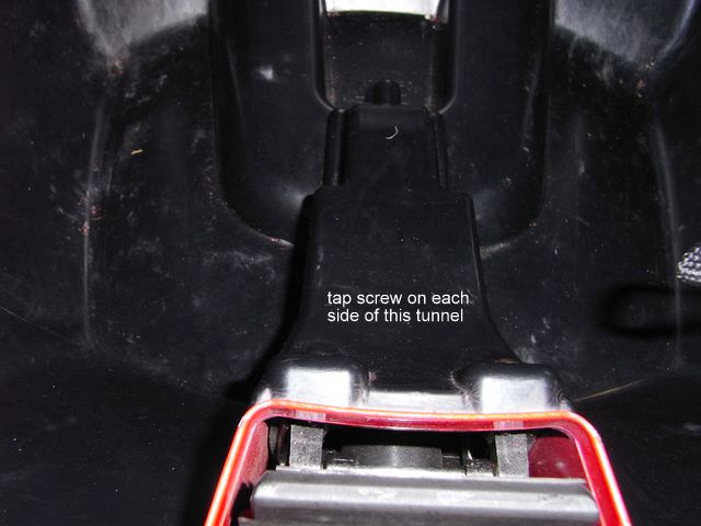

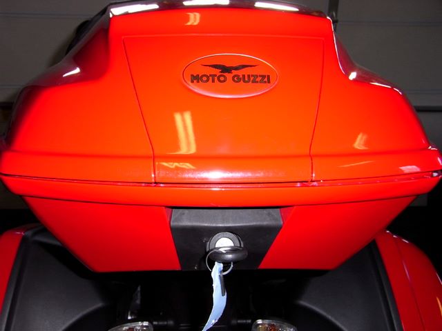

I know it is supposed to be simple, but no luck.  I have pulled, pushed, twisted, etc. and can't get the top case to budge.  I would like to remove it for day to day use.
I took out 2 screws on the tunnel, no joy, I twisted the key, right, left, and center, I pushed in the lock, no luck.
Any suggestions?

Four screws to remove the tunnel. Keep looking.

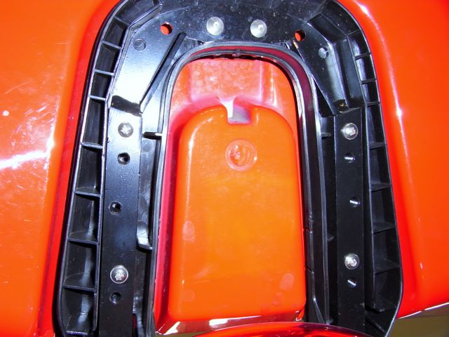

if there are no screws inside the box, turn key to left, push in, it will go in a little, you will be against the spring, now push much harder in to release the latch. if there are screws on the inside of the box remove them first. I just went out and took mine off to verify the procedure and I had forgotten that the spring takes much more force to overcome after the initial push in .

Thanks for all the input.  It was simple once I got the sequence down.  Turn key counter clockwise (left) push it on the button (you might encounter resistance) once it unlatches pick straight up and the case is off.  Not sure why it isn't covered in the owner's manual.  Based on the number of top cases that flew off I will add a couple of retaining screws.  I know the recall was done on this bike, just don't know what modifications that required.
btw...I don't think the 2 screws on the tunnel had to be removed, but I did remove them before I took the top case off.

The recall had to do with the part on the mount where the case clicks into the mount. The old style was made of plastic, which could crack and break off. Not good if your passenger is lean back relaxing at 75 mph when it lets go. The new style has the same piece made of aluminum. It may be stronger but it isn't any better at keeping the case secured to the mount when you hit a series of bumps in the road. The mount begins to flex enough allowing the very small metal tang on the latch plate to pull out of the now made of aluminum piece on the mount. Want to see how little is holding the case to the mount? Flip the case over, look at the latch plate. You'll see the tang which slides into the mount is just a little over a 1/16th of an inch. Truly a stupid design!!!
