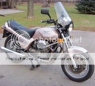

Amazing how long a thread lasts on this site, and still has interesting new posts.  Here is a National Cycle Street Shield EX which I like a lot.  Their link:
http://www.nationalcycle.com/catalog/product/view/id/54/category/5391/
The "EX" is a little larger than the straight "Street Shield."  It doesn't look huge but does get the wind and most bugs over my helmet.  Hands are out in the breeze.
The site does not show this windshield for any Guzzi, as far as I could see but it was mounted when I bought the motor in 2012.  One of the mounting points recently broke out and I found the shield is available without hardware for a significant saving.  I down loaded a Kawasaki (it seems) installation guide since there are none specifically for Guzzi, and the whole assembly seems next door to universal.  The lower mounts are attached to the upper forks with screw hose clamps, and the upper hardware attaches to the handlebars.  Only non-universal thing to watch is to select a style which has clamps the same size as your handlebars!
The National Cycle agent with whom I spoke said the styles which attach to the headlight brackets, (F-15 & F-16 series), are more specific than the ones which mount like the Street Shield models, so it's doable.
