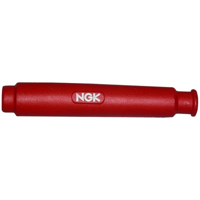

I suppose you could use the CR8EIX iridium plugs with the SD05F caps. Those plugs have the screw-on terminals (or come with removable push-on terminals, at least). Does the SD05F fit under the removable cover or do you have to leave that off?
Oh, the SD05F looks just like the SB05E.  Scroll up and look at the pics.  It will fit just fine. The only difference is that the SD is for screw-on and the SB is for push-on.
These are straight caps and the wires bend over to align them with the plugs.

Stelvio and 8V Spark Plug Caps. Alternative option.
« Reply #61 on: September 25, 2015, 11:16:06 AM »
Decided to do my Caps today, went a slightly different route (pretty normal for me!).
Used NGKs Red all-rubber Caps~
Cut the leads right at the ends to give maximum length.
I pulled the New Caps internals out, hoping to fit the original in the sleeve, but it was too loose.
New cap sticks out a bit as you can see, but the upper 30mm or so is just an empty sleeve, the fitting the lead screws into is far enough down for the top to fold over easily, so it fits under the plastic cover.

Perhaps you could change to different terminals.  I cant see why the terminal design alone would make a difference if the other plug parameters are the same.
The SD05F caps will not fit the terminals of the stock Stelvio NTX sparkplugs.
The sparkplugs have the push-on terminals and the SD05F fits the screw-on terminal plugs.  SB05E fits the push-on terminal plugs but the rubber boot is too big.
To do it right, you get the SB05E so the cap will fit the plug and you get the SD05F for the correct size weather boot to use on the SB05E cap  Got it ?  Complicated but they are not expensive.
NGK doesn't import the proper cap with the proper weather seal which would be the SD05E in NGK nomenclature.
Just to experiment, I bought a pair of SB05E and a pair of SD05F and put them in my fairing pocket, to see how far the originals would go.   Is the weakness of the originals an urban legend or not?
The left side (the hardest one to replace because you have to shift a fairing piece to reroute the wire) went bad at last year's National in New Hampshire, right in the fairground, so we had a bit of tech session to replace it.   33,000 miles.
The right side went bad just as we started a 2500 trip with friends.   Took 5 minutes, 40,500 miles.
That amazes me, since the OEM boots LOOK and FEEL like they're the toughest, heaviest spark plug boots ever made.   Obviously, however, they are not - someone screwed up the design on these, one of the simplest and longest-used functions in automotive history, and it's Japan Incorporated to the rescue ....

I ordered the NGK SB05E and the SD05F (to use the rubber boot off of and place on the SB05E) for my Alaska trip.  Il put them in the bags and hope my originals dont fail but better safe than sorry I guess.......Now to take those running lights apart to check for chafing wires...

NGK Caps arrived today and I cut the old/stock ones out and put the new NGK in.  Hope they dont give me any problems but those Guzzi ones seemed built pretty well????  Well...time (and miles) will tell.  :bike-037:
Offline Dilliw
  • Posts: 3678
Re: Stelvio and 8V Spark Plug Caps. Need NGK SB05E
« Reply #88 on: February 28, 2018, 07:17:41 AM »
If you have the caps don't wait for a fail to put them on. It may not be a good time on the side of the road, it may also be raining.
Yeh I've never understood this thinking.  The NGK combo is a $20 + 1 hour solution that should last for the life of the bike. It's not a wear item like a tire or a battery, and they will affect performance long before they actually fail.
I guess there is some challenge in babying the OEM plugs so that they will last but to me it's just one less thing to worry about.
Fix it and forget it.
George Westbury
Austin, TX
« Reply #89 on: February 28, 2018, 08:44:33 AM »
I carried my new ones, but it was an experiment, like leaving the stock mirrors on.
We KNOW they're going to fail, and people's plug wires and mirrors were failing in 4K to 20K miles, but let's see how far they WILL go.   Maybe I can set some sort of record, or maybe mine WON'T fail.
So I found out - the mirrors failed within 1000 miles of each other, and the spark plug boots failed right on schedule.
The only thing I DIDN'T do that with was the flat tappets, for sort of obvious reasons involving huge piles of money, but until I hear different from another 8-valve owner, I'm claiming precedence with 40,000 miles on the original tappets and changed them out RIGHT before they failed - discolored but had not lost any material yet.    The shop estimated I had another 500 or 1000 miles before bits would be in the bearings ....
Living dangerously!    :wink:
