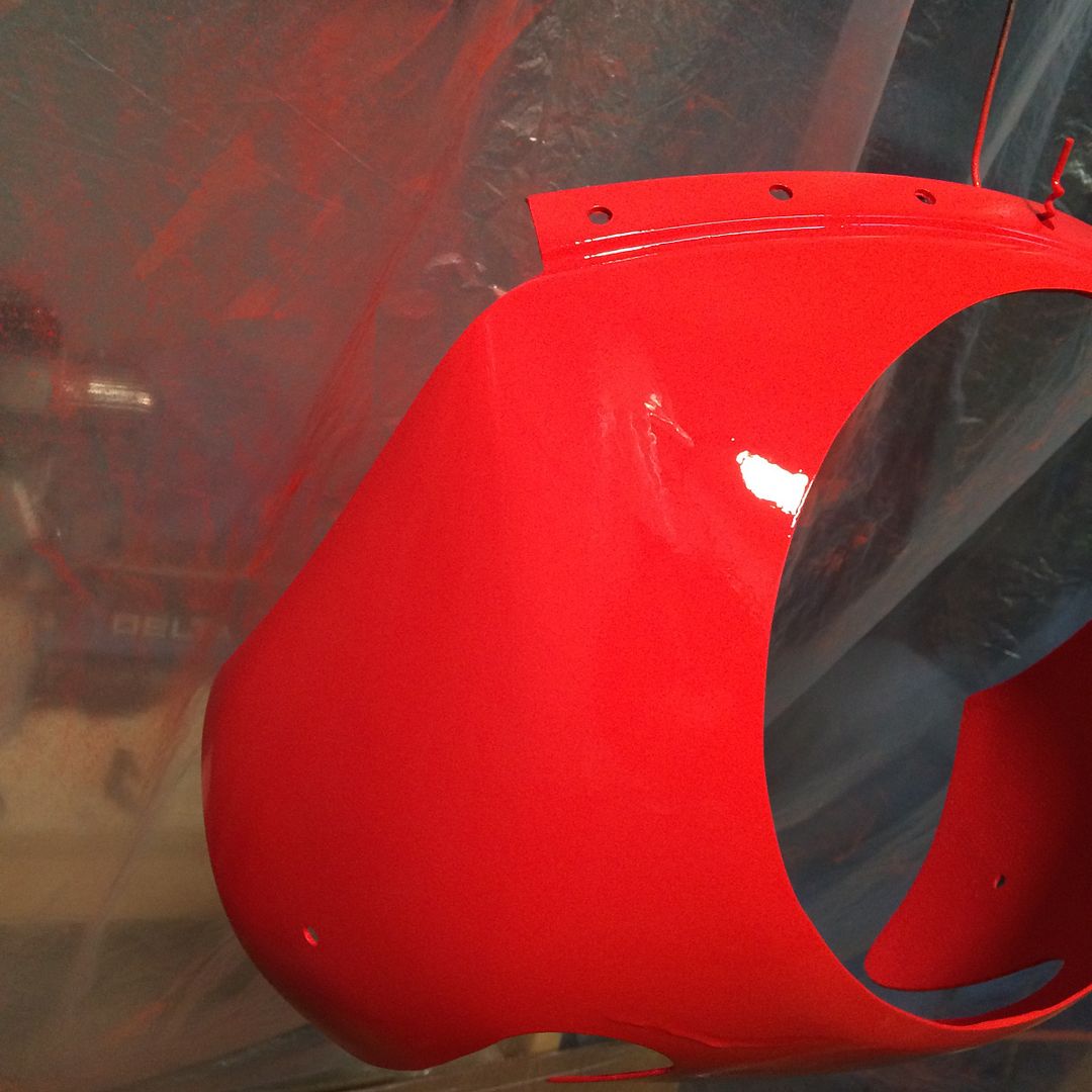

They told me no clear coat with this stuff is all. If I did they said an enamel clear coat. It's the reaction stuff that COULD take place. I don't kno what to believe anymore. I have an enamel clear at home.  Chuck may know options here??  Can I do as Mike suggests?
There is too much science involved in this stuff for these dudes that sell and tell you how to apply it. I think they've been around too many fumes to remember.  :P
Not as far as I know. Look, I'm not a painter, but I can paint. I've had to learn to do it on airplanes. If you do enamel right, you won't need a clear coat. Base coat clear coat is much more forgiving than enamel, fwiw.  What I'm telling you is what my kid taught me. He *is* a painter.. retired, thankfully.
If it were me, I'd wait a week before sanding, and try again. The way I told you is the way I've been taught. Painting is an art, there are *many* pitfalls. I've done most of them.. ;D

Cool, will do Chuck. Appreciate your experience.

I guess I cheat, I have always used acrylic lacquer. ::)
Painted a few cars and odds and sods; always came out reasonably well.  I think you have just put me off ever trying to do enamel!

Alright, sanded off the nasty and re-shot it today. Better, but certainly not perfect. Will put it on the bike as is and run with it for awhile. I layed it on good as I saw the same thing happening as before. Unfortunately I ended up with some saging at the bottom (see photo). Should be low enough for the casual passerby to not notice. I will find out when it's on the bike. Not without a little orangepeel but close to my OEM tanks paint. The bike ain't a gem.

Which one's the fresh paint?
Certainly not as perfectly smooth as that but you have a REAL sprayer and I'm dealing with a Preval job for $7.00 (GC). I will say this, I've got one heck of a shine going. Didn't realize what's possible with this. It's pretty deep. I guess that's the reward.
Yep. Enamel done right is really glossy, and you don't get into the labor of sanding, sanding, polishing,clear coating, etc. It's a tremendous labor saver on something as big as an airplane..

I do a lot of spraying in my "day job" (guitar-building). I can't help you with the Preval system since I have no experience. I have a spray booth and 'real' guns, both conventional and HVLP.
However, I would suggest that whenever possible spray any item as horizontally as possible. That is, lay the item flat rather than hang it vertically. I would have tried to support the fairing from the inside with the headlight hole facing up. I would then place it on a turnstile with good light from more than one source. Very easy to spray (and see) with the object spinning in front of you and stable light sources.
For next time!
I totally agree.  The edges are an issue is all. So many important edges to hit. as well as the backside the first time around.  It's a tough little piece.  Thanks for the advice though and will try to do that if there's a next time around and I decide to try it.  It fits with the old-school job done on the tank.  That's got orange peel also from the factory, though minor.

 I painted my 77 LeMans with enamel and of course had orange peel and some drips, so I wet sanded it with some 1500 then buffed it out, it came out okay but I could never get that great gloss back. One of these days I'll try again.

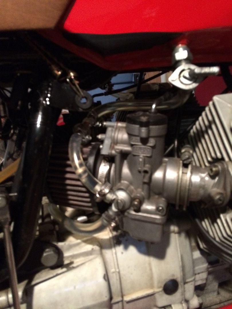

Got rid of the crossover web that started weeping. Went to a double banjo and quality hose (Motion Pro) so I can see what's going on and add simplicity.

Man... Gonna be warm soon!!!  Time to ride that bad bike!  Cool fix with the banjo fitting.

I use clear tubing, you need more hose clamps, they are cheap (guzzi content) ;-T
Yes, it is!  We've had some spikes in temp lately so there have been windows of opportunity, however, between painting, etc. I've had to bow out. But, we have lots of salt still on the roads because we've had NO precipitation in over two weeks since the thaw began. Getting cold again but hopefully we get rain next week. I'll take the sunshine no doubt but we need to get this grime and dust off the roads. Please Mother Nature I can ride now. I'll do another startup later today sans gas leak.
I've got 6 hose clamps on 2 lines. :P. Never had a leak at the banjo. Will watch.
The winner is Father Guzzi. Took my second ride last evening and stutter stutter run stutter stutter run. Looked at the lines and saw lots of air. Air was getting sucked into the system at the banjos/no fuel leaks. They expanded at the fitting over the two week period just enough. Bike ran without hesitation on the first outing just after fitting the new lines. They were snug at that time. Thank you Father.
Fixed

"Sucked in"??? Don't see how in a gravity fed, non-fuel pumped system. Something about this Lario that atypical? ???
