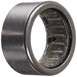

On a slightly unrelated note, but very important, there is a small needle bearing on the outside of the rear drive. The needles are in there loose. There is no inside race. Be careful not to lose them. That bearing is a pricey little bugger. About 80 bucks so I have heard. If it were me, I would get the needles out of there for now, count them and put them in a baggie with a slip of paper bearing the count. On reassembly, grease will hold them in place until you slip the axel back in.
John Henry
I think a few locals have the bearing, just not for a better price.
In regards to the needle bearing, BTDT!  ;D I found the bearing for relatively cheap on Amazon and replaced it early last year or so?
http://www.amazon.com/gp/product/B007EDOI04/ref=oh_details_o00_s00_i00?ie=UTF8&psc=1 $14.09 shipped, vs Guzzi prices... the one I received was made in Germany as well btw.

Thanks guys. I just hope I can get this thing back up and running before the warm weather truly hits... otherwise I'm stealing the Breva!  ;D
Chuck, I do think I can get those bearings cheaper, but to pull the old bearings... I may need your assistance. I've read horror stories on the LeMans board.  :o
Edit: Found the bearing on Amazon, may look at a bearing shop as well just in case...
http://www.amazon.com/dp/B007VG9APC/ref=biss_dp_t_asn $62.00 shipped.
Also, on MG Cycle!
http://www.mgcycle.com/product_info.php?products_id=2838 $55.40, without shipping.
Bearing is an SKF 3303 A-2RS1TN9/MT33
I'd be careful about buying bearings from Amazon - there's a lot of copies out there
That bearing is a is 17mm ID x 47mm OD x 22.2mm thick double row angular contact bearing with 2 rubber seals. (It also has a limiting speed of 11000 RPM  ;D)
http://www.skf.com/uk/products/bearings-units-housings/ball-bearings/angular-contact-ball-bearings/double-row/index.html?prodid=124003303&imperial=false
The rest of the number doesn't do a hell of a lot in this installation. The bearing on your bike is one of their "high performance" Explorer class bearings but I can't see why that would be needed given that the thing doesn't roate more that 20 degres I guess

Thanks tris,
My last bearing order from Amazon seemed to be fine. It said "Made in Germany" on there, and the quality looked good... it went in fine.
I will likely be ordering this bearing from Moto International, as they have it for $28. The best bargain yet.
