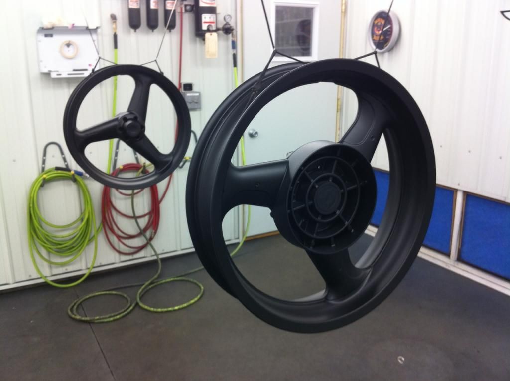

Picking up my wheels from my painter tomorrow. I noticed he painted the inside of the wheels as well. Do I need to sand them down on the inside for a proper seal?
Ken
Ken
2004 V11 Cafe Sport
2009 V7C White
2007 Griso Black-Sold
1978 V50 II Blue-Sold
Online Perazzimx14
  • Posts: 6494
Re: Breva 750 Wheels/Tires On V7C
« Reply #37 on: April 28, 2014, 04:04:31 PM »
Nope just install the new tires.

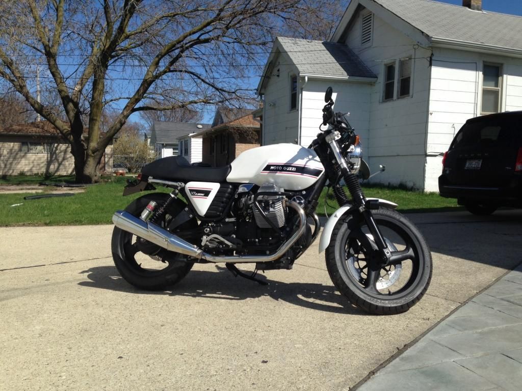

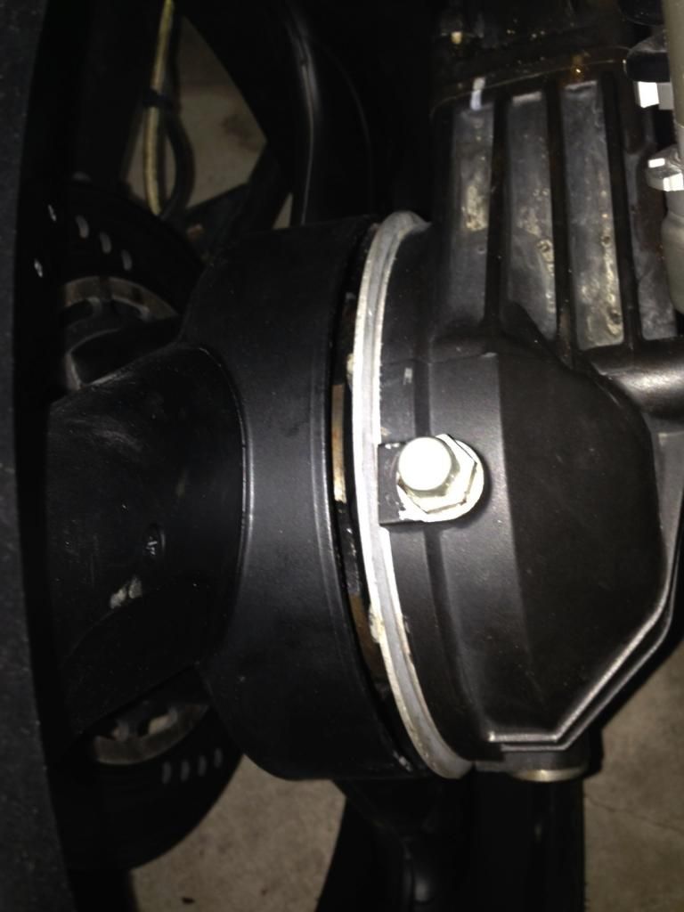

Done with the conversion on my 2009 V7C. The only weird thing that I noticed is that there is a 1/4" gap between the final drive and the wheel hub. I took off the final drive to double check the gap, and it's as close as it gets. The hub on the standard V7 spoked wheel has more of a shroud on it so that there is almost no gap. Anybody think there will be an issue with this? The plus side is that the wheel is much easier to get on now.
Ken
The wheels are not as shiny as I'd hoped, but I should be able to polish them a bit. I also need to find a front fender for a 17" wheel, or find a better spacer for the existing fender.

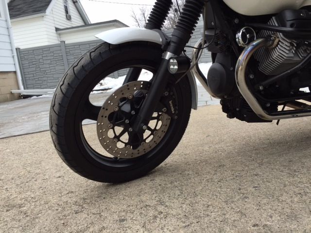

I picked up a new fork brace from Harper's for about $35 http://www.harpermoto.com/parts-by-motorcycle/2000-up-moto-guzzi-motorcycles/v7-classic-750-2008-2012/front-body-front-mudguard-en-v7-classic-750-2008-2012-en.html
I shaved off 5/8" of each mounting post, but there's still a large gap between the wheel and fender (18" fender on 17" wheel), so I think it still looks goofy. You can't put spacers in between the brace and the fender to lower it further as the holes won't line up.
I did find a 17" 4.5"W x19"L alloy fender from a local shop. He will make just about any size. He quoted me $97 shipped, but I think I may be able to save on shipping, as his shop is 2 miles away from where I work. I've heard there's a very long lead time, so if you need one, order soon. They're not polished or painted, so that's on me.
http://www.7metalwest.com/motorcycle_parts.html
Ken
Here's the trimmed down version of the fork brace. Uncut version is on the left side:
Still a large gap between the wheel and fender:

You could do a wrap with some electrical tape to cover the gap on that hub. Or with some other sticky product tape type product. Even some of that stick on Velcro wrap would work. Or just paint the cush drive flat black which would make it less noticeable.
Actually, I fixed the hub issue (forgot to update it). I had the wrong spacer in place. It's a tight fit now.
Ken

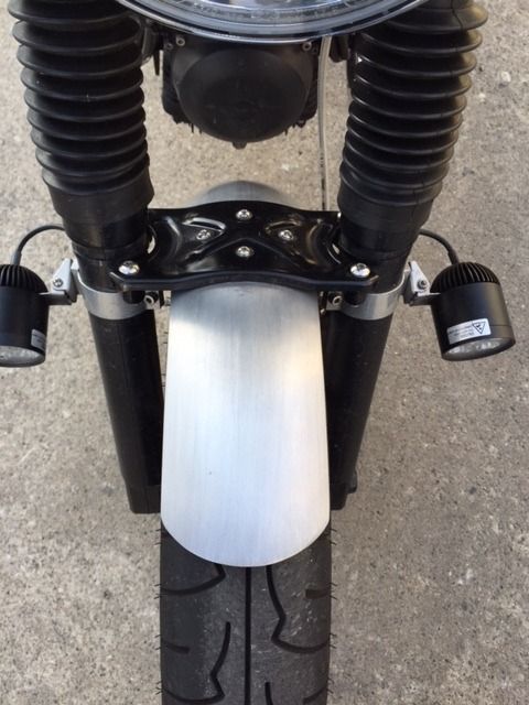

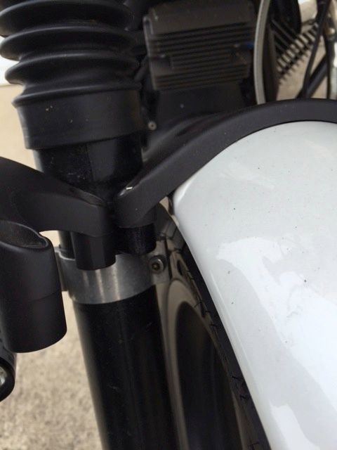

I did remove the gap between the wheel and fender with the help of a Breva 750 fork brace, and an aluminum fender from 7 moto west http://www.7metalwest.com Here it is before painting. Keep in mind that the Breva fork brace needs to be raised appox. 3/8" to clear the wheel, and currently I'm using some large nuts for the spacers. I also used T-nuts on the bottom of the fender, and I'd like to permanently install them (either spot weld or JB weld) so that there's no chance of them falling out.
The cool thing is that these fenders are custom made about a mile from where I work. This hand made fender was under $90 delivered to me. It could be left how it is (or polished with minimal effort), but I'm going to paint it black so that it blends in better. You may also have noticed that I put silver pin striping over the factory red on the fuel tank and side panels.
Ken
fender on bike:
front view:
close up of Breva 750 brace:
