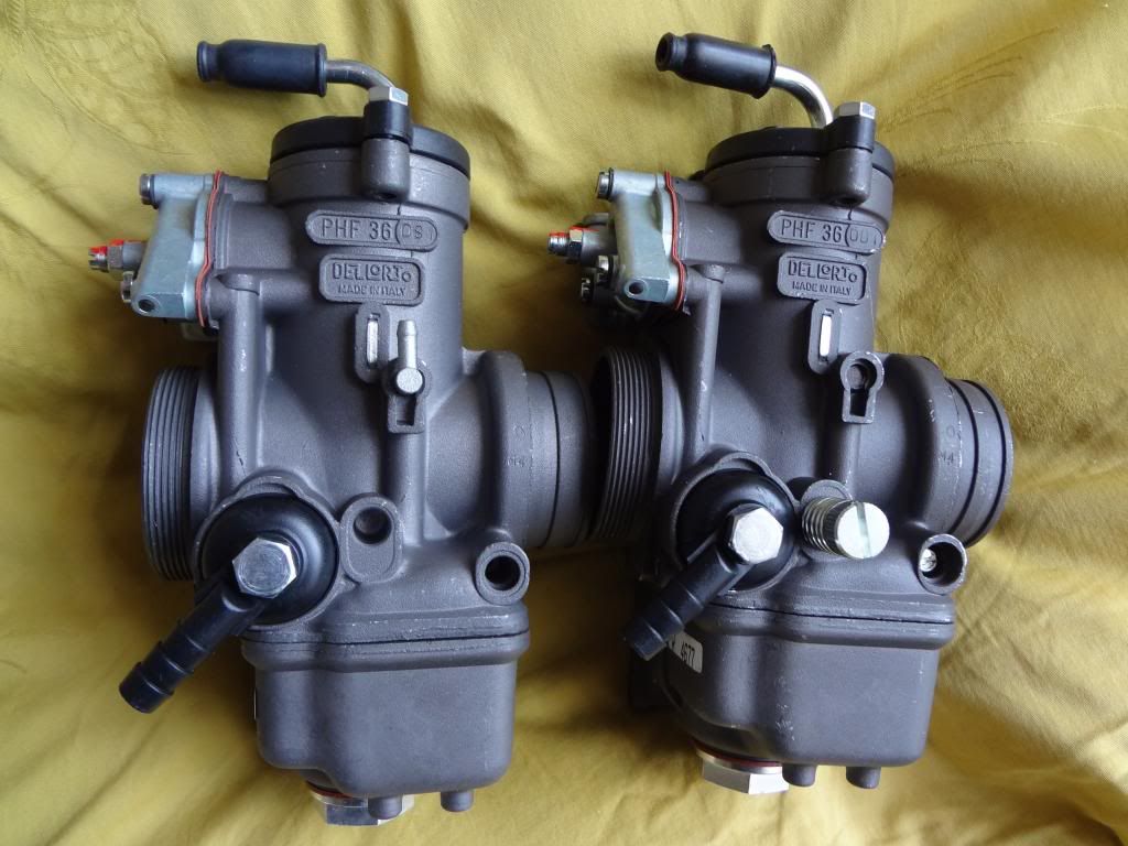

It may never be known,-  but this is getting interesting as to approaching the OPs question I think.
 Jackson,- you do mean that all of the LMIII`s carbs were B types, and not that all of the early (I+!!+!!!) LeMans carbs were,- right ? If so, you are also saying that not all of the LMIIIs came with lean burn carbs ?
I have some Dellorto manuals, but reading them only adds to the confusion,- Manual nr. 19 even states the LMIII `82 came with PHM40 Ds !!
As I`m sure most of you already have figured out, I don`t come here in any "expert capacity",- and I`m happy to be corrected and learn something new in addition to all the other useful and interesting things I`ve learned here.
But I must admit, conceding that not all of the PHF 36 B type carbs came shrouded from the factory, is some sort of a camel to swallow.
And it immediately opens up the next question : what does the B stand for then ? What makes it differ from the D type ?
And is it likely that a significant mod as the shroud would not earn some kind of marking on the carb?  Hmm,-
So I`m thinking that these obviously "unshrouded values" shown for the LMIII may indicate that there were a few early LMIIIs that came with non lean burn carbs ? And that slepnys carbs are, or very well could be, the original ones?
Also, it`s not ver likely that people swop their 36 carbs for another pair of 36s ? Nor that they would change the shrouds ?
Firstly, I am not the font of all knowledge, I only post here to kerb misinformation when I see it
Point 1 Every book or std 850 Le Mans 1,2 or 3 with 36mm Dell Ortos I've seen has PHF36B, if you have book or std bike with PHF36D, I'm amazed but is possible.
Point 2 PHMD 40mm Dellortos were optional from  76  to homologate for production racing, similar to SBK today, manufacturer has to make parts available
Close box falls in same kit, seems unlikely to fit this without carbs and manifolds
What I really don't know is the different market jetting, Rod's 2 bikes suggest Euro did get shrouded but perhaps not all of Europe, books posted & Rumbas comments suggest differences not printing errors IMHO
I can't even remember if UK 3's were all shrouded, at that time I was ripping 36's off and fitting 40's with 90mm bore kits etc
Or if they were all vented with plastic tubes
Interesting the printed specifications for the Italian motor. Different to the English language user manual.
I purchased a LM III new at the factory in 83. It still runs its standard jetting.
I think I've just worked out the contradiction, in early 80's we were selling Italian delivery LM 3's in Australia (via PS and Agostini's)
These bikes were Australian complianced and therefore had Aus spec jetting / shrouds. That's why yours is shrouded
My educated guess
Aus and US complianced 3's had shrouds and vent lines, home market and others not (Rumbas German importer verifies this)
The proof of this would be the brass spigots for vent lines, still guessing but 99% betworthy that if they had vents they were shrouded too
So OP carbs are orig IMHO, why close box fitted without tuning engine to match is a bigger mystery to me
Lastly, difference PHFB to PHFD ?
study drawings
http://guzzisti.de/img/upload/service/Dellorto-Katalog%201977%20(Italienisch).2.pdf
1.33.2.427 is PHF 36B--   Guzzi 850 Le Mans 75-, 850LM3 81-
1.33.4.620 is PHF 36D-- not clear OE application, as said not in my memory or books
Neither show shroud or brass spigots, swallow that camel !
1.34.4.458 is PHM 40D 850 Le Mans K 76- and 850 LM 3 82- (only ever optional AFAIK, K could stand for that ?)
Perhaps your D comes from PHMD ? These were the PR 40mm carbs, very different animal
But OP, just tune and ride, start with what you have, read plugs, how it runs much more important than history of bits
Cheers
MH

The 83 has small 90 degree elbows coming out the side then bending upwards. They look and feel alloy but they may be very hard plastic. I don't want to do the destruction test. I want to be very clear that they both have the shroud.
You can buy them by the dozen at Dellorto.uk, and they`re not plastic.  http://www.dellorto.co.uk/merchandise/products_details.asp?PartNo=9008&CategoryID=2&PartsectionID=21
My understanding on the PHF B is that the B means flexible mount like the rubber manifolds. A refers to the clamp on type like VHB's on an old roundy. D? I haven't a clue unless it follows the A or B which means it is a RH carb.
Just to document my assertion earlier in this thread about PHF36 Bs and PHF36 Ds sharing the same body casting :
http://www.gutsibits.co.uk/pr/TheShop/index.php?f=e&Shnew=1&Model=7&ModelName=Le%20Mans%201,%20Le%20Mans%202,%20Le%20Mans%203,%20Le%20Mans%201000,%201000S&Cat=FUA&CatName=Fuel%20and%20Carburettors&Sort=TitleDesc&spPage=2#topbar
I guess (but not sure) that the "1" suffix on these D carbs stands for the newer type with the revised slides (redesigned idle adjuster ramp) and bigger float bowl plugs.
Now I see where you get the D from, these are offered as replacement and are not identical to LM  and LM 2 which also used B type (without shrouds).
Difference between B and D is not shrouds
These D also have spigot for vent as do red dot and green dot mk 3 Le Mans B type (shrouded)
Note Op's B type without shrouds will not take these vent lines without chopping off the "ledge"
These are same B type I have here and were on all LM and LM2 AFAIK
I let that one go for a couple of days, see if anyone bothered to translate German
red dot and green dot IS marking on carb, dab of paint
There were at least 3 jetting specs for Mk 3 Le Mans, no misprint.
Guzziology listing only 2 has been read as absolute, forgive him, minor typo

 Just to add to the overwhelming variety of carb specs for the LMIII shown here already, I just found this chart covering all the Tonti and later carbed Guzzis ;
http://www.thepembleton.org.uk/techpages/dellorto/dellorto_specifications.pdf
Interesting how the specs on slides (50/3 versus 60/3) differ in the LMIII specs shown in this thread, and also that the USA LMIII came with PHF36 DD + DS according to this chart, and that they look like lean burn jettings.
So there may even be a shrouded PHF36 D ?
Confusion complete !  ;D
even more complete when you compare that to English version (I have had this in hard copy since 80's)
Almost nothing same, my one has US version as BS and BD
Only proves..........not hing,  but maybe these mystery DD and DS's are somewhere,look in book I posted before
1.33.4.620 is PHF 36D-- not clear OE application, doesn't cross reference and don't have vent tubes
but does have bell cranks inferring they were on some Le Mans somewhere along with any of jetting specs mentioned.
Let confusion reign, jet at will , guess modern is same, no end of different maps, both factory and aftermarket, in 30 years time to try and work out what a particular bike "should" have had may be impossible, updates, recalls and fiddles just memories

Ok, now to the PHF D's. I had a look at the bikes I have stored here and low and behold there is an 89 Cali 3 with PHF 30D's. There is absolutely no tuning, I say again tuning, difference to the B's. The jetting would be identical if the shroud system in identical. The 30D's on the Cali have the standard brass ring around the needle aperture and the jetting is consistent with that, 475cc bore cylinder capacity and 30mm chokes. This is why I never noticed the D except for the (D)amn big nut holding on the float bowl.
Why? I can only guess they wanted a bigger reservoir of fuel around the main jet. Not sure why as I've never had an issue with the B's. Maybe being the lowest point in the bowl it allowed more crap to form before affecting things but there is one real advantage that I can see. The Bs had a 14mm AF nut for the bowl. The Ds have a 21mm AF nut. The standard 22mm ring that comes with the standard tool kit for all the oil fillers also fits the D drain.  ;-T I can't think of one other 14mm AF nut or bolt on a LM III.
I have a friend with a LM IV and that has the 21mm float nut too. I've never bothered to read the side of his carbs but when working on it the nut is a bigun. Clearly the D's came later but the PHM's had the bigger nut earlier. Maybe they just consolidated the design.

It's the 36mm PHF D's you've got to find, OE on some Le Mans (with bell cranks). Not sure why we care but I'm now believing they existed.
I think your correct about nut size consolidation, D's in my book have 14mm nuts same as B's
Probably just 21mm on later models,book shows no vent spigots /shrouds  on early D.

I think I've gotten to a point that I don't care at all but I'll throw in these last pieces of information/theory.
The D's clearly came out after the B's. Even Kidnebs photo shows that later anodised look, they aren't listed in the early Dellorto tuning Guide as the Bs are  and D comes after B in the alphabet.  :BEER:
If you want to find PHF 36Ds then I'd be looking for the Guzzi mid valve models that came after the Lemans 850 series to find them. They came with PHF 36s.  Late Cali III's, last series 1000S's (not imported to Oz I've read) and maybe some of the Stradas and Milles. Not sure but maybe Cali 1100 carb. I'd bet Dusty's last dollar thats where they will be.

just to clarify
36 D's are in my early Dell Orto book, with bell crank, pre anodised era, no vents or shrouds , 14mm nut
pic from Kidneb with anodised D is current Gutsibits stock, sold as replacement / add on, not as OE .
"My" mystery D's are not these but the ones in my book, with bell cranks, possibly OE on some LM's (see Kidneb's ref)
My book Nov 1985, lists PHF A-N but not F or L
Just to confirm date,  Laverda triples 1980- have PHF D's according to same book, so they're in right time frame .
Sorry Dusty, Rod would've lost your last dollar, is a bit my fault as link I found & posted was 77 book which did only go to PHFB but by 1980 the D had sprung to life.
Here's the early D type, date of print on bottom of page, spot the difference to B type anyone

It is these below that are a mystery to me , really odd part is book shows 4 different sets of Laverda 3 with bell cranks and no straight pull version, I didn't write book and have seen many straight pull. Why different market should get different cables completely beyond me, book in latin Italian.
Back to the mystery 36D with bell cranks, not a later model ,from 1985 or earlier, must be a real train spotter somewhere who knows

I`ve been searching the web without finding any documentation for the existence of the early PHF36 D`s myself.
just to clarify
Right-
I mainly posted the pic of the newer type, anodized, 21mm float nut D`s to show that they also are rubber mounted like the B type.
Thing is I`ve been monitoring the German eBay for years, and have seen the early type D`s auctioned several times in connection with roundhead LeMans` being chopped up for sale.
And in my usual simple-mindedness and primitive need of jumping to quick conclusions, I believed that (at least many of) the round fin LMs came with the D ,- non shrouded type PHF36`s, and that the LMIII came with shrouded B`s . But I can assure you that I have adopted a more broad and tolerant attitude toward the B versus D issue after following this thread !  ;D
I`ve (reluctantly! :)) given up the idea that all the B`s came shrouded from the factory,- and I`ve learned to accept that also roundfin LM`s came fitted with B type PHF`s  !
But I am not yet ready to fully give up the idea that at least some of the round fin LM`s came with the PHF36 D `s,- which also Martins Dellorto catalogue pic could indicate. Thank you for posting that !
   So,- as to the difference(s) of the early (14mm float nut) non shrouded B and D type, we still don`t have an answer!
But apart from that,- I fully agree to Vascos last post,- except I`m being ignorant of the doggy thing,- never had one myself ! :P
