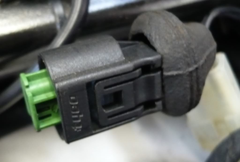

The Tom tom connector is usually located just behind the alternator, around where the heated grips are plugged in.  It is a green connector, and is often cable tied under the frame components, so can be a little hard to find.
Here's a pix of the connector.

The Tom Tom connector is hot all the time, so it is not what you are looking
No it is not.
I located the connector on my Norge and replaced the end with an SAE polarized plug. I ran my GPS off that. Same with the Stelvio I have.
The connector is under the front of the tank. You will probably need to take the tank loose and move it back to get to it in the first place. I cut off just enough to be able to solder the original connector to an SAE end if I ever wanted, and as I said, soldered a connector onto the wire on the bike.

Sorry for the misinformation. I messed with mine several years ago and my recollection was that it was wired to the battery. Looking at the wiring diagram, it's wired to the alternator so as Zoom Zoom said that's what you want. And it's there so you may as well test it out.

The connector is under the tank and stick forward just a bit near the steering stem.
You do not need to take anything apart, no tools needed.
The power wire is there, no need to start splicing wires and all that.
Walter, put a power adapter up front, stick a flush mount USB thingy into that and you have power. When you stop and remove the GPS, it is no different that what is under the seat. Otherwise you can out a switch there, what I did.
I use the GPS power wire for the TPS.
A nice long pair of forceps will make it easier to pill the GPS wire to where you can get at it. The connector is for the TomTom GPS so for anything else just tap into that leaving the OEM connector in place.
