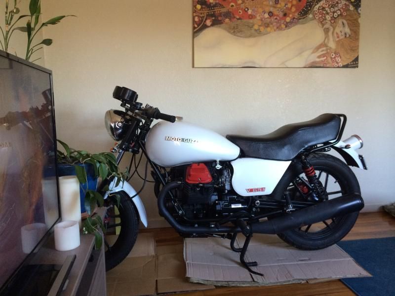

So I chocked up the truck ramp on my front steps...  terrified my 100lb girlfriend with instructions (she was on 'squeeze the front brake' duty) and pushed the sucker up on the deck and into the living room  ;D
Bachelor pad

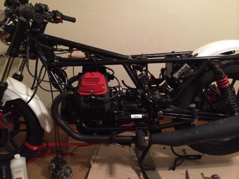

Here's the initial mock-up  ;-T

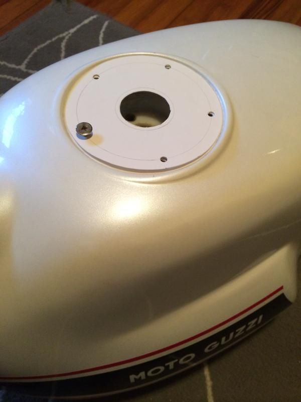

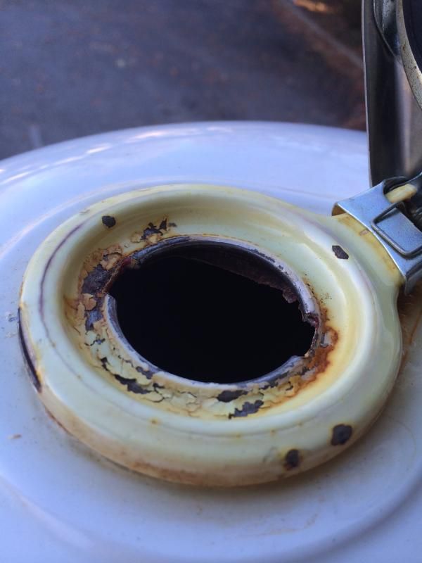

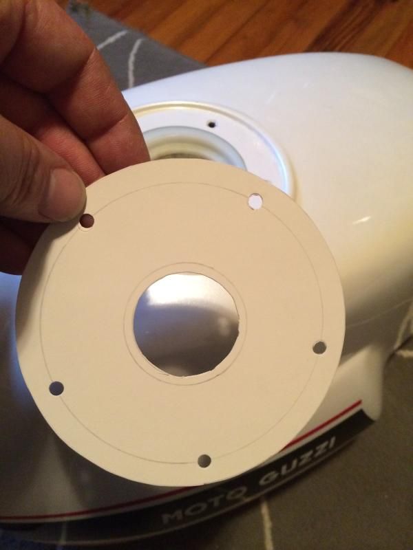

I got a used V7 tank and to my surprise.. It's fits pretty dang good!
The tank lacks all the fixtures, so first order of business is to get a gas cap on it and a block-off plate for the fuel pump hole
Yep! it's gonna work!

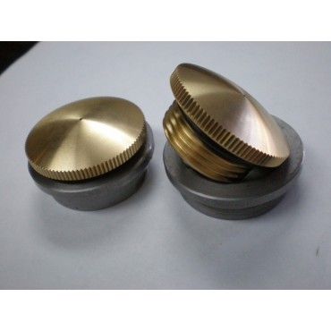

That hole will be filled with this cap  ;D
This is beyond my fabrication abilities, but now that I have my little template, I will be trying to figure out how to get my ring made!
In the meantime, if you have a nylon-tank V7 and have the fuel pump out.. would love a tracing of the base plate!  ;-T

did you know the airbox is a real SOB to get outta there? Yeah that may have been mentioned a time or two!
I actually ordered all the parts & tore the bike down this far before I peeked in the carbs to confirm my diagnosis!
Luckily i think I guessed right  :o
I know nothing about carbs.. just what I "learned" in intro to automotive tech in 9th grade...
I am going to use this write-up to tear down and rebuild the carbs: http://www.thisoldtractor.com/moto_guzzi_loopframe_carburetor_rebuild_-__vhb.html
I know it's not exactly the same carb but this has got to be better than going in blind! Also, I can't find anything this in-depth on the PHBH carb but if anyone knows of something like this for the SB carbs, please post up a link!
I'm going to do the carbs start to finish, one at the time.. that way I can use one as the model while I rebuild the other.
I have no idea what jets in here, but GuzziSteve told me the apropos jetting for pods on a v65.. I guess we'll see what we need once I disassemble!

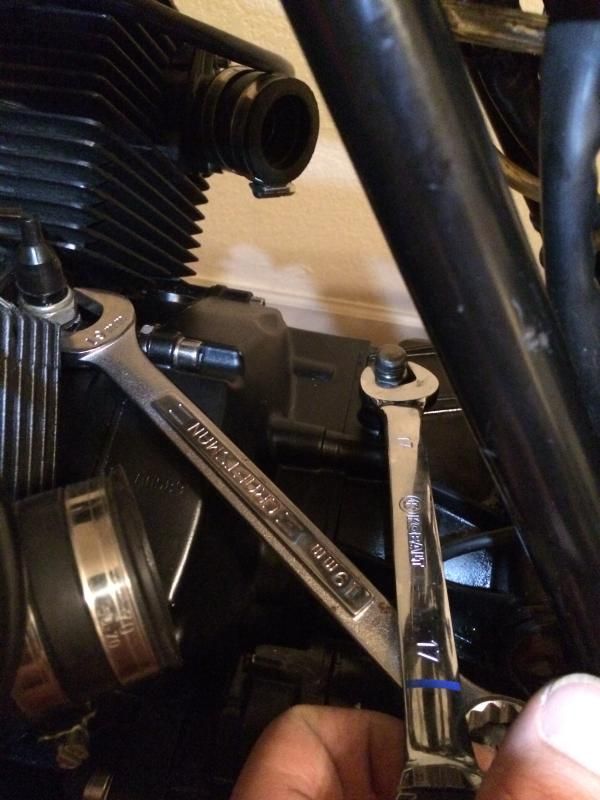

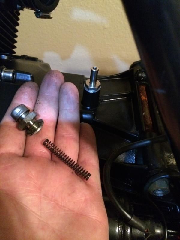

The Transmission breather & oil pressure sending unit are straight bolt in & out
I was warned not to turn the rear wheel while doing the sending unit.. The tip does something important!
As for the tyranny breather.. Why was this spring under the mushroom plug? Should it be installed under the barb fitting?

You need the spring under your vent, the plunger is still in the trans. It is your detent for the trans shifter drum. W/O it it don't click & stay.
Need a shop manual?   http://www.guzzitek.org/gb/ma_us_uk/V35V50V65Atelier_041983%28GB%29.pdf
How is fuel coming out of the tank?
« Last Edit: November 29, 2014, 07:37:42 AM by guzzisteve »

Chad, one good turn deserves another.  ;D I made a fuel pump block off plate for Rosie when I lined her tank.
http://wildguzzi.com/forum/index.php?topic=62087.0
*If it is the same*.. look in parts manuals and make sure it is the same part number.. I'll make one for you out of aluminum. Let me dig through my "good junk" pile and see if I have some. You'll also need that big hunker gasket to seal it.
I'll also make that filler neck part, but your cardboard template isn't good enough. I'll need a real one to get the geometry.
More than you probably want to know in the Lario rehab thread. A search will find it. I made a gizmo for nothing for the transmission vent, but IIRC, a big block vent will interchange.

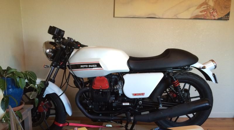

Nice! I like the look a lot better, and always wanted an inside bike for the winter. It just goes to show what a few years of ethanol in the gas will do to your carb. Have fun.

if the gas cap and flange that mounts on tank are the same as an EV (looks like it) I will give you the whole set up complete with key/ it looks the same but someone with both bikes could confirm it? might be a lot easier than making a plate.

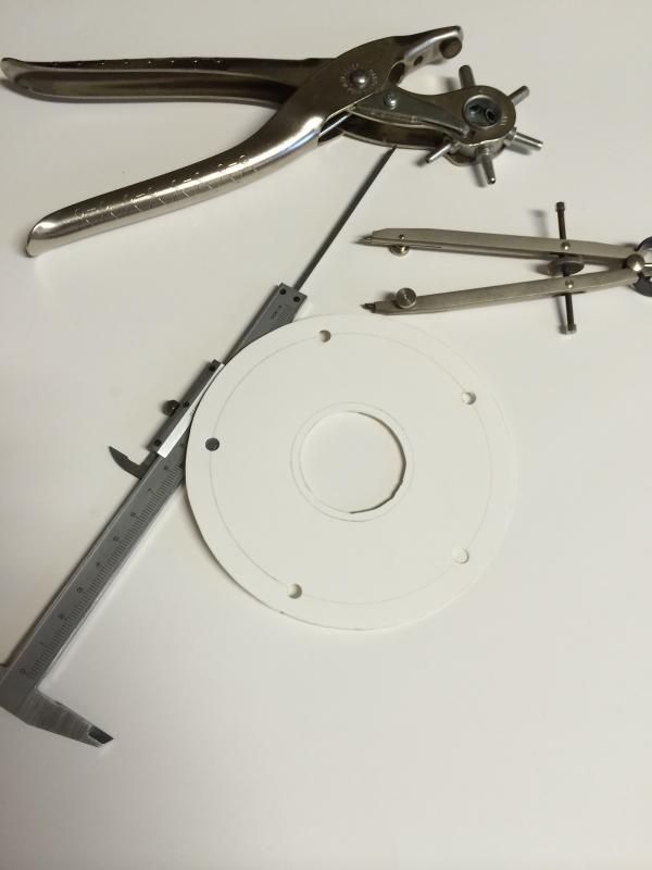

To Chuck & Fotoguzzi...
The gas cap ring
OD 120mm
ID (for the cap I have in mind) 1.5"
Thickness ~2mm
The bolts holes are m5 and 60mm ctc
The PCD of the bolt holes is 102.06 mm

You might want to put the transmission breather and its spring back together the way it was designed.

The shift detent spring is back in under the barb.. I put it in originally just took the pic cause I wasn't sure *exactly* what it was for.

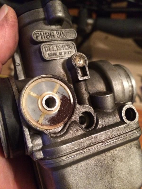

Oh yeah obligatory pic.. Here's why my carbs are full of junk!

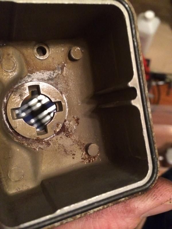

I got one of my carbs disassembled, soaked and clean..
I did commit two boo-boos, hopefully you guys can tell me not all is lost
Boo-Boo #1
I must have missed a couple of the paper gaskets on tear-down (there are a few more in the PHBH than in the loop carb on this old tractor)..  Once I got the carb soaking they came out.
I did not get fresh gaskets & o-rings, as these carbs were totally rebuilt under 1000k mi ago. and were not gunky, just clogged with rust.
I took the pinesol-soaked gaskets, rinsed them, and placed them between paper towels under a heavy toolbox to press them dry.
Do you think this has compromised the gaskets?  I am going to put it back together but I don't forsee testing them with gas for months.
Boo-Boo #2
I prob should have not soaked the carbs in pinesol; as I said they weren't gunky, just clogged.
I took it apart and lo-n-behold I ended up letting them soak almost 3 days before I scrubbed rinsed & dried it.
This is what the pinesol did to the slide  :o
So new slide at a minimum, I guess I will go ahead and order a gasket kit :-(

I like what you're doing. Was your bike originally a regular V65 or the cruiser version? V7 tank fits with minor finagling only? How are you going to attach the seat, as it's quite different underneath than the V50 seats, which are presumably not too different from the V65?
I used the Café seat on my V50. Could have made up something complicated but ended up just using hose clamps. Hey, what holds a Guzzi together anyway? A little tricky to get at the tool kit but better security for it, and it's the most comfortable motorcycle seat my butt has ever sat on.
You're right about the airbox. PITA and gets in the way of everything. Pods on the V50, still have the stock box on the Monza as it works perfectly and if it ain't broke… but getting to anything is a major hassle and I have small hands. At some point it will get tossed.
Keep up the good work!

Did you take the complete carb fully assembled and submerge it for three days?  Not sure how caustic that stuff is but by the looks it did a number on things. I'd rebuild the plastic/rubber/gasket bits by the looks of that metal. I would have disassembled and did a quick washing/rinsing/blowout with air. Your slide plating looks toasted. I hope your floats are ok as new ones are worthless, but your float jet seats that are rubber-tipped I'd inspect or simply replace.  Anything that's not metal likely was compromised.
Nothing a few dollars can't get back.
Kevin
Kev,
I totally disassembled the carbs
I soaked all the metal bits
Did not soak the o-rings or gaskets (except the two I missed~ which I fished out within a couple hours). I also did not soak the plastic cap over the slide or the float itself!
Slide is most deff roasted.. It feels like concrete texture lol
Luckily Hearndon had a euro slide, gasket kit, & the Malossi filters all in stock!
