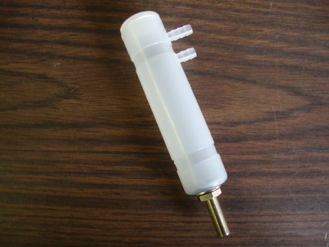

« Reply #3 on: January 15, 2015, 10:38:11 AM »
I use this little setup. It is a small plastic tank that is dented to fit around the frame and held on with Zip ties. Running the head vents to the the two ports and the return out of the gutted valve stem at the bottom back to the engine. The loose fit of the Taiwanese design allows the cap to vent allowing air for oil drain back to engine. It's not rocket science, but I have been using this little unit for several years and have had no one tell me of any ill effects. And it's less than $20.
« Last Edit: January 15, 2015, 10:39:05 AM by Curtis Harper »

I've recently added this baffled catch can to my V7-II as a test (yup, got farkelitis).
Easily obtainable from amazon/ebay & quite good quality.
I simply wanted to see if I could stop the oil mist from collecting in the airbox (not that it was causing me much grief).
Point of note.
On my bike the oil seperator is the top frame tube, with an oil return line to the sump from the bottom of the frame tube, and a line to the airbox from the top of the frame tube.
There is no oil return line to the sump from the airbox.
I changed the line to the airbox to run to the catch can, then added a line out of the catch can to the airbox.
Too new to say if there's any real result, but the bike still runs fine.
Now Pete, you can step in and tell me I'm a blithering idiot, it's unnecessary, and to stop messing with things  :grin:

An update on the catch can.
The DGR was the first decent ride after a shitty wet & cold winter with only the odd days here and there commuting on the bike.
After the ride I found all this crud in the catch can. (I reckon it's just winter build up in the frame that's been burped out).
Naturally I then checked the airbox - spotless!
The next weekend I we had a warm sunny day so I went out for a couple of hours spirited riding.
Here's the catch can after the ride.
No more cleaning crud out of the airbox  :thumb:

I eliminated the air box on a '14 V7 Café. I bought a small catch can on Ebay. Routed the 2 valve cover hoses to the top of the can through a T. The can came with a sight glass that I didn't need. So, it rerouted the lower sight glass fitting down to the oil pan as a return and the upper I put a 2 foot coil of clear hose and zip tied it to the frame under the seat as a breather. Works great, very little traces of oil vapor show up in the coil after a hard run. I'm doing something similar on the current V50 project.

Why making this so complicated? AFAIK you only need to do it like Clancy did. Left #20 goes to catch can and from there another pipe back to the same plug where #20 was before - airbox. Done.
This way you have an extra "filter" for junk and in case that it gets full you still have factory blow-by design after.
Or what? :grin:
Also, does anybody know how much does gearbox actually "breathe" over the breather? If I connect it to catch can together with valve breathers using Y joint can something get wrong? Asking because of this confusion about how much oil should be in it. I already had a oil mess coming from the gearbox breather at high revs...

I have never touched the Breva's breathing system, and when i recently had the air filter out the box was dry. No oil ever in any drain hose. Inside of the rocker boxes completely clear of mayonnaise.
At this stage, if it ain't broke, don't fix it. <shrug>
I know Clancy had some grief once; very simple solution that you have come up with. Bit of mayonnaise showing too I see.

Today I managed to finish mounting catch can on my V7. Actually, Clancy, thanks for idea.
I've put it a little bit more forward and tried to swap these hose "nipples" that came with it with a 90-degree-angled ones. But unfortunately this Chinese item has some different threads, so... no-go. Holder is made from stainless steel, polished to shine and re-screwed with 50 Nm as per service manual.
