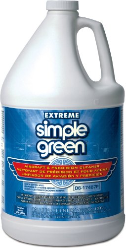

Here is what I most often use on motorcycle parts. It generally strips the grunge and grease without corroding the aluminum or harming the paint.
If you're an Amazon Prime member, here's where to get it:
http://www.amazon.com/Simple-Green-13406-Aircraft-Precision/dp/B001VXU7OE/ref=sr_1_8?ie=UTF8&qid=1423584008&sr=8-8&keywords=simple+green#customerReviews
