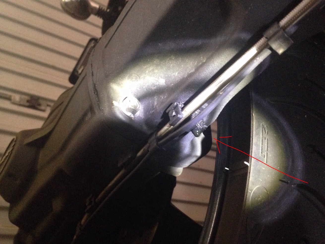

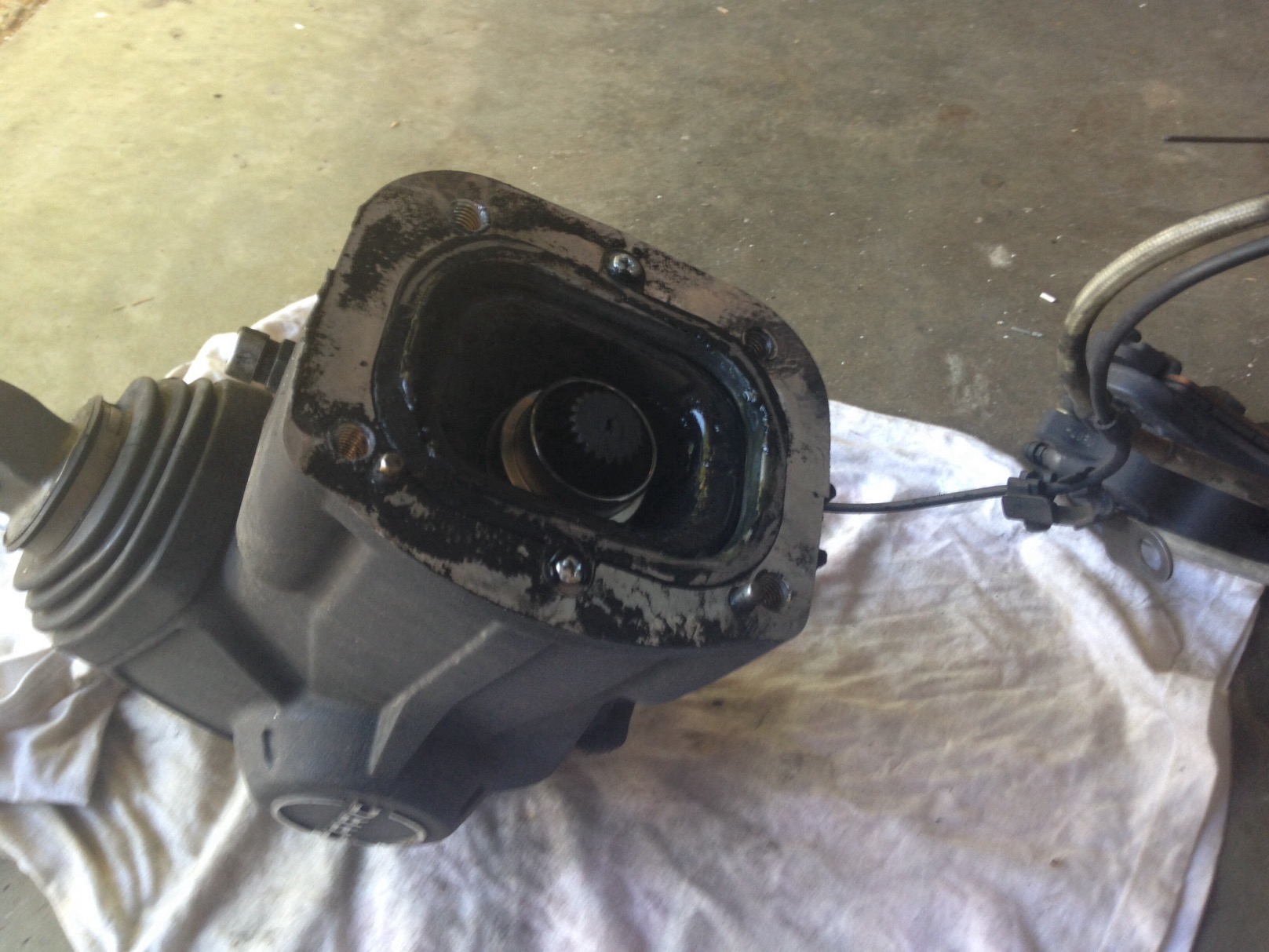

Service shop has a call into MG regarding the leak.
I might have not been clear as to where the leak is but here are some pics. It isn't the hub or large bearing seal. I did a check for bearing looseness and everything is tight, not shimmy or movement using the technique mentioned by Pete.
I am wondering if it isn't that seal but the hole that holds the cable stay. Maybe it was drilled close to through and then finally opened up. I wiped the CARC clean and went for a short stint, simply can't tell exactly if it is the seal or cable stay hole. So now I'll wrap a rag around both so that the wind doesn't splash the oil around and maybe that way I can be sure.
Last thing I need is the shop replacing the seal and finding out it was the cable stay hole that was drilled through.

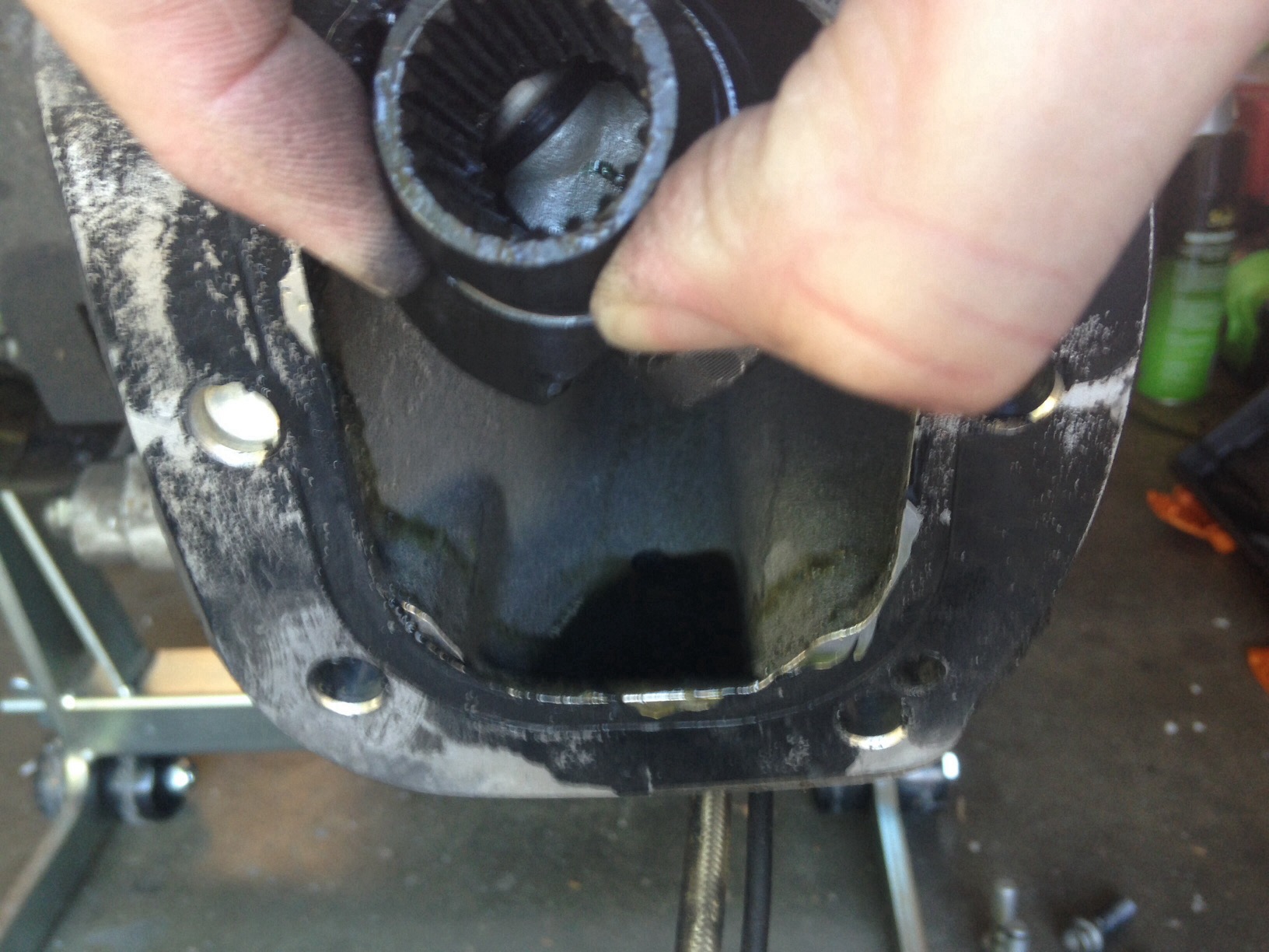

Re: PS warning - Norge CARC rear seal model year 2013 - Updated with Pics
« Reply #15 on: April 17, 2015, 04:24:10 PM »
The bevel box on my Griso sprung a leak from the front boot and was leaking out through the cable clip holes.
The drillings for the clips go all the way through, so any oil in the void in the swingarm usually drips out through them.
I pulled the bevel box off and sure enough, the seal was wet with oil.
There was a pool of it just inside the swingarm. The length of the swingarm was dry, so no oil from the gearbox end.

Dunno yet, I haven't got round to replacing it. I lent Mark one of my spares and his is on the bench, oozing, and awaiting my loathsome attentions! ;D
Yes, that is the classic symptom of leakage into the swingarm from the bevelbox. Being a 2013 it will of had its Bevelbox 'Glued' to the Swingarm with silastic, (You can see this crap on the mating surface of Mark's box.) which was used post about 2009 to seal the rather inadequately sealing front boot. If the seal has one it requires stripping of the box including separating of the two halves of the casing. It's not a big job but it is tiresome and requires a press and a special socket to undo the seal holder. I think I did a tutorial on it a while back?
If it's still under warranty? No issue. If you are going to do it yourself I could probably do another tutorial this week and fix Mark's at the same time. One positive to come out of it is while you're replacing the seal you can put some Loctite on the pinion peg nut to help dissuade it from coming loose!
« Reply #18 on: April 17, 2015, 05:26:56 PM »
Bike is still under warranty for quite a while so I'll let the dealer fix it. I'll mentioned the loctite, the shop isn't so uptight about hints like that. I grease the skids there so it shouldn't be a problem.
I appreciate the new info though because it seemed like it was the bevel box the swing arm seal. I'd had never thought they would through drill a hole for a cable stay, who knows, maybe it was a way to see if things were leaking inside.
Vasco DG
« Reply #19 on: April 17, 2015, 05:35:52 PM »
Ding, Ding! We have a winner! It's a nice EWS. If you didn't see the drip you could loose sufficient oil from the bevelbox to end up damaging the gears and bearings.

This bit is the seal holder, it's locked in place with a big 'G' clip.
The seal lives inside it. You remove the front boot first and then use the special tool and a big breaker bar to undo the seal holder.
Once it's out of the way you can see the preload nut and it's Lockwasher.
I use the same tool on it as I do on th crank peg nut on the oldies.

Got the Norge in today and it was fixed pronto. It was the outer ring seal and it was replaced (warranty). After about 100 miles, no drips or even a hint of a leak.
