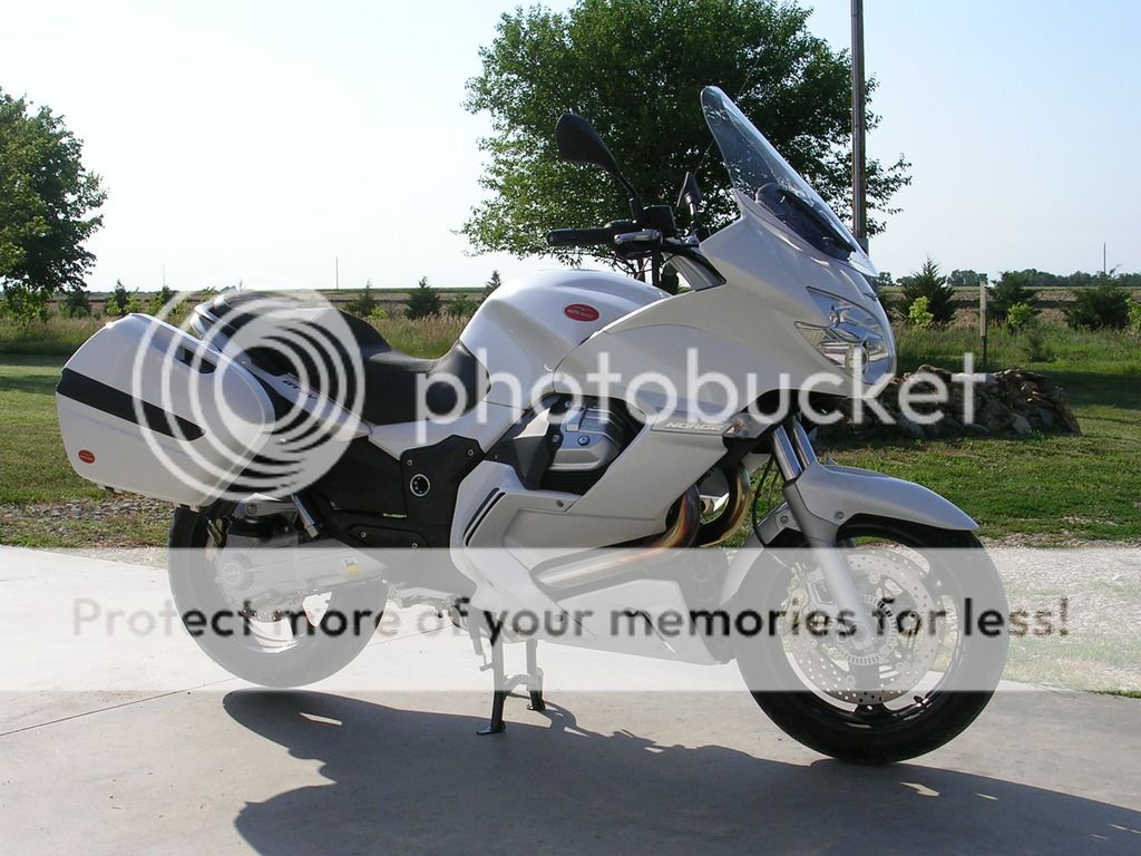

Yes, the white is beautiful and this photo does not do justice to the paint.
