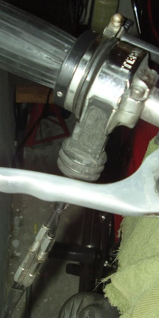

« Reply #1 on: March 20, 2015, 01:33:21 PM »
John, any chance of posting a picture of you throttle?  On all my bikes, and as you can see I have a variety, it's straight forward.  So happy to help but I just can't visualize your throttle from the description provided.  :BEER:

It sounds like you've got the OEM Tommaselli Daytona 2C (?) throttle, the same as on my T3. If so, that pin (a very thin spring steel wire clip) retains the rubber boot. No harm in removing it.
To replace the cables you need to remove the two  screws holding the chrome housing together and lift it away from the throttle spool (that is, the grip) that the cables attach to. Then you can see how to unhook the old ones and put your new ones in.

On the 2c that spring clip also holds the twisty end of the throttle cable sheath in place.  It's harder to keep the carbs synched if the clip isn't there, and it's hard to find a replacement when you lose it.  I'd recommend keeping it safe.

If you have the plastic throttle, the wire thing flips up, rotating to drop the plastic cable retainer. You can then look up to see the barrel holders that are on the twistgrip as to slide them out.

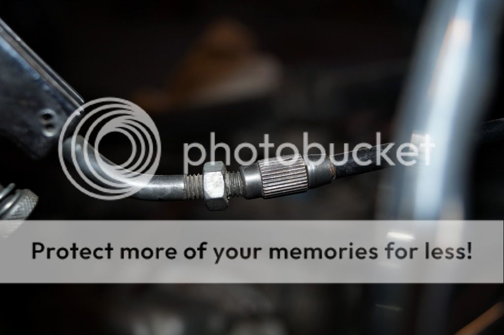

Mine did not have a wire or even holes as seen in this fuzzy picture:

guzziownr, thanks for your help but your set up looks different. My set up has two separate cables. The picture here is of the second cable that I have not yet undone. The metal housing pictured with the adjusting nut is where I am stuck on how to proceed. The only way I can see to get the cable through there is by sliding the new cable out of it's rubber sheath and threading the small carb end through that housing and then back through the sheath. Am I on the right thought track?
East Mountains, NM
Re: Help needed replacing throttle cables
« Reply #10 on: March 29, 2015, 05:22:15 PM »
Something isn't right there.  I don't think there are two holes in the cable end retainer area on a 2c.  The cables should be retained by a spring clip that simply snaps into the holes in the throttle housing and then in a groove in the cable end.  If there is a pin holding the cable in place instead of the spring clip (that detail is conveniently out of focus) it's because someone lost the clip and made do with a roll pin or nail or something like that.  The pin needs to come out.
Also -- Are you just replacing the stranded cable inside the sheath, or are you replacing the entire assembly?  It reads like you're trying to get the cable through the sheath.  If that's the case you're also going to need to solder a new barrel on the cable end/set up the free length, etc.  Unless you do this all the time it's a PITA and difficult to get right -- wrong solder or technique will make a bad/brittle/loose joint that fails with use.  I'd go with the total replacement assembly for convenience and safety.
« Reply #12 on: March 29, 2015, 06:46:11 PM »
 ;-T  That's the good way to go when you can.
So is there some sort of roll pin/keeper in that extra hole (in your pic) holding the cable in?
