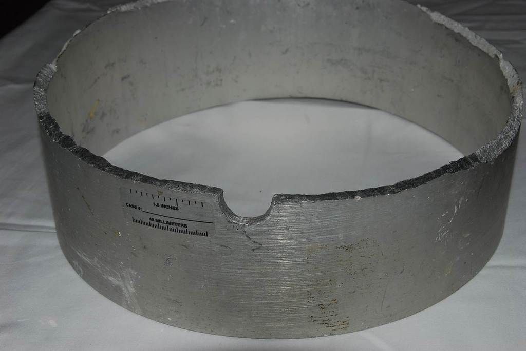

I deal with LOTS of failed metal in my job. Although it's the marine business, metal failure is metal failure. The fracture surface on either side of the hole is roughly perpendicular to the surface. At the same time, the finish of the break near the hole is slightly darker than the fracture surface across the rest of the failure. If you look closely, i'm sure you'll see that the normally "woody" texture of the fracture will appear somewhat burnished. The tips of the asperities will be rounded over slightly. This is from the crack opening and closing over an extended period of time. the darker color is aluminum oxide ground in the surface.
The fracture progressing from this area will tilt back and forth to form sharp, 45 degree edges. This characteristic is termed a "shear lip" and is typical of final, or fast failure. Quite literally, the shear lips were formed as the swing arm tore apart.
Thin wall failure in castings and extrusions can be more difficult to diagnose than failure in a thicker section. Fatigue in thin wall sections may not show the "beach marks" that are so typical of progressive failure.  The following picture is of an unstayed mast where some genius decided to drill a hole for wiring right below the mast partners:
You should be able to see the same characteristics I mentioned showing the transition from progressive failure to final failure.
As for a "bad run", I don't know about that. It's very easy for people to point the finger by claiming latent defect- but defects typically are a physical thing that can be seen. (the exception might be heat treatment, where sectioning the part and looking under high magnification is necessary to look at the grain structure)
Here is a failed aluminum casting with inclusions in the casting. The inclusions (usually dirt) will look like flat planes in the otherwise homogenious casting. The flat planes are actually voids that can act like stress risers. Virtually all castings have inclusions. The problem arises if the inclusions coincide witha highly stressed area of the part.
In this case, there was an inclusion just under the surface. The prior photo shows three more inclusions in a row- so what we have here is a "zipper" of weak spots that caused the part to fatigue. You can see the beach marks in the part pretty clearly.
The following failure is a crankshaft in a small Volvo diesel. The crank is massive for the low horsepower. Nevertheless, there was a fatigue failure that occurred over 17 years before the poor thing gave up the ghost.
If you look here, you can see a series of little bubbles- entrapped gas- in the casting that coincided with the very fillet of the journal. This, certainly, is a "defect".

I don't see what can be done, as Jonathan/ Boat Detective has so excellently illustrated sometimes things happen with castings in certain applications.
Ever seen a motorcycle swingarm  made of tubing break like that ?

Aaron-   just to make itt clear- I do NOT think this is a defect issue in this case. I agree that the hole is the stress risr that initiated the fracture.  I cannot see enough to tell if there was something with this hole to make it more likely to start the crack. I would thing that a raised boss in the casting would've been the wise move to provide reinforcement, though.  Given the non critical placement of the hole, I think that a blob of weld material in the area, filed flush, redrilled and tapped, would beef tthe area up considerably. The heat from the weld will not affect the casting. In fact, the weld can bee relatively "cold"- a quickie pass with a mig welder would be fine. The point would be merely to add material in way of the hole. I guess I'd also chamfer the hole and make sure the tapped hole is not too "snug".

Could this type of failure happen if the hole wasn't there? In other words, they all cracked there but does that mean it had to be the fault of the hole or could those swingarms have had some weakness in that area and that is where the stress was the most so it would have cracked there anyway?
No, it most probably won't fail if there's no hole there.
The stress at the edge of a hole has a higher value than the remote stress in the same component. Fatigue cracks usually (mostly) initiate at the sites of stress concentrations. Once a crack has formed, the stress concentration plays no part anymore, it was merely the starting point of the crack. This assumes geometry effects only, and disregards material effects (inclusions, voids, surface roughness, surface hardness, etc). For a simple circular (not elliptical) hole the stress can be three times higher at the edge of the hole if the stress is purely tension, i.e., Kt=3, where  Kt is the stress concentration factor. For torsion, Kt = 4. Source: Yukitaka Murakami, Metal Fatigue, Elsevier. The swing-arm sees both tension (and perhaps compression in some cases) and torsion (due to the offset load from the wheel).
A stress concentration is fine in most cases for something that is loaded statically, since the material will strain strengthen (if it's a ductile material, but not if it's a brittle material). If a material is loaded variably, i.e., not statically, you MUST consider the effects of stress-concentrations, as this may very well lead a to crack forming. Once the crack has formed, it will grow over time due to the variable/repeated/fluctuating/alternating load. The Stelvio will experience a higher cycle of fluctuating loads compared to a Breva, Griso and Norge since it is likely that it will be used on gravel roads with corrugations (in South Africa we refer to these roads as "sinkplaat", which refers to the wave shape of old zink roof sheets) and the fact they're obviously not as smooth as tarred roads.
The following is from Shigley's Mechanical Engineering Design (Auth: Budynas-Nisbett), McGraw-Hill:
A fatigue failure has an appearance similar to a brittle fracture, as the fracture surfaces are flat and perpendicular to the stress axis with the absence of necking. The fracture features of a fatigue failure, however, are quite different from a static brittle fracture arising from three stages of development. Stage I is the initiation of one or more microcracks due to cyclic plastic deformation followed by crystallographic propagation extending from two to five grains about the origin. Stage I cracks are not normally discernible to the naked eye. Stage II progresses from microcracks to macrocracks forming parallel plateau-like fracture surfaces separated by longitudinal ridges. The plateaus are generally smooth and normal to the direction of maximum tensile stress. These surfaces can be wavy dark and light bands referred to as beach marks or clamshell marks. During cyclic loading, these cracked surfaces open and close, rubbing together, and the beach mark appearance depends on the changes in the level or frequency of loading and the corrosive nature of the environment. Stage III occurs during the final stress cycle when the remaining material cannot support the loads, resulting in a sudden, fast fracture. A stage III fracture can be brittle, ductile, or a combination of both. Quite often the beach marks, if they exist, and possible patterns in the stage III fracture called chevron lines, point toward the origins of the initial cracks.
My point is this: Even if the bike's swing-arm experienced a hard knock/load at some point during it's life due to abuse (not me) or accidentally going through a pot-hole, or whatever, it may not have failed, but the hole might've caused a crack to form. Once the crack formed, you're in trouble, since it will most likely keep growing. And, aluminium (aluminum if you're in the US) does not have an endurance limit. Source: Shigley (Budynas-Nisbett). So eventually it will fail. Putting a hole in a stressed area (it's a critically stressed area, actually), without having designed for it, is looking for trouble.
Of course I'm hoping that I am wrong and that it's simply a bad casting and not as a result of poor design. I mean, they've been building bikes for over 90 years, I've never designed a bike  :sad: . But I have designed a fair amount of marine/offshore structures (locally and internationally) and a few winches, and we design for fatigue, even if we don't know the loading. We don't put holes in critically stressed areas, and if we have have to, we specifically design for it.
But I'm sure the engineers at Moto Guzzi did take the effect of the hole into account.
