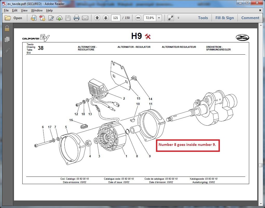

And replace the O-ring seal.  Since you have the timing cover off, you will surely replace the shaft seal in the cover.  But, secretly, there is also an o-ring inside the central bushing that supports the rotor.  The bushing pulls off by hand.  Peer down inside and you will see the o-ring.  You can do all the other work and then it will still puke oil past the old, hard o-ring.  The OD seal is shown on the parts page with the timing chest cover.  The ID o-ring is shown on the page with the alternator.  See here:
Yes, been there, done that!
