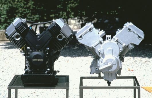

Re: New engine under development for Moto Guzzi
« Reply #42 on: April 06, 2015, 09:49:51 AM »
Couple of pics I had...

We found out the stock exhaust crossover fits perfectly and we can make short header pipes to connect.
« Reply #44 on: May 18, 2015, 11:12:58 PM »
Since I can just barely ignore the front to rear cylinder offset of Guzzis and BMWs due to their dual crank pins - I think the front cam drive on one cylinder and rear cam drive on the other would really bug me.
Is it just a developmental shortcut to commonality from left to right or will that follow through into production?

We are getting closer to having it on the road.
Engine now in final stages of dyno tuning.
We need to install the 3D printed oval throttle body and fuel injection electronics.
We will have 3D printed valve covers with the logo and alternator cover.
(thanks to Nik Levy for the 3D printing design… Nik took a Ducati Panigale oval throttle body we bought on EBay and scaled it down and 3D printed it… custom sized for optimal flow)
Rob Cancilla is doing all the dyno tuning and flow bench work.
Steve Vergano is the chief mechanic and fabricator extraordinaire. Steve fabbed the front engine mount, the exhaust headers and is fabbing custom CF mufflers. Steve had the engine to trans adapter milled from billet.
The radiator is a curved unit off a GSXR.
A compact turbo Steve has sourced will fit neatly above the radiator behind engine mount.
Get ready for a 200 horsepower turbocharged Super Guzzi.
This engine is 34 pounds lighter than stock and shorter.
Liquid cooled DOHC 4 valves per. Engine has been road tested in a Porsche replica car but a motorcycle needs a whole different powerband.
Target date for test ride is February 2016.

We've actually thought about offering it as a kit and/or even doing the install.
Truth be told it was very easy to fit the engine in. It's smaller and 34 pounds lighter. To bolt engine in Steve fabricated new front mounts and had an engine to transmission adapter machined.
Steve fabricated the exhaust pipes. The throttle body and fuel injection system is custom.
Stock alternator mounts to the front which enables stock wiring. Radiator and mounts are required. In normally aspirated configuration the engine dynos at about 135hp which is still a significant increase over stock. Plus the bike becomes so much lighter.
If we had enough interest from people wanting a super Guzzi i think Steve would consider building them in limited production.
This engine is modular and can be made available in a variety of displacements. We are using the 1,000cc cylinders/heads.
This engine can also be made as a SOHC two valve per version for a completely different, more torquey powerband with less horsepower.
Our focus right now is getting this one on the road and working out all the kinks.  We know the donor bike chassis and running gear is good and the engine tests well on the dyno but we need to get the bike on the road and see if it meshes in the whole package.
