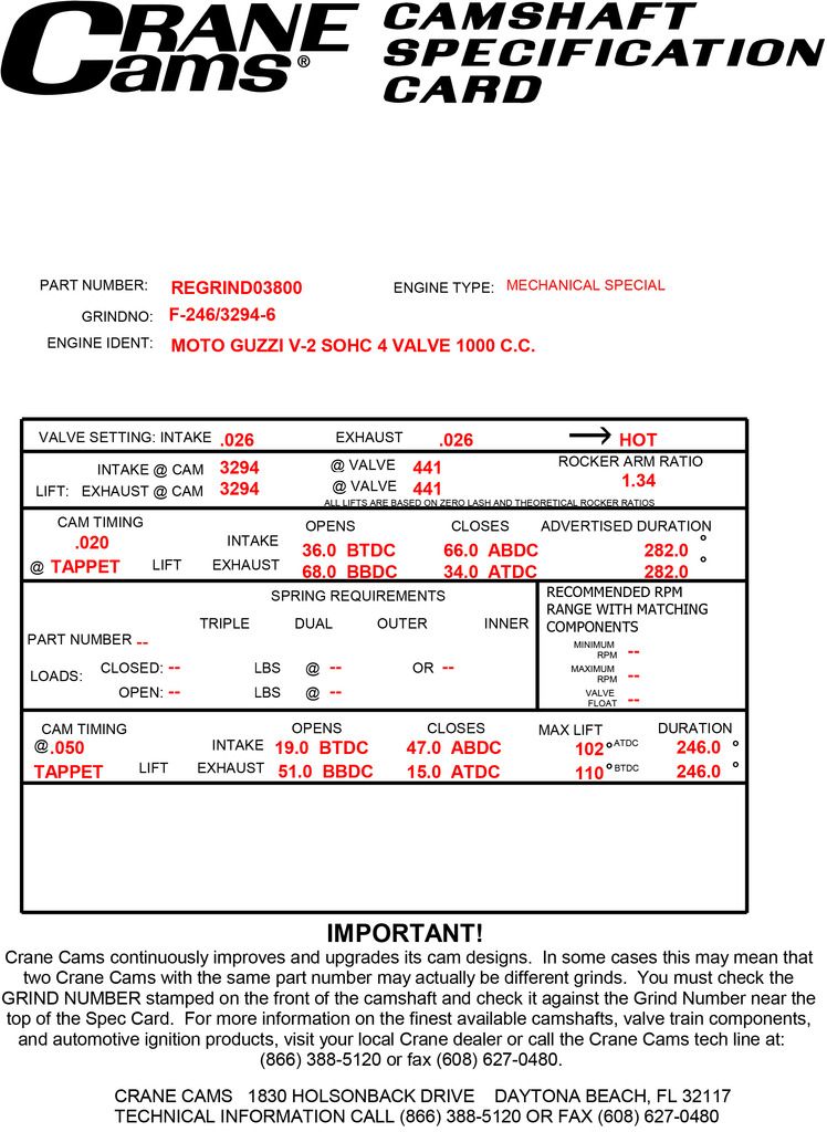

I'm looking for a set of new carbs for my bike, and wanted to ask the experts their opinions.   The bike is far from stock, so any brand I would be open to.  First, engine details: 850 upgraded to 949cc.  Manfred Hect/RaceCo heads ported with oversized valves and dual plugged, 10-1 compression.  Crane cam similar to the megacycle x10
I'm thinking a 38mm carb would be good, unless you think 36mm would suffice.  I previously ran Lectrons and they felt like fuel injection, however they were not gas friendly.  Keihin flat sides look promising.
