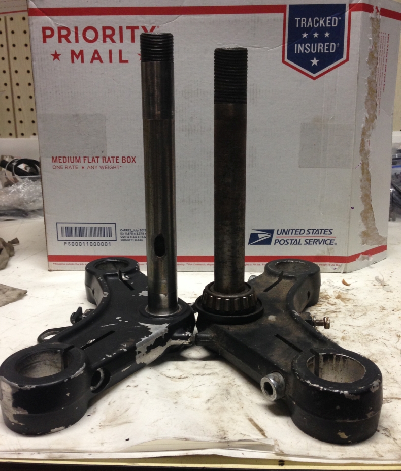

I thought I'd share this comparison in case you run into the same issue and go nuts trying to figure it out. I just learned recently that there are a few different types of triples for the Tonti frame. These two side-by side are both from the later generation models (the left one is from my '81 G5, the right one is from another member but I'm not 100% sure which model it's off of). Note that they will both work, but the locking nuts are the key and they will need to match the type of lower used (long shaft/short threads or short shaft/long threads)
The photo on the left looks like yours, long shaft/short threads (the shaft is about 1/2" longer than the other one on the right), and that one requires the locking nut system shown in the front row on the next image. The shorter one (the one to the right, short shaft/long threads) requires the locking nut system shown in the back row (chrome deep cap).
I hope that helps with the replacement when you are installing it and start to wonder. Hopefully you get lucky with fotoguzzi's one and all with match - and if anyone has one like the one on the left in good shape and is not needed by mach1mustang351, please PM me. I'm still on the hunt for a better one as my stoppers are about the break off.
Edit: I don't need one anymore. I'm making my old one work. Thanks!

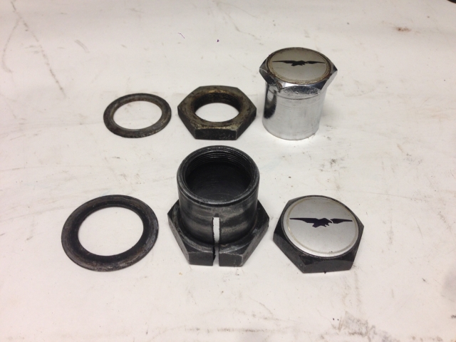

I sent the longer one and included the proper locking nuts.

Groover, The tree I have looks like the one on the left. Send me the length and I will measure it.

So the one I broke has the system with the nut system on the bottom. It sounds like I am getting hardware with mine so I will be good to go. Matteo, you can redirect the stem you have to Groover. As long as I get something that will work I am happy. I dont need or want to hoard a pile of these things  ;-T
Matteo, sent you a PM. The tube length is 8-1/2.

I think those long shaft short thread types must have been made with tighter tollerances. See the photo I posted above and that shows how tight the bearing was upon removal (shiny). I had a really hard time getting mine out too and thought maybe I was just not doing something right or I just didn't eat my wheaties that day.
I made a thread on this just a few weeks ago.
http://wildguzzi.com/forum/index.php?topic=75788.new;topicseen#new
I'm probably going to sand down the shaft before putting the new bearing in. It was way too tight in my opinion, and now I see I'm not the only one with this issue.
