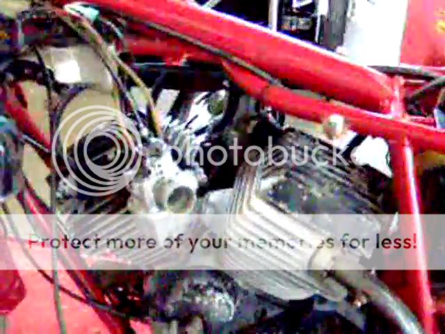

Low quality video of this K2 running for the first time in years.
http://vid100.photobucket.com/albums/m5/Amboman4/Morini%20K2%20runs%20001_zpsc4o078z1.mp4
