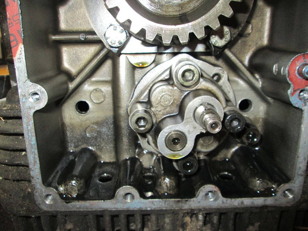

I too want to know how the oil pump was changed/modified to work with gears.  If you take the pump off, would you snap a few pics for us?

I think the V7 Sport used the same pump as the Loops. This is an early 850T with no oil filter. Uses the same pump as the earlier bikes. The pump has the tapered shaft.
Timing chain bikes use dowels to locate the oil pump, you can see the holes in the block. The driven shaft on a gear driven pump extends into bore in the case.

So how is this mod possible?
Machine the case to accept the shaft. The pickup and feed ports are in the same place and the wear marks from the pump gears will give an accurate location.
