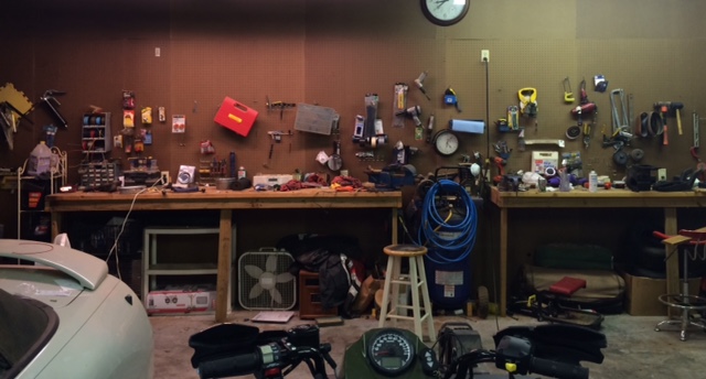

I finished my entire garage (shop) walls with pegboard.  You can even buy it pre-painted in white.  It's 4X8 sheets like sheetrock or OSB.  So much cleaner, and there are pegs of all sorts and sizes that you can literally hang the world on.
May not be feasible in your situation, but I love it.  It looks nice, is multipurpose and I believe it would hold just as much value as sheetrock or OSB.
excuse the mess

That qualifies as a mess  :huh:  :laugh:
Maybe not a mess.  Definitely not the way I like it.  Been crazy around here this year... :wink:

Re: sheet rock or OSB in garage? NGC
« Reply #9 on: June 25, 2015, 08:10:09 PM »
That looks like the neatest shop in the world to me.

« Reply #10 on: June 25, 2015, 08:22:16 PM »
Thanks.  I could spend days in there and it only feels like hours.

« Reply #11 on: June 25, 2015, 08:28:41 PM »
Looks good to me too. :thumb:
