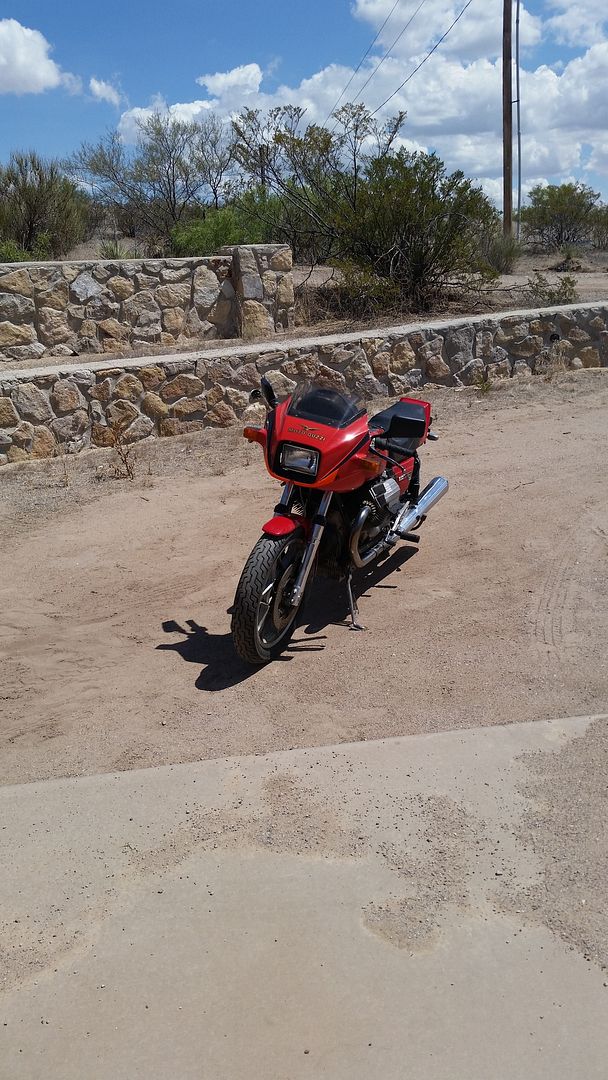

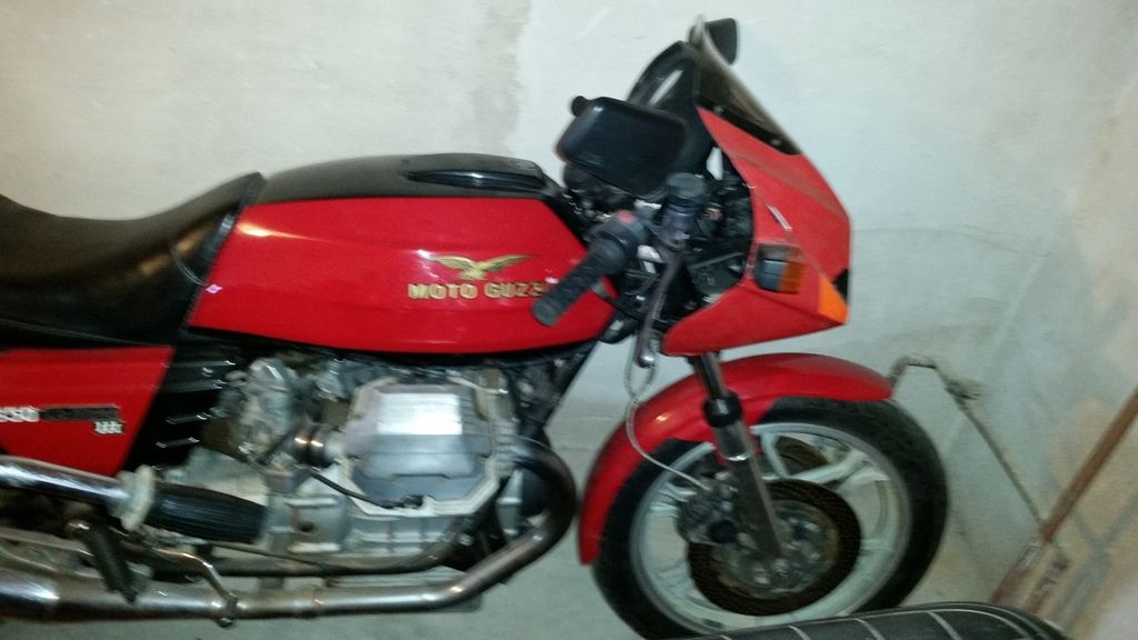

I was offered a Lemans III today by a guy whose wife is making him get rid of some of his bikes (he has about 30).  It's stored in a garage with other bikes right now.
Not running, supposedly just needs a battery.
Title clean.
No history.

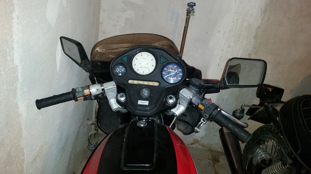

Fairing needs proper mounting and a paint job.
Tarozzi high rise clip-ons.
Rest of bike is pretty clean.
29,000 miles on odometer.
He has $4,400 in it, and would like to get it back out of it.
I think that's high since it doesn't run.
Thoughts?

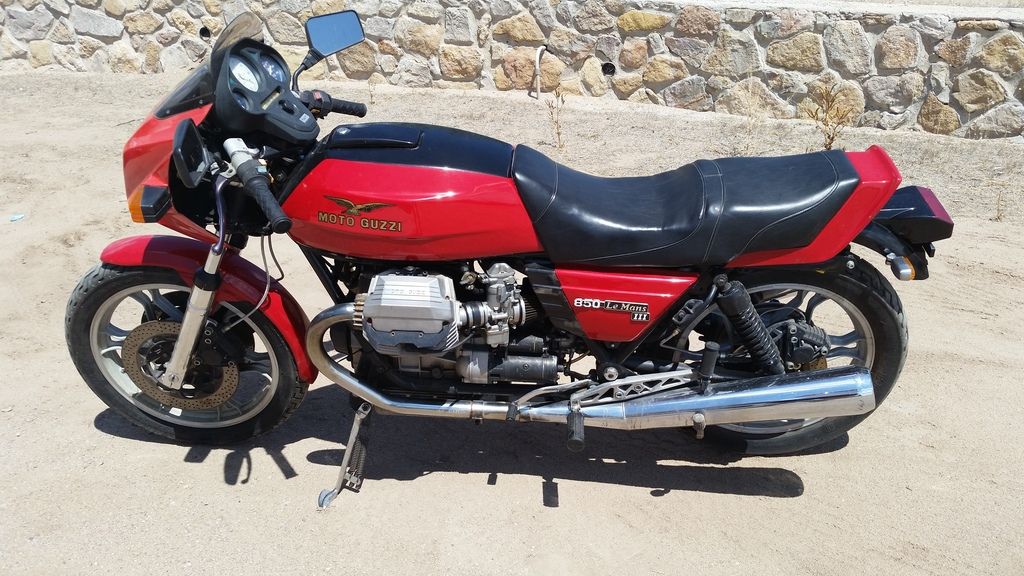

It may well start with some fresh gas and a jump from a good battery.  If the paint and bodywork are good and it fires it's probably worth most of what he wants.  They're good tough bikes.  Asking prices on ebay and craigs list are running $5,500 to $8,500.
I'd pull the plugs, check the oil, give it fresh gas, then crank it 'til there's oil pressure and give it a go.
Looks like the seat is modified.  That and riser clip-ons suggest a shorter rider.  (stock LMIIIs have a long reach).  Rear signals are aftermarket.  Front fairing looks loose and maybe LMIV paint?  Are fork lowers chrome or bare aluminum?  - perhaps the forks have been rebuilt or replaced?  Paint and bodywork and pipes look original from the photos.  Engine looks clean and no oil drips....
Hope this helps.

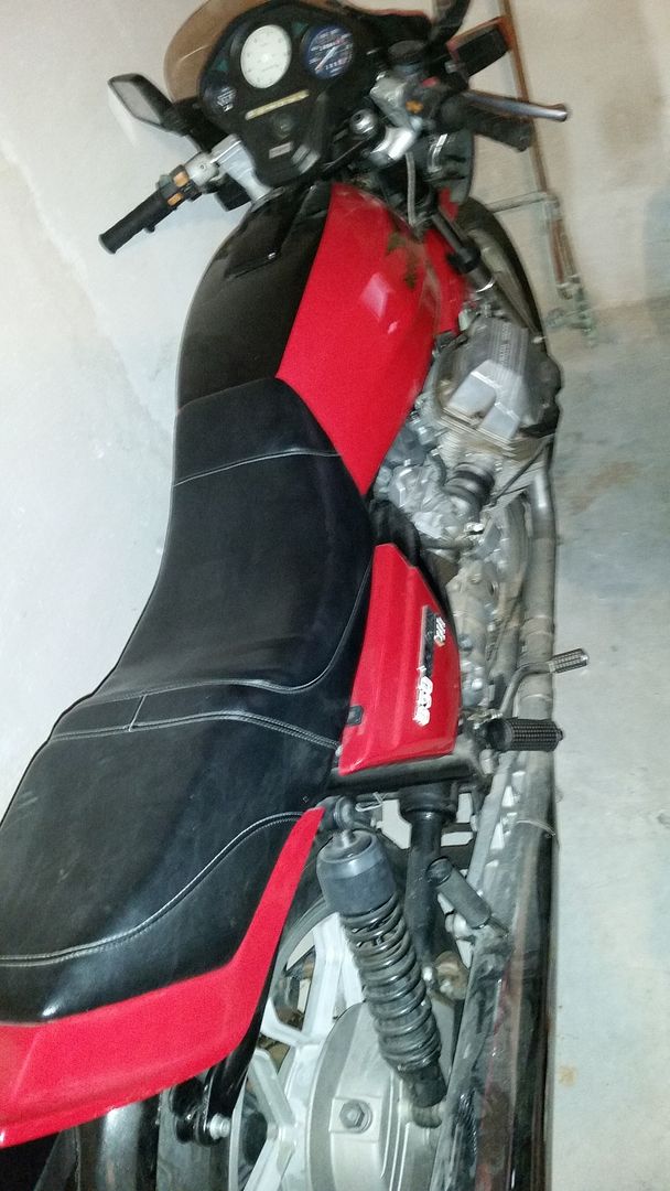

Missing the small bodywork over the engine, fairing is loose or mounts might  be bent from falling over in the garage. Seat, clip ons etc not stock as noted.
Low miles. If it's sat a long time brakes might be junk and carbs full of syrup... plan on lots of seal and gasket leaks/replacement.
If you have a great place to work on it, time and tools, maybe it's a great bike for 4k. If not, it might be a nightmare.
Just an opinion.

based on the pics I'd offer him $3K and leave your phone number with him if he declines.  If it just needs a battery why doesn't he spend $24 on a lawn mower battery?

FWIW my LMIII had about 22,000 when I bought it and it needed several things.
Worst for riding around town was a grabby clutch.  The problem is small clutch splines that wear quickly.  Cured by replacement clutch, but rode it for 5 years first.
Seized cush-drive in the rear wheel.  This compounded the difficulties with the grabby clutch.  Softened the cush by drilling holes in the rubber cushions.  This is a good time to lube the drive shaft spines too.
Bad timing chain tensioner - replaced with Valtech blade type and forget about it.
Sagging fork springs replaced with slightly stiffer versions recommended in Guzziology.
Dampers aren't doing their job after 30 years so it's getting FACs.
Looks like the photos show steel brake lines which suggests some brake work has been done.

Where in the country?  Stored inside but heated garage?  If not expect some work to get it on the road.  Anything liquid would have to be changed out.  Tires?  Factor in what a shop would charge for the same work.  Sounds like at least $1K off of his asking price.  How long has it been sitting?

Is it possible that the bike had front end damage at some point in the past? That would explain the lower fork legs being polished (not painted red like the bike), the unfitted front fairing, the missing lower front side fairings and even the replacement bars. Of course, all of this could be simply the result of a previous owner's changing things for reasons of personal taste, but I'd be looking closely at the front end of the frame, the forks, triple trees, etc.
Other than some concern for hidden front end damage, $4,400 is right at the upper end of what I'd be willing to pay for a non-running pig-in-a-poke. Not that a LM III is a pig, but you get the idea. A well-sorted LM III is a fabulous Guzzi but a bike with unpleasant surprises can get expensive fast. As it sits, you can see all the "good news." Anything you discover after owning it is likely to be in the "bad news" department. The risk is all on your side of the ledger if you pay the asking price.

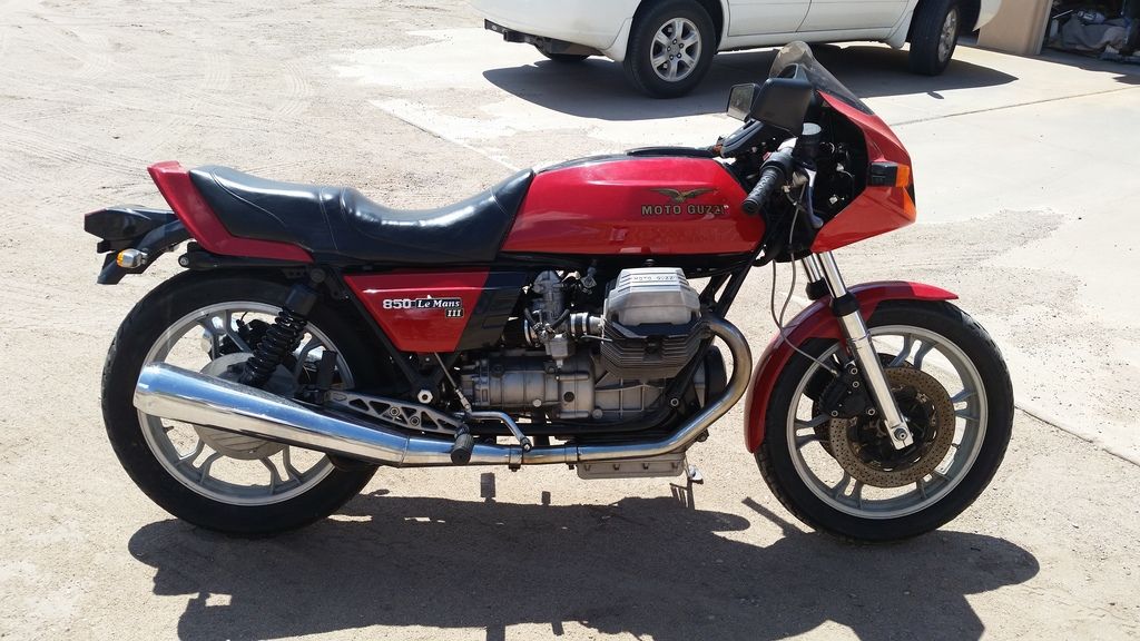

Well,  I bought it for substantially less than the asking price.
The good:  Biturbo front forks, Dynatek ignition, all instrument lights work, good tires, paint is even better than it looked in the garage, fairing only needed one small bolt to finish mounting it.
The bad:  Left side petcock and carb both leak (was expecting to need new gaskets anyway), no headlight or tail light, starter button does nothing.  Shorting across the starter terminals gets a spin, but no engagement.

I noticed it had non-stock fork dampers. the lemans III came with paoli air forks. the III also came with paoli air shocks. I see those have been replaced with what looks like progressives... frankly the stock saddle was junk (even to my 29 year old body when I bought mine). that saddle could only be better...
 still wonder why polishhed and not red painted fork sliders...

That's why it was loose.  A former owner converted it to a round headlight, then sort of switched it back when he sold it.

Bottom-line:  Worth $4K - $4.4K all day long as is. :cool:
Running / sorted: Worth $5.5K-$8.5K all day long. :cool:
Agree with everyone else here (SED, etc.) that mentioned the same as above. :thumb:
