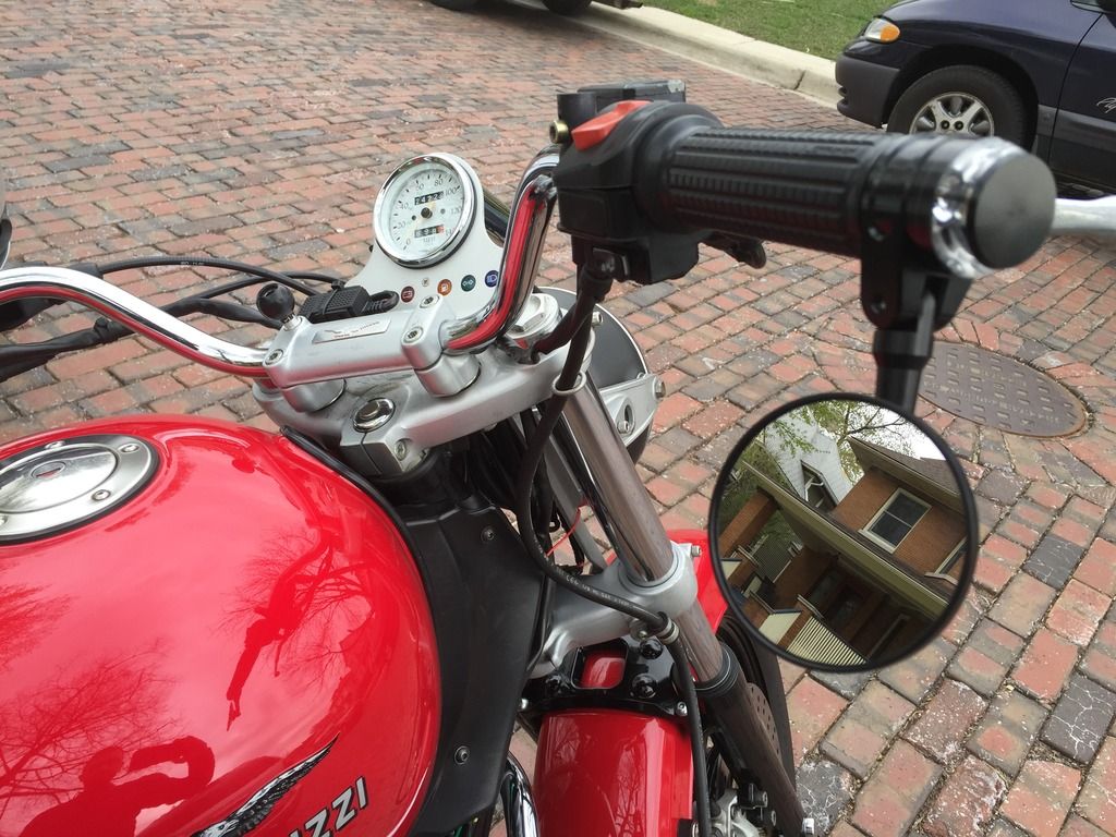

I discovered that the little cap screw to the right of the ignition only holds a small plastic piece that retains some cables.  I pulled it out and it had 6mm threads.  It seemed like a great way to mount a GPS.  Sure enough, Ram Mounts sells a 1" ball mount with an M6 screw.  It is a very clean installation, and you can mount anything with a Ram Mount (which is virtually anything at all) straight on the ball.  I used a zip tie to hold the cables in place, since I had to remove the little plastic piece.  I'm not sure if any other models have this same mounting option, but it certainly is cheap, clean and easy.  Here is a picture.
http://www.smugmug.com/gallery/710745_JRn8bw#!i=4206056401&k=QWnmgx2&lb=1&s=A
« Last Edit: July 15, 2015, 01:01:20 PM by jovato »
Re: Great way to mount GPS on Norge...
« Reply #1 on: July 15, 2015, 01:51:15 PM »
That is what it is for, MG makes a GPS mount for the TomTom GPS. Under the tank near the front you'll find a switched set of wires for power. They are small so fine for carrying the current for a GPS. Do yourself a favor, remove the tank to tap into those wires as there isn't much extra length for crimping. There is also the TomTom specific connector on the end of the wires. If you tap off before the connector you retain it as stock should it become necessary.
I ran new wire (#10 gauge shipboard) from under the seat to the front and made up a 2nd generation of the Gizmo Dash. I put in two weatherproof Marine grade power sockets and and made room for my bike cam. All that is on-off via the lighted switch which can handle 16 amps, more than enough. The switch also operates the driving/fog lamp up front under the fairing.
I'll use the GPS power wire to supply the tire pressure monitor with juice and since it is switched with the ignition, no power drain when t he bike is off.
The dash mount uses no screws or bolts to be held onto the bike. The GPS-Tablet mount is QD for instant on-off.
From the rider position, nothing interferes with seeing any of gauges or LCD panel display.
Funny thing though, I rarely look at the GPS. This was just a hobby thing to do, I check my route before heading out and then at stops I might check again but while riding, it just sits there. It's an 8" tablet and does work nicely and is large enough to see. It do use it to play music via bluetooth to earbuds I wear under the helmet. works as good as ear plugs since it seals out noise really well even with no music playing.
« Reply #2 on: July 15, 2015, 02:02:40 PM »
This is the no bolt baseplate. The 1/4-20 bolts coming up are not attached to the Norge's triple clamp in any way nor is the retaining bracket. The baseplate is held on via 3M VHB solar tape and the retaining clamp is a fail safe of an aluminum bar on the front side also held on that way.
The VHB is a proven fastening system (used it for years to hold solar panels on a tracking system mounted on a motorhome that went through all kinds of weather and over all kinds of roads including rutted dirt, about as good as welding. Getting it off means cutting between the taped pieces with wire but it does come off as if it was never there so bike can return to completely stock.
Instructions on how to make the whole thing is in the archives. You need only a drill and a file plus some materials.

I like a more fixed mount with a lockable cradle...what I did on the Stelvio:
http://stelviontx.blogspot.com/2013/10/revised-cross-bar-for-enduro.html

Placing a GPS as MG designed and as Norge Pilot described will work for many - but not if you use a tank bag. It also will not provide adequate spacing of devices if you use both a GPS and a SPOT satellite tracking device, as they need to be 12-18 inches minimum apart from each other to prevent interference.
Two locations that work well for RAM ball mount points are:
  • Using the hinge screw for the windshield and placing the GPS above the instruments in the center bottom of the windshield
  • Using the RAM mounts that attach above either the brake or clutch reservoirs
I use the second choice, with the GPS at left (just to the right of the left-hand mirror) and my SPOT on the right side,

Yep, that is how I mounted mine when I had a Norge as well. I used a 1/4 20 bolt from the bottom and trapped it with a nut. Once the cover was reinstalled, (with the appropriate hole), the RAM ball was screwed onto the protruding threads. I had located somewhere out on the web that had so many RAM bits, I was able to build what I wanted. Very clean install that way.

Using a RAM mounted onto the brake reservoir screws is in my humble opinion a better place to mount the GPS/radar detector/SPOT devices.  It's much higher and therefore doesn't require looking down or taking your eyes off the road as much as having the GPS mounted below on the plate (besides being a bit hidden behind the tank bag), which leads to safer riding.  A quick slightly downward glance is all that is needed, and in the event you want to input on the fly, or zoom in/out, also the RAM mounted location has the added benefit of having to reach much less further than if mounted on the center plate.  Hard wire it in and you're good to go!
Isn't that in your field of view? I think there is a reason why many state vehicle codes require any device be mounted below or above the driver or riders field of view of the road.
I have my phone/GPS near the left mirror. Below my line of site, but easy to glance at.

Exactly like Wayne says...it's below the field of view just off to the left...well below the top of my Cal Sci Shorty windscreen...by about 5 inches.  I can shoot you a pic, or let me see if I can get it loaded here shortly.

Side view:
Front view:
I like the TomTom Rider a lot...some folks don't but it's works perfectly for me.  Touch screen is fast, glove friendly and route finding is very quick.  Hard-wired in and works great.
On the RHS, I have another RAM mount with the Escort Battery powered (non wired) Radar detector...also could be strap on my SPOT device on top of the detector...
Windshield is the Cal-Sci Tinted Shorty, so you can see the GPS is nicely below and to the left of the screen...
