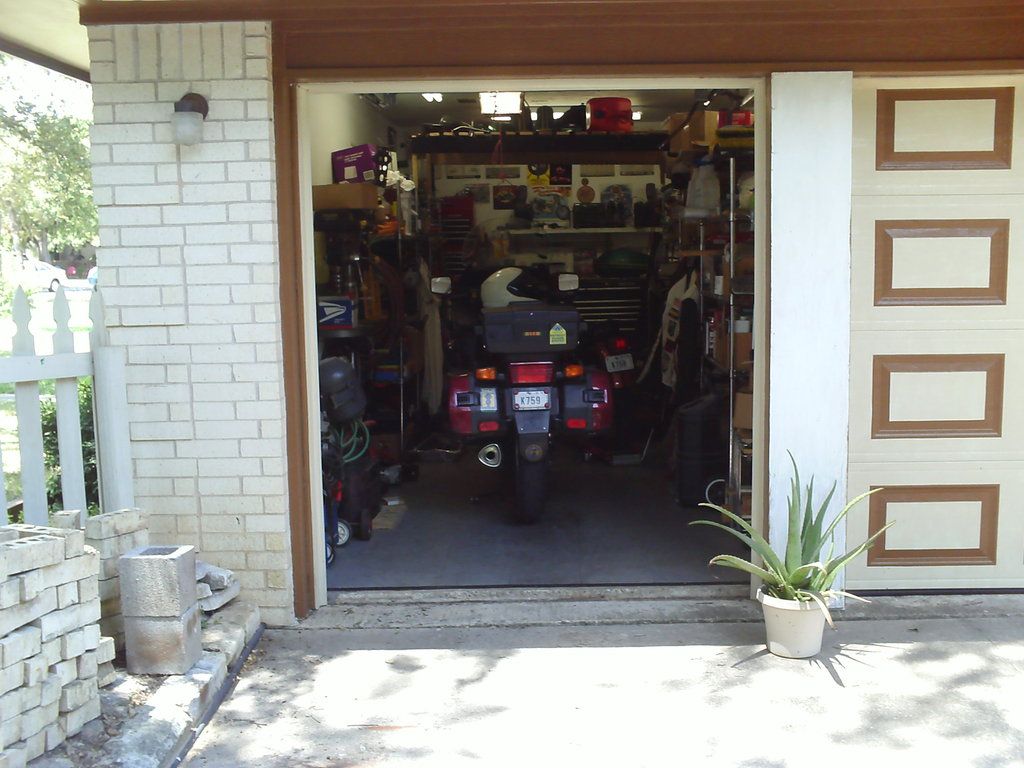

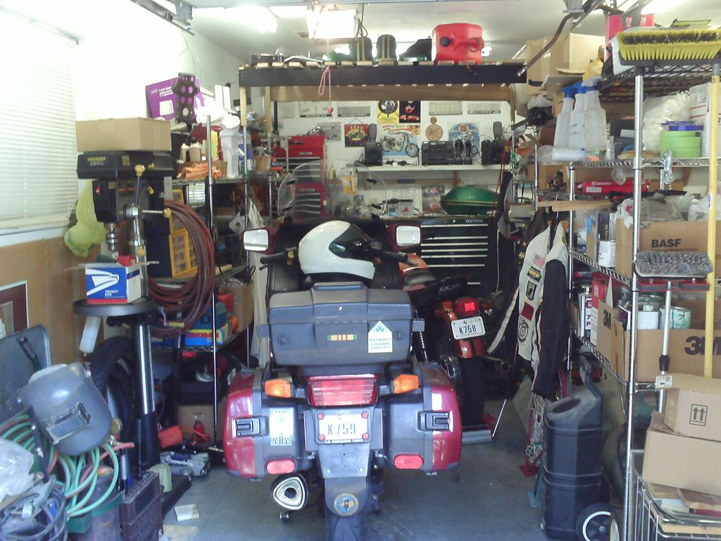

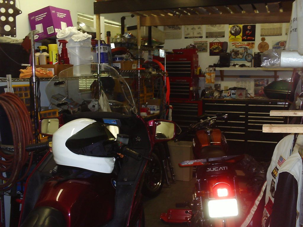

sign2166,
12x24 would do you proud.  Maximize your storage with vertical, adjustable wire racks, a good tool chest can be used as your workbench and I've stretched a wooden shelf across the top of my storage racks for overhead storage.  My shop size is about 8.5 ft x 20 ft with about 6 ft between the racks.  I had a 16 ft. garage door which I replaced with a 6 ft for me and a 9 ft for my wife's car.  Crowded? yeap, but workable.

Nice!
I love seeing small spaces used to their maximum potential, kinda looks like the Russian side of the ISS :grin:
Well, my last name does end in "off".   :rolleyes:
Jbell, I appreciate the "making do w what you have" philosophy. For use of your space, you deserve an award in economy.

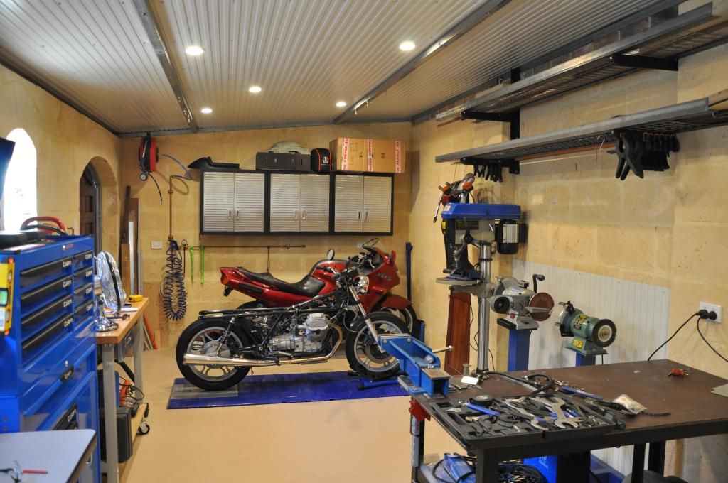

I have 3 bikes and built a 24 x 12 workshop/garage for them with an in-floor bike lift. Build detailed here:
http://www.garagejournal.com/forum/showthread.php?t=237146
Works well but would be nice to have a separate clean area for bike storage away from grinders and such.

Fangit,
I looked at your garage thread and it's an awesome build . Love the doors and other details.
Cam3512 also suggested a recessed bike lift. It's an idea that I'm liking now. What brand of lift did you get and why did you select that make and model?

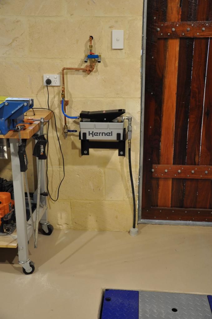

Thanks. I'm in Australia. I ordered this unit:
http://www.aaq.net.au/shop/detail/autolift-243292-motorcycle-lift/
but they ended up supplying this one (wider and with side extensions) for the same price (around $AUS 1400).
http://www.aaq.net.au/shop/detail/autolift-243292ec/
Price has gone up a lot since. I liked these lifts because the lift height is more than most (980mm) so that when it is recessed in the floor the max height is still pretty high. It's made in China but is very solid (unlike some of the Chinese lifts) and has worked flawlessly so far.

Nice shop! I sure agree with you on having a separate room for welding, grinding and polishing, If I were to build a new shop that would be #1 on my list. The recessed lift is a great idea!
Yep, it's priced at $1,900 Aust. now.   It's powered by both a foot pump and an air line?

Nice!!!
I read your article.
I love you calling it an "Art Studio".....so city planners don't get their panties in a wad!!!!!
I will definitely steal that idea when I build an extension on my garage.
I am moving to the city in a couple of years and am pretty sure whatever garage we end up with will not be big enough.
I'm pretty sure they won't let me build a barn ,so ,"Art Studio" it is  :grin:...Alan
It is a compressed air/hydraulic unit. The "foot pump" is actually a controller for the up and down motions and also houses the oil reservoir and hydraulic pump. I have mine mounted on the wall and operate it with my hand.

Nice.  It also looks like you have the hydraulic line cast into the floor as well.
