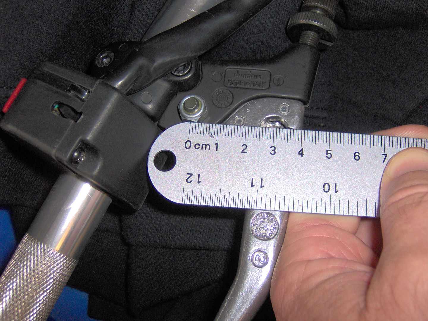

Here's one thing you might try, don't know if it's applicable to the V7 or not. Measure the center-to-center distance from the pivot bolt to the hole the clutch cable "barrel" fits into on the clutch lever. In the photo below it's 30 mm. If you can find another clutch lever assembly with a distance of 25 mm (for instance), that will effectively lower the clutch effort.

I have seen those devices advertised but if it is a 2:1 reduction in effort wouldn't it require twice as long movement of the lever?  I find that I must have my lever adjusted with minimum free play and then pull it all the way to the hand grip.  Otherwise shifting becomes difficult.  I don't see how I would be able to use a 2:1 reduction even if I could fit it on.
Re: Hydraulic clutch
« Reply #7 on: July 27, 2015, 01:14:03 PM »
No, the handlebar lever moves the same distance but it only requires half the effort, because it's only pulling the lever on the transmission half as far.
If "half as far" doesn't get you full clutch disengagement, though, it's not going to work on your bike.
  • Posts: 15100
« Reply #8 on: July 27, 2015, 01:17:28 PM »
Shifting can be difficult and many times engagement of the clutch is achieved when the lever is almost to the end of travel. Neither exactly optimal. A clutch lever assembly with a slightly "lower ratio" doesn't seem to have either of these issues. Or, at least, it's much less noticeable.
