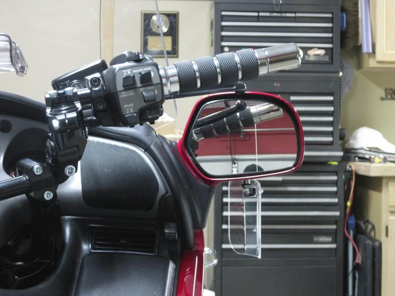

Vibes are not just from a motor.  A Goldwing has a smooth motor but the bars are mounted solidly to the triple trees which transfer "jolts" thru the bars.  My arms go numb with this jolting.  I use some "XL" weights with Helibars loaded with buckshot and padded grips.  Life is good.
