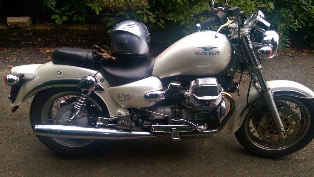

So I saw an ad on Craigslist three weeks ago for a 1999 California Bassa for again $2000, with 16k miles. Pictures looked good, but weren't the best.  I waited for it to disappear, and it didn't. So I arranged a meeting to go look after a week of listing figuring it's a sign from the Gods. Guy shows up and the bike looks good.
I take it for a test ride and I really liked the handling, very nimble for the size. More importantly, I realize it doesn't have foot boards, so I can use the toe-hill shifter like a standard bike. The seat has just been reupholstered so it looked great, and  more importantly felt good. The chrome looked pitted, and it's obvious the guy hasn't even bothered to wash the bike. I realized that buying a bike that is so different from what you're used to riding makes it somewhat difficult to judge if there something is wrong with it. I hit many false neutrals, but figure that's not unreasonable for a bike brand newbie. That said, the shifting on this bike was far smoother than I had expected from descriptions (industrial, tractorish) I'd read over the years.
As many point out, a bike's worth is what you're willing to pay for it. Typically on CL around here people post their bikes at KBB retail prices, and this guy had listed at under the trade-in value. I didn't even haggle, the bike looked good enough so I just paid the man.

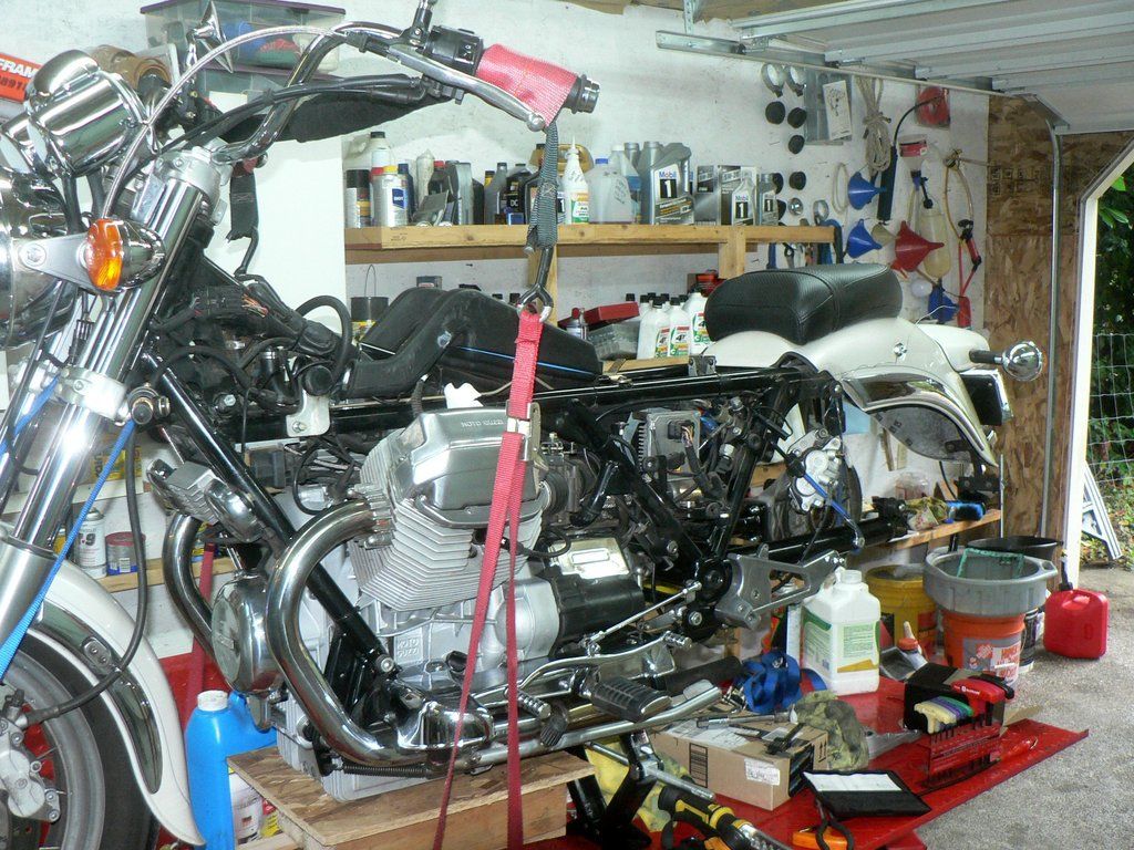

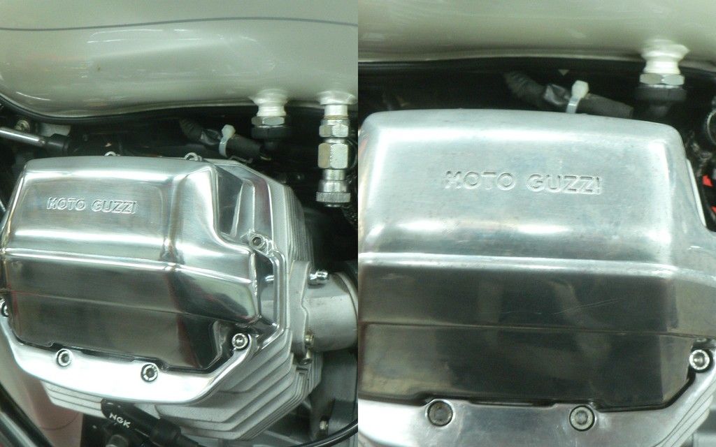

Got her home and put her on the lift and started cleaning her up. I am amazed how well it's cleaning up. There was no pitted chrome, given it's mostly plastic it simply wiped off and was perfect. Paint is pretty much immaculate, with minor scratches on front fender. I'm extremely pleased so far on the deal, and really like how the solid color white makes the bike look compared with the two tone versions.
 I'm do a lot of proactive maintenance on my bikes and tend to go overboard on such things, so have been reading  posts on the various components. Retorqued the heads, valve adjust, new cables for throttle and clutch, new rear brake rotor (required), rear brake pads, new wheel bearings (probably wasting money here, but had them fail on my VFR at 22k miles), fuel and air filter, all fluids, new rear Metzler Lasertec as the existing had lots of tread but was 11 years old. Drained all the gas given the tank was off and intend on running only non-ethanol gasoline in her as I have a nearby source.
 I found two of the valve cover bolts stripped, but I purchased a couple of bolts 5 mm longer and they appear to be holding securely. The electrically operated fuel petcock has been replaced with the screw type offered by MG Cycle. It has a 5 year old Odessy PC680 battery which I had tested and will keep running for now. Front master cyclinder was nearly empty and all the brake fluid looked very dark. I'll have to keep an eye on that to see if there is an issue.
Given I had the rear wheel off for tire replacement, I pulled the swingarm to inspect the cardan joint and grease the swingarm bearings. The cardan joint looked perfect, but was spinning in the carrier bearing. I put it in a vise as suggested in a Guzzitech article and looked for slop and there was some, as it rocked back and forth a bit. Not sure I made the right call, but A. your posts on catastrophic failure tend to put the fear of God in one and B. I have  a tiny bit more money than time (and brains), so I bit the bullet and ordered new.
 So after paying the registration, state sales tax and all the parts mentioned above, I'm at around  $3100.   That said, possible additions are a windscreen, saddle bags, crash bar (dropped my FJR in garage recently so this came to mind), and my kingdom for a center stand,  so the number will climb probably.

As to the comment of the valve cover bolt threads being stripped, I noticed most of the cover bolts had deposits of aluminum on the starting threads. I bought a set of 'thread chasers' and am going to run them through each hole when I pull the cover again.

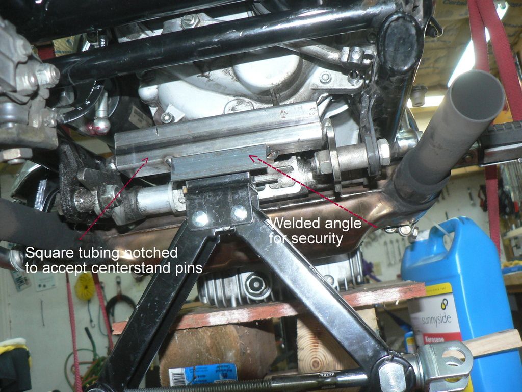

So I got a $20 scissor jack from Harbor freight, and made the tube/bracket shown in the photo. It worked very well, but I do have the straps on the handlebars for stability while on the lift and blocked under the sump regardless. Glad I did the extra precaustions,  as I was getting a bit physical when installing the swingarm (though it went in relatively smoothly following the comments on the forum).

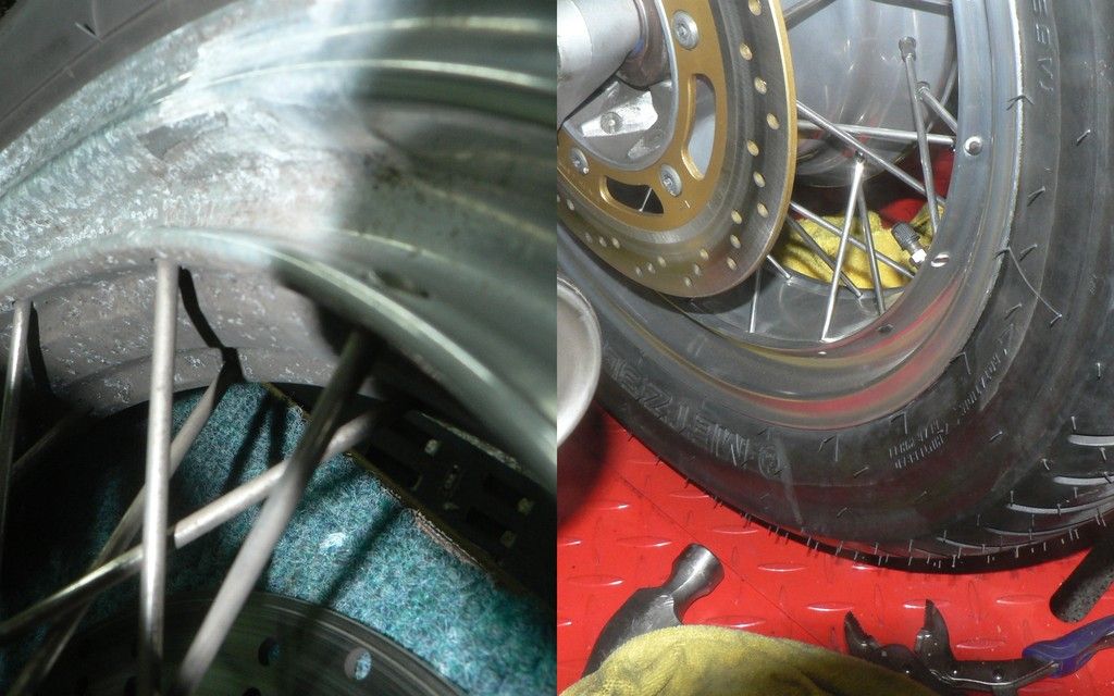

Somewhat regretted jumping into buffing out the spoked rims, but given their condition there was little choice.  Man, what a pain if you want to do it well. I'm trying just about everything I can find to make it easier, and will probably post on the matter after I'm done so that  others can learn from my mistake(s). Once I started, I didn't see putting it back together until the buffing was complete, and I haven't even started the front. It wasn't encouraging that everything I've read says it will be constant battle keeping them from corroding henceforth! I'm going to try several applications of Klasse Sealant Glaze in hopes it will help some.

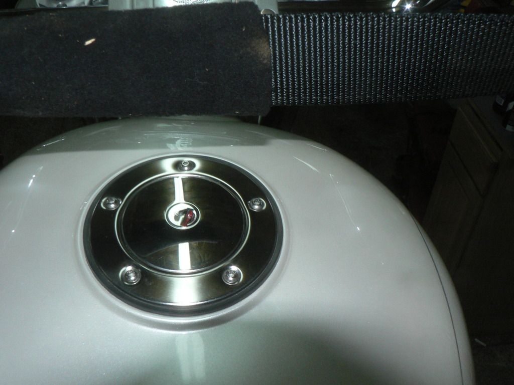

OK, I'm an idiot, but the instructions for tank removal do not say make sure the gas is below the level of the valve located near the steering head. I can pull the tanks on my other bikes while full. I thought there was some sort of check valve to stop gas leakage, but that was incorrect.

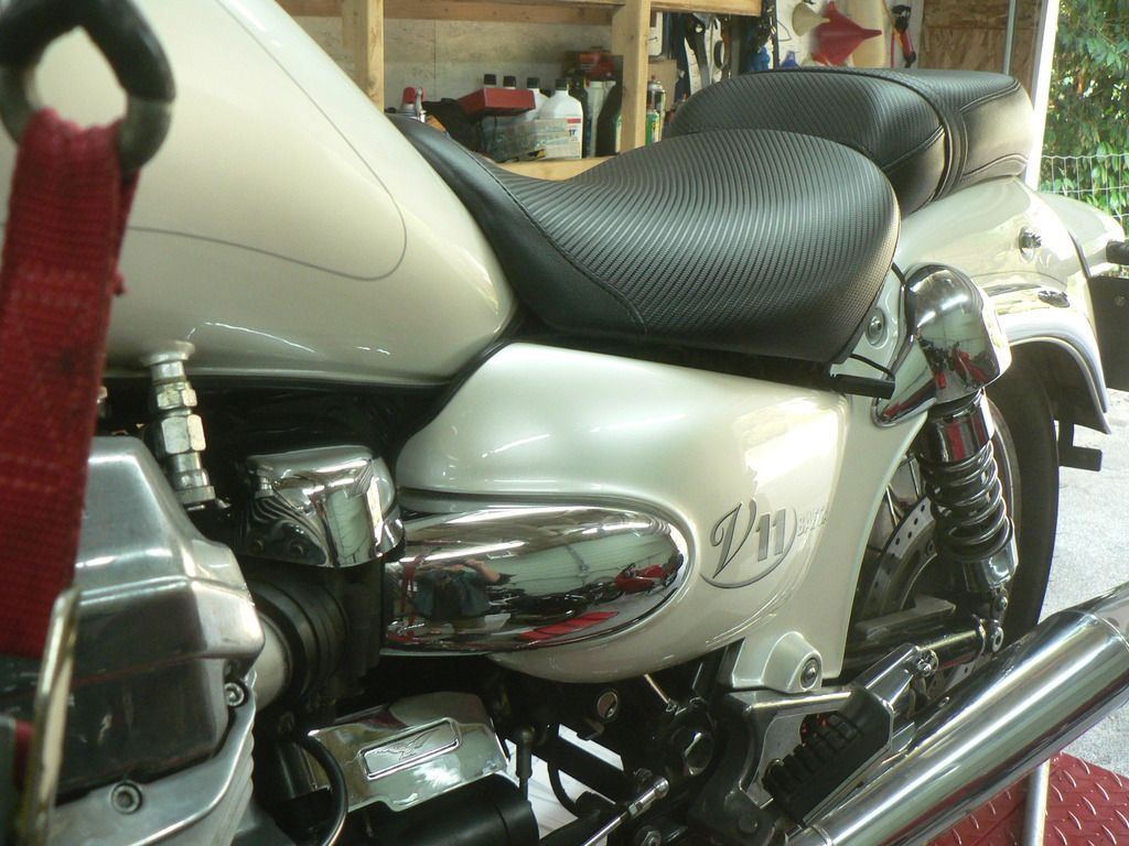

Heap as much abuse as you wish, but after polishing all the chrome plastic/metal and rims on this bike (I even went ahead and bought a bench top buffing machine from Harbor Freight! Please don't mention it to my riding friends, given my mouthing off on the subject over the years), she is going to be one of the most pampered garage queens you've ever seen, such that it may even make Harley owners envious!! OK, I admit Harley owners don't envy anything without the HD logo as part of their code, but she will be such a queen until the first unexpected rain squall is encountered. Usually takes about two weeks around here.
Would have been nice if  Guzzi  had kept the swingarm cover caps with the holes in them for locking the swingarm bearing pins. Probably because on this bike the pins use a 14mm hex, and there wouldn't have been much meat left in the cap to function as a locking mechanism.

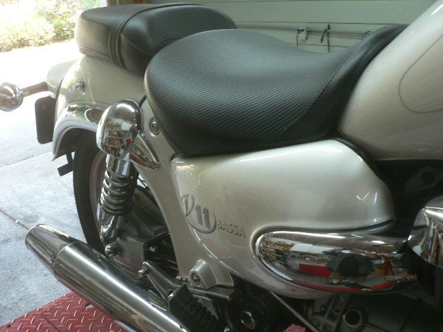

Surprised to see that there is no preload adjustment on the rear shocks, given I'm a fat guy. And the fact that changing the shock can affect the linked brakes. I'm not going to worry about it too much. I didn't use OEM rear pads, so I've already changed the relationship given the different coefficient of friction from design. I'll experiment with the length of the  spring to the brake valve to get what I'm comfortable with in the end.
I've found no definitive answer as to the design brake bias percentage for this 'Load Compensating' style of valve actuator. Proportional valve supposedly being  70% Front/30 % Rear (source Guzziology, page 19-54 with lots of caveats saying the percentages are not accurate in many cases/models), but not for the spring actuated valve. I infer that the intent was the same general  70/30 relationship. This system explained why when I got home after the buying it  I said 'this thing has a fantastic rear brake!'. I'm traditionally a front braker, and can understand the concerns of being forced to apply the front brake when unwanted in low traction situations.
Question: Other than the decal on the side cover, what are the difference between the California Special and the Bassa? I've assumed mechanically that they are identical, with all parts interchangeable. When looking at parts am using the Special listing if Bassa is not shown as well.

I've found no definitive answer as to the design brake bias percentage for this 'Load Compensating' style of valve actuator.  supposedly less front when applying light pressure as in parking lots and more to the front under agressive pedal.
 Most cal SS had steel tube type rims and non adjustable forks, in fact accept for body work the EV etc are also nearly identical parts wise.

Bassa's came out in 1999 featuring tubeless rims and adjustable forks.  Around 2001 or 2002 they were renamed Specials losing the adjustable forks and going back to tubed wheels. then called Special Sports with a red/black tank and then a Gold/black tank ("Copper top").  Then they were called Aluminum and then Titanium.  I'm not at home to consult my catalogs so a year it two might be off.

A few more photos to bore people.....
I'll probably post on my mistakes doing the rims. That was a real pain and I think I have at least 16 hours labor in them. I learned the valuable lesson that a shinny spot in an overall satin finish stands out like a sore thumb. I then gave them 4 coats of Klasse Glaze Sealant. It remains to be seen how that will hold up, but being a garage queen it won't be a real test.
Gave the covers a go, looks better but I'm still learning to polish metal. The Harbor Freight buffer was well worth the $32 with discount coupon. Is that an aftermarket fin guard shown, or did they come from the factory with them?
Very glad to read the thread about the plastic expanding in the gas caps. This thing was a mother and I was worried about breaking the key. The price for a replacement was very high, if I actually found the right unit.  Works well now-that's red synthetic grease in the key hole.
Also appreciated the comments in another thread about the plastic chrome pieces falling off, as one of mine had started to break lose. I siliconed the inside as suggested, so hopefully that will secure them adequately.

The bike is really looking great. Isn't amazing how much some polish or fine touches can improve the overall look -  and then there's the satisfaction of doing it yourself.
I'm not bored. But let's see some pics in in her natural habitat - mountains, curvy roads, expansive views, etc. Time to go riding...

Beautiful bike.
