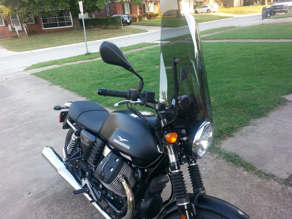

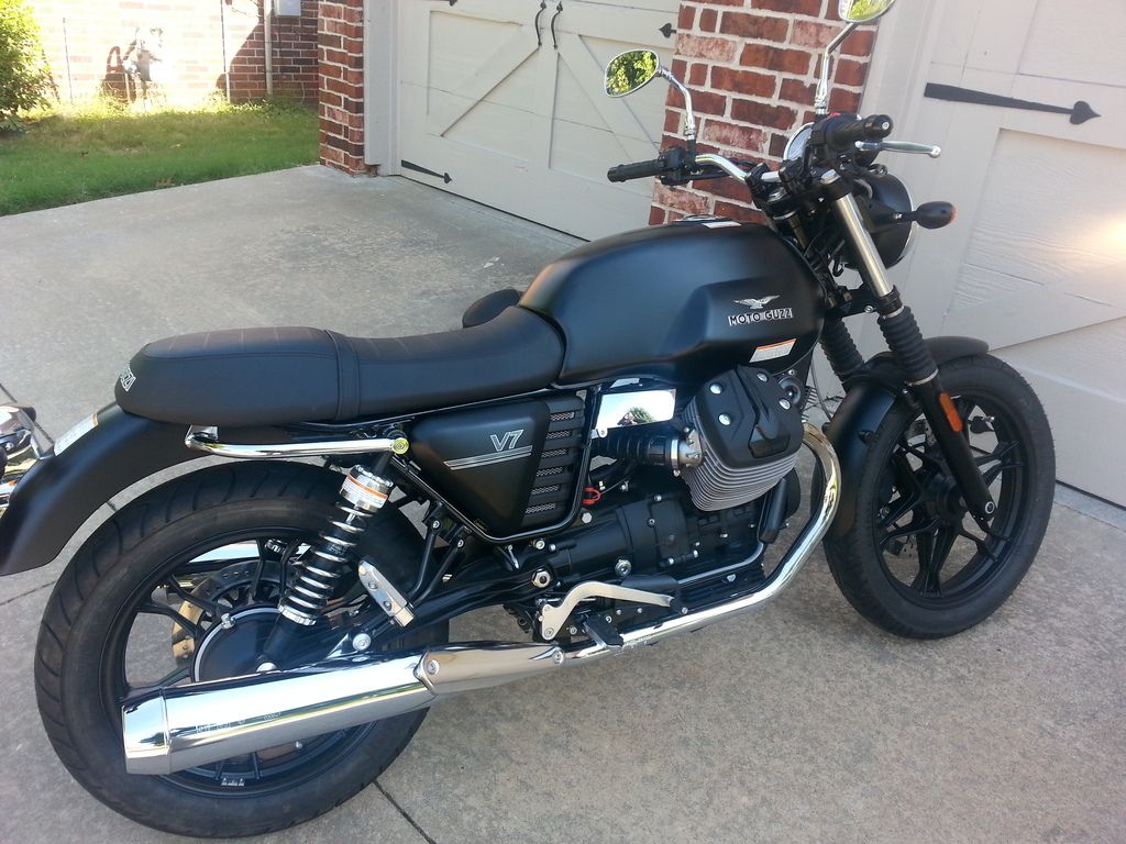

Below are pics before and after the windshield and mirrors install.
Stock Guzzi:
Guzzi V7 with windshield and aprilia mirrors:
Windshield got at mgcycle:
http://www.mgcycle.com/index.php?main_page=product_info&products_id=3115
Mirrors at AF1 Racing:
http://www.af1racing.com/store/Scripts/prodView.asp?idproduct=3052
Both working great so far.
-akilesh
