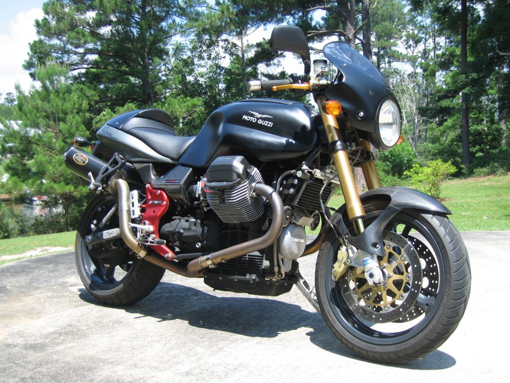

Some of you might remember my original post to the forum a couple of years ago titled "Rusty Rescue" after I drug home a weathered and damaged 96 California.
My failed first attempt at a Guzzi.
I found a V11 Scura in Wilmington and pulled the trigger. Did the trip today, and now the bike sits in my storage unit.
It's number 270 and I acquired it from the estate of a gent that passed recently. He was the original owner and I have lots of documents. The forks were even reworked.
I'm looking forward to finally getting to rock out the big twin.

« Reply #5 on: October 21, 2015, 10:03:09 PM »
The Scura owns you now. Ask me how I know. She's lovely. How many miles?
I spy aftermarket footpegs, gear-shift, and turn signal lenses.
Don't wax that matte finish. Get yourself some special matte finish products. Keep her dark and mysterious...
Pop over to V11LeMans.com and say hi; add yourself to the Scura Registry.

The bike has 17,700 on the odometer. I have documentation that the forks were revalved, and resprung. Cant find any info in the paperwork about the clutch being touched. The gent was diagnosed with cancer in 2005 and the mileage pretty much stopped around then. he did put 13k between 2002 and 2003.
Bike was originally delivered in December of 2002 by Uncommon Motorcycles in Erie Pennsylvania.
its number 270... does anyone remember a board member named Robert Burch? He was the original owner.
Im going to give her a full service. Maybe my buddy ( a BMW mechanic) and I will pull the trans and take a look at the clutch...

...is the scura's frame shorter than the la mans ?
I recall the 2000/2001 naked "red" frame spine are shorter then the le mans and all the other v11 spine family like bellagio, rosso mandello etc.
The '02 Scura frame is the same as the LeMans and other later V11s. The "early" red-frame V11 Sports were a bit shorter. Here's a link to some of the model year changes in the line:  http://www.v11lemans.com/forums/index.php?showtopic=5691
