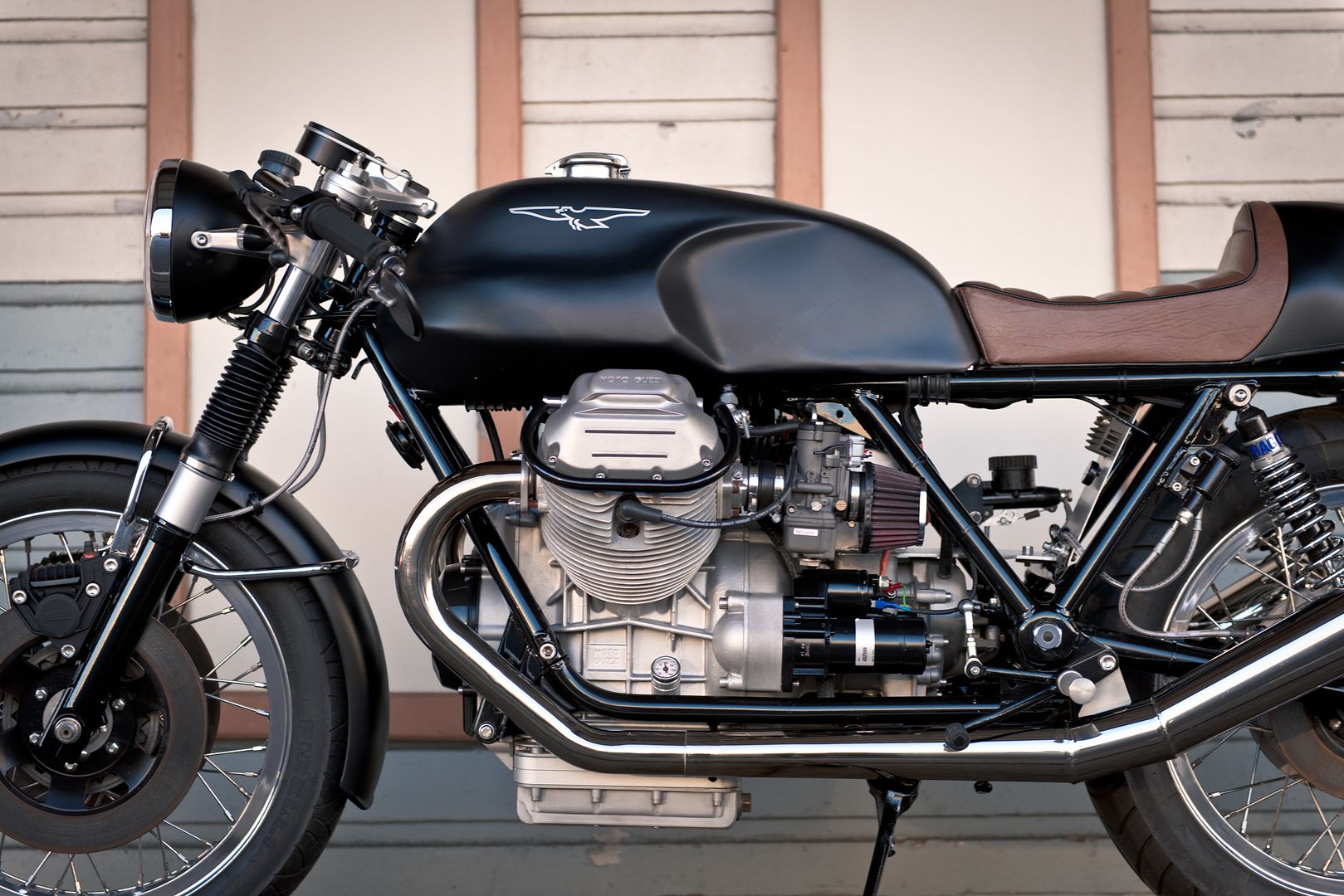

I've seen some Mistrals that are upswept and look and sound great. Not cheap though. I'll be interested to hear if there's anything else.

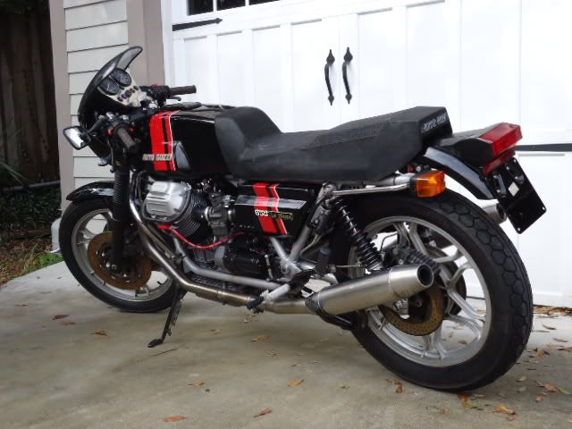

« Reply #10 on: October 26, 2015, 03:16:07 PM »
So, here is the bike as of today. Hoping for something fitting to my idea. Have already spent a lot of ducets so far and hoping someone can help with something not too dear.

Pancake.....did these fit the stock crossover? Do you have a photo on your bike? And how loud are they?

« Reply #17 on: October 26, 2015, 07:25:12 PM »
Nice Bike.
I fitted a up-swept pipe designed for the SP to my T4.
So a few things:
The foot pegs will have to be bent up out of the way, or replaced with foot pegs similar to the SP's as there is not enough room under the passenger foot-peg to allow fitting.
The mounting on the muffler is further to the rear so will require an extension from the passenger foot-peg or fabrication of a strut from the frame.
I also fitted the cross piece for the SP as the original cross over allowed the first part of the muffler, before the up-sweep,  to hang down slightly . The SP H piece has a slight bend which levels out the first section of the pipe.
Stein Dinse Australia might have the pipe you are looking for. They have them manufactured through http://www.dropbears.com/o/overlander/euro.htm
