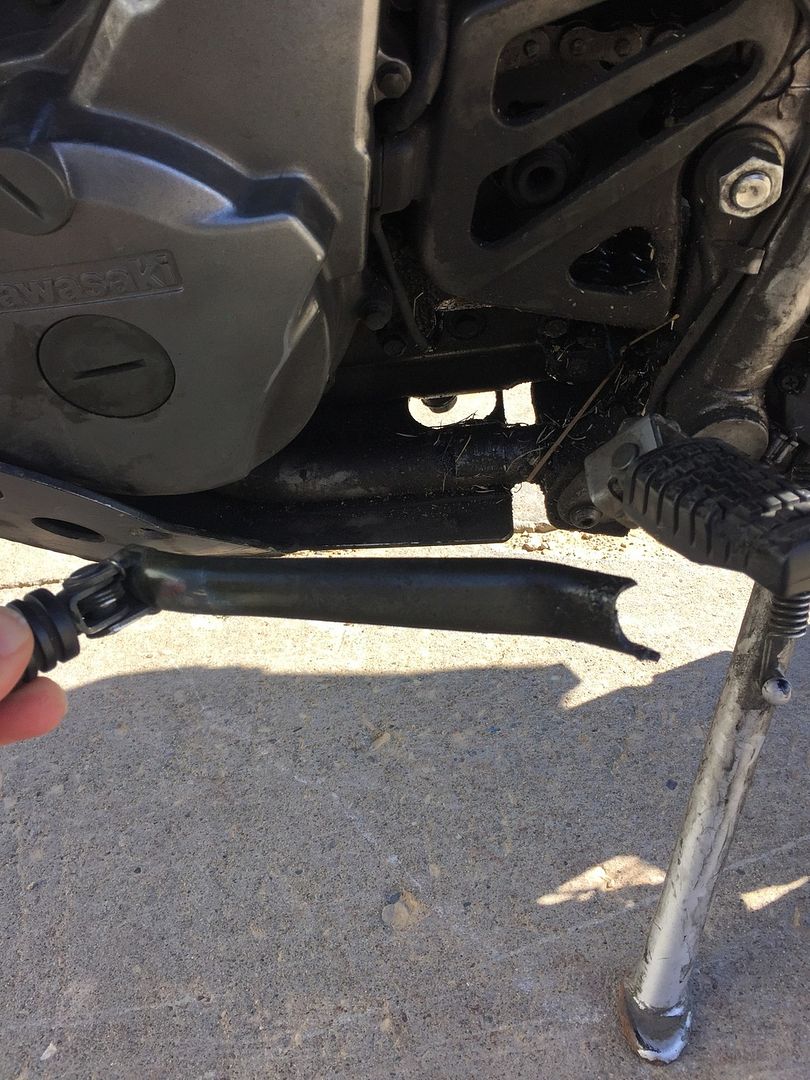

I notice his shift pedal is barely hanging on for it's life. Nik gets off the bike, and the shift lever pulls right off. My first question is "what gear are you in"?, which is followed by "first" and then a "f*ck" by me. Time to assess the situation.

The shifter is die cast material. No chance of welding it back on.

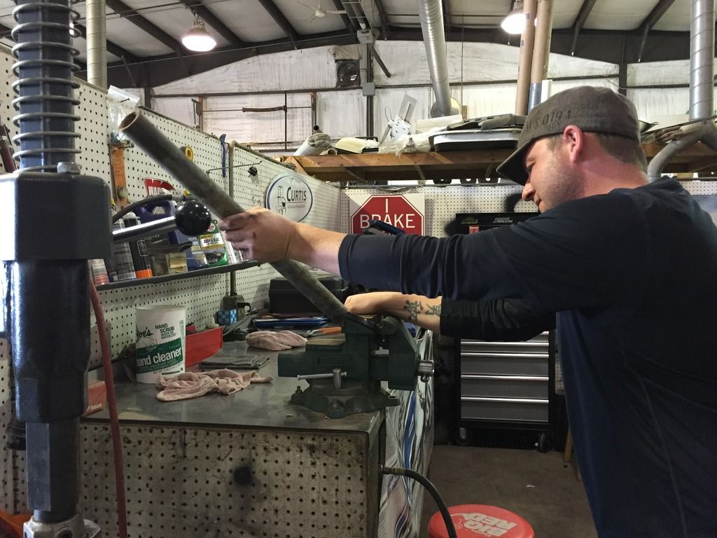

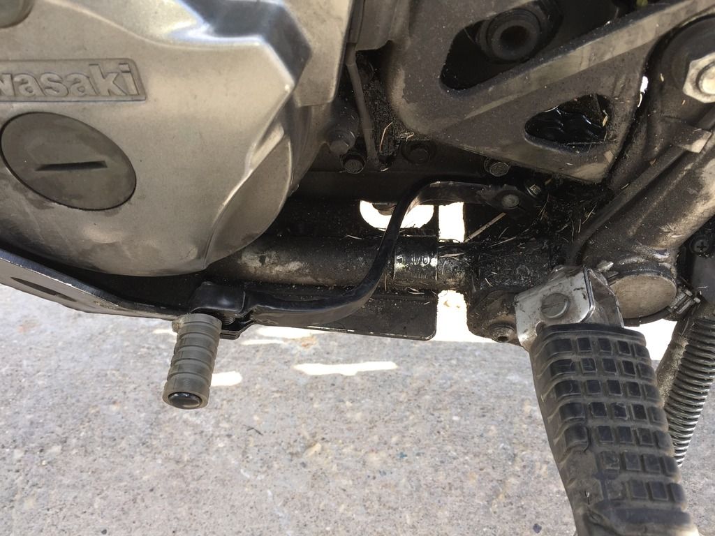

Nik pays for the shifter, and we decide to have a go at it. With the shift lever being way too long, and the tranny pivot being recessed in the frame, we still couldn't determine if the shifter splines would even fit. So we went into the shop, and Nik started to bend the shifter. The first bend was enough to have clearance just to make sure the lever would fit on the splines. It did! Huge sigh of relief. It probably to us about 6-8 trips from the bike to the shop in order to get the shifter to where it was useable. Good thing that lever was too long, as it shortened up quite a bit as more severe bends were put into it. I really thought that lever was going to snap, but it turned out as close to perfect as you can get. Nik also noted that the bike shifts much better now.

It takes a giant lever to bend a lever:
Finished product:
