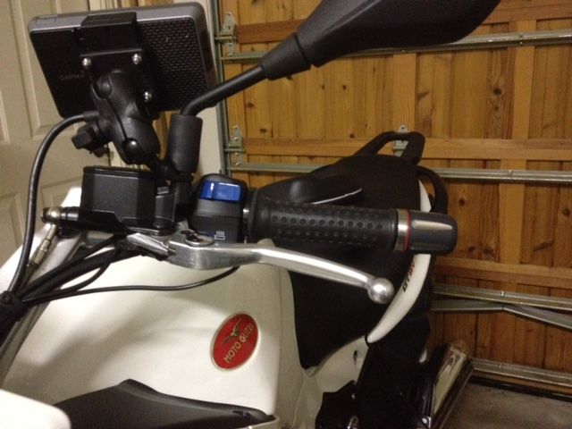

I was thinking of doing this on my bike but wasn't sure if it would work with my setup:
I have seen how the handguards will work with a throttlemiester, but I also have a Ram GPS mount on the left mirror stem.  Do you think the GPS mount would interfere with the handguard ?  I'm not sure how the handguard attaches on that side ?  Your thoughts on this appreciated --
This will depend on the length of the stem on the mirror - hard to say. An alternative for you is the RAM base that mounts to the top of the clutch reservoir; I use this (GPS on left) as well as one on the brake reservoir on the right for my SPOT tracker.
You can also use a slightly longer machine screw and some washers to re-locate the RAM mount you have to the windshield pivot bolt. Some riders like the centered position this gives the GPS; I might have done this, but the two GPS based devices need to be at least 9-12 inches apart for best results.

Post a pic of your setup and I can tell you right away.

I've got the "long" version of the Throttlemiester bar ends and the Ram mount on the mirror stem.  As ITSec pointed out, I could pretty easily move the GPS mount if necessary, but I'm wondering if I could install the hand guards as is ---
Thanks for the replies !
They should go on OK. The hand guards have a recess for the threaded portion of the mirror stalks. From the pic you might only need to put a spacer of sorts in that recess and put everything back on. Use SS washers HD Lowes or Orchard will have them. I think 2-3 washers should do the trick.
If the mirror stalk threaded portion is not long enough then you could remove the lower but and replace that with something of a normal thickness and that should give you more than enough reach with the threads. The lower but is nearly twice as thick a a standard one. Do not use thread locker on the mirror stalks.
