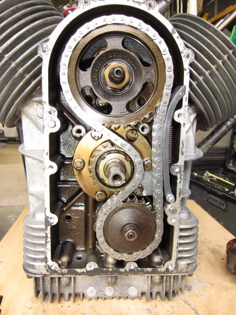

As foto says, it can be done, I've done it too. You only have to grind one head off one pin. do it with a pin at the bottom of the engine and use lots of rags. The rags collect all the crap.
The oil pump sprocket is easily removed to access the new tensioner bracket and when refitted, it is the only one of the three you can rotate to help bring the chain round.
I found it easier to remove the tensioner blade and spring and then fit the mounting bracket and chain first, then fit the blade and spring last...gives you more room to work in.
Just remember to align the timing markings on the top two sprockets and make sure they don't move as you link up the new chain.
The pic shows mine fitted.
