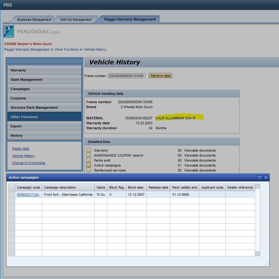

Piaggios warranty was down yesterday, so I could not check the vin. Since then you have found out that it is in fact a PI motor. Recalls for mechanical updates do expire which is why a VIN check shows it to be not affected. So the other dealer who told you this was relying on what his Piaggio rep told him.  The steering stem recall  is a federal safety recall and will never expire until carried out. If the lifter upgrade had been completed it would still be shown in the history. It is possible although doubtful, Piaggio may still cover it. But the bike would have to be at a dealer for the service, not in a home garage.

That's interesting. The rep told me my warranty date began in February 2003. He must not have seen the 1 in front of the 2.
I'm still attempting to work something out with the regional rep through my local dealer, but Im not holding my breath. The rep insists, however, my VIN was never part of the program, which is why the previous owner parked it once it began to tap. Guzzi said it was not recalled and he could not afford to fix it. So it sat.
I phoned two dealers before I purchased it. They did as you did. They looked up the VIN in their computer. The VIN did not show a tappet recall in the dealer database, so they said it was OK. I don't blame the dealers though, they relied upon Guzzi's database.
If there was an open but expired recall, the database should have shown that. Instead it showed that the bike was not one of the affected models, which they repeated to me, twice. They surmised it was fixed prior to sale.
I believe this bike was never part of the voluntary recall, but it should have been. If it was recalled, they might honor a portion of that recall, and I would be happy to take it to a Guzzi dealer.
