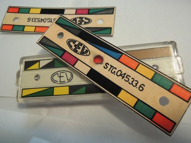

I think Jim is referring to these -
Am I right Jim?  :grin:
Yes sir, the Aprilia lens is unique and the CEV clear plastic lid is also unique to the V7 Sport type fuse box.

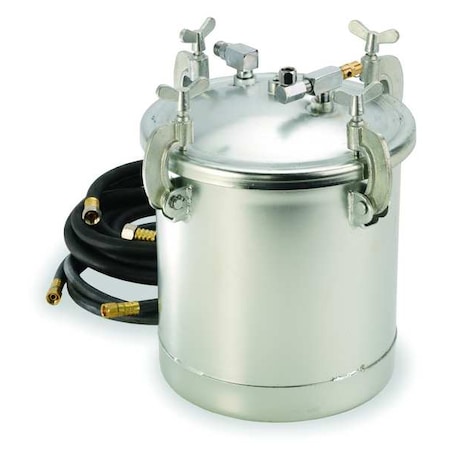

As I said in an earlier post, we used to put them under pressure, not a vacuum. I can't remember the pressure for sure though. That might be easier to rig something up than for vacuum. Worth a try.
1949 GTV - 1948 Airone
www.scramblercycle. com
How was pressure introduced?
Introducing pressure could be pretty easy.
I can secure the mold shell with rigid caps top and bottom and seal it all with threaded rod at four corners.
Does it make sense to add air pressure direct to the fill port with a regulator and an air fitting? I would assume the vent port would need to be capped.

« Reply #29 on: December 28, 2015, 07:43:51 AM »
We put the entire mold inside a large pot and then clamped on a lid. Pumped in "x" amount of psi and let it sit until the curing time was up. I seem to remember something like 70-80 psi. Do you have a pressurized paint pot hanging around that is large enough to fit your mold in?
Were I worked at we had really large pots, about the size of a 55 gallon drum, they could hold several smaller molds at the same time.
