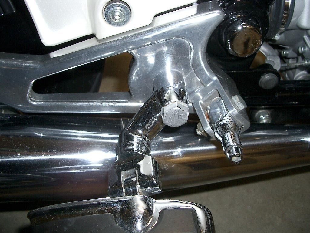

I used a Kuryakyn offset of some sort.  I had to fill the inside of it with serrated washers to get to grip the side plate.
I left a "stub" in the original cradle for a rear set for myself.
