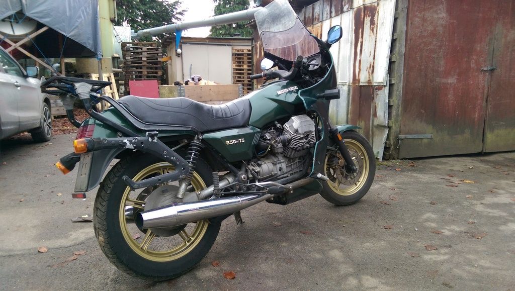

Sometime later I found a cheap 850T5 that looked pretty unloved but was registered in Denmark. So I made an even cheaper offer and the seller agreed to the deal.
This is the bike I picked up in dire need for some TLC.
While the bike looks okay on the pictures it was running very rough and needed to have new tires and a bunch of other work to get it thru the MOT. First plan was to change the front tire and get the bike running well enough to get the MOT. But after several tries to get it running smoothly I ran out of time and out of patience. The wiring loom was completely botched by the previous owner and would need some serious work to get sorted out. (Every time I fixed something on it something else broke or stopped working�)
I ditched the idea of getting the bike road worthy in the state it was in and put it away as I had run out of time.

Thanks for all the approvals appreciate it!  :laugh:
I don't have so much more to show you as I didn't take that many pictures. I do have a bit more things.
The old front end had a wheel axle diameter of 25mm so I had to change the bearings in the wheel to have a internal diameter of 20mm as the new front end. This is the spacer I made to fit between the bearings. The two larger diameter sections is to concentric center the spacer in the wheel.
I delinked the brakes so I had to find a new position for the rear master brake cylinder. I have looked at a bunch of pictures of custom Guzzis to try to figure out the best position. This is the position I choose, hopefully it will work out just fine. One problem is that it is not possible to weld the brake lever at a right angle to the brake cylinder as the swingarm pivot nut is in the way.
On the original custom (can you even say that?) the rear wheel spacer was not really working really well so I had to make a new one. I made a nice new one only to find out that there had been an extra spacer washer in between on the old one. So my nice new spacer was 5mm too short.. Bugger, had to make another one with the correct height. Don't have any pictures of it unfortunately.
Ulrik

how about mounting that rear master cylinder backwards? on a bracket ?? Keep up the good work  :thumb:
I was thinking about that, but the exhaust bracket/rear footrest bracket was in the way. I did have to make new exhaust brackets as the lafranconi exhausts wouldn't fit on the ones from the footrest kit. So it would be possible to do so. If it doesn't work in the position it has now I will move it to the rear.
