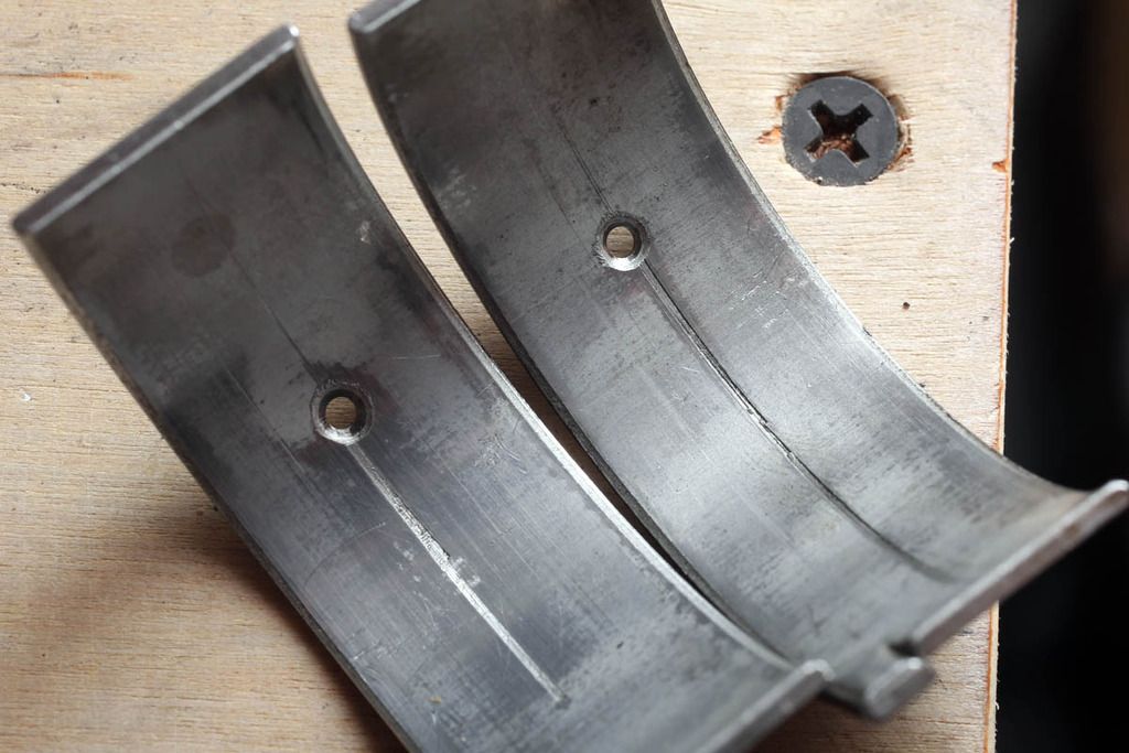

I'm  rebuilding the engine in my T3 just for the hell of it, it was running quite well but I had little idea of the condition of the bottom end as I'd never ventured there before, but I bought the bike as a fixer upper a couple of years ago and rehabilitated the rest of it from a pretty poor condition so it was time to have a look over the winter.

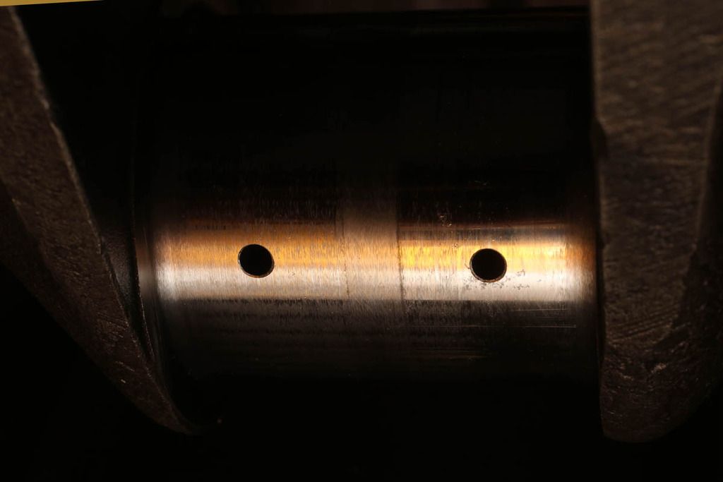

This is what I've found: The big end shells on one rod have large linear score marks the run through the oil hole, which is puzzling. I noticed that the oil holes in the face of the crank do not have any kind of bevel or chamfer and wonder if this has caught on the oil hole in the shell, is that a feasible theory? Did the crank originally have a chamfer and is this an indication that this has been reground? Is there a home remedy to chamfer the crank or is the a machine shop only (ie: a have a countersink bit.....only kidding!)

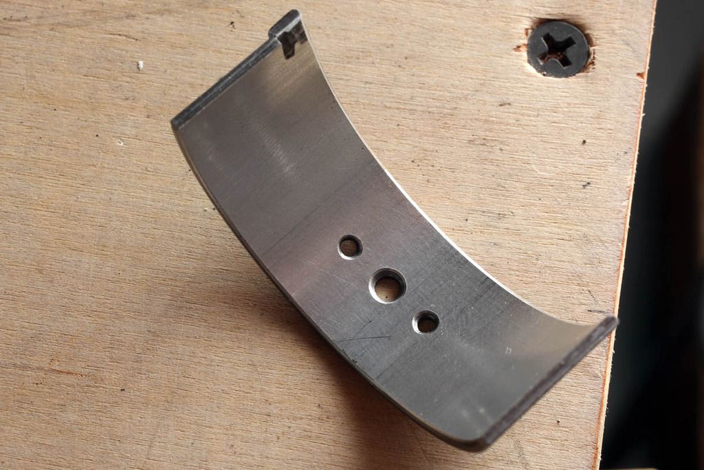

I ordered new shells but these turned up with three oil holes instead of one, and none of them align with the oil hole in the rod. My understanding is that the oil hole into the shoulder of the rod is some sort of oil jet of questionable value to lubricate the cam, is it safe to use these or return for the much more expensive item. Some Guzzi's with the same crank have the hole in the rod, others don't and I've read conflicting information on it's worth so just throwing it out there.

If it were a burr on the oil feed hole, wouldn't the 'gouge' go 360 degrees? It looks like the damage goes part way, then stops, like contamination that spun around there a bit, then stopped.
Right, not good.  If the bearing halves arrived with no holes, I'd be OK with drilling them in the right place if I had to, but having three that don't align is wrong.  I'd return them and explain why, and give the seller a chance to make it right.
edit:  There isn't a groove that connects the three holes on the back side, is there?  That would allow oil to get to the rod hole.

Can you feel that ridge on the crankpin with your finger? Looks big enough. If you can you need a regrind.
As for the oil feed holes? These have always been a bit of a non event. Over the years it has been experimented with one, two, none (With reliefs in the flanks of the big end castings of the rods to throw oil out *Somewhere*!) or, if you decided for whatever reason to upgrade to aftermarket rods Carillos were usually the rod of choice and these used no drillings or reliefs at all! And you know what? They all seemed to work equally well! :grin:
Regardless of the theory behind the drillings the fact is as long as the rod side clearance is adequate the thrashing of the crank will be quite sufficient to distribute the oil everywhere it needs to go as there is a lot of throughput. On the modern 8V engines with very truncated skirts on the pistons I still honestly query the necessity of the under-crown sprays but they certainly can't do any harm and the Pistons do have substantially less surface area to dump heat to the cylinder walls.

      Similar scored conn. rod bearing appeared on my old lump when the original chrome bores started to flake, but could be from anything passing through. Make sure your cam followers are in good shape as they tend to give off chunks when going south.

To me, there looks to be a chamfer in the crank oil holes. In my view, the crank looks good. I would guess-do to the location and angle of the rod holes-that there purpose was to spray the cylinder walls?? Installation of the rods is with both holes and both ground flats of big end, (both hole and flat being on the same side of rod), facing towards the right cylinder. I would agree with Wayne, probably some loose swarf dug in. Not the first I've seen looking like yours.
I don't know where you bought the bearing shells, but MG Cycle offers three different rod shells. Those like yours with three holes (cheapest), some with two holes (most expensive)
and some that have only one hole (priced in between the other two)
IIRC, I always order the two hole version for early engines with the oil squirter hole in the connecting rod.

I didn't explain properly. I mic'ed the crank before ordering new shells and it's within spec, nice and smooth with no ridges and as you mentioned the old ones looked in reasonable shape, next week I'll have a plastigague party. I was thinking the lack of chamfer may have been a result of a welded and ground crank.

Race rods do not have oil holes in the rods. Just use the right thickness shells for the diameter of your crankpin.

And you know what, this bike had flaking chrome bores when I got it and first thing I did was replace them with Gilardonis. Perhaps it's suffered from the same fate. Thanks!
Well, looking at the bearing shells, *something* nasty went through them..

 Exactly. Any time a groove starts at the oil hole and travels 'round the bearing you can bet some swarf came down the pike and tried to go 'round with the journal. Only the embeddability of the bearing surface prevents disaster.
