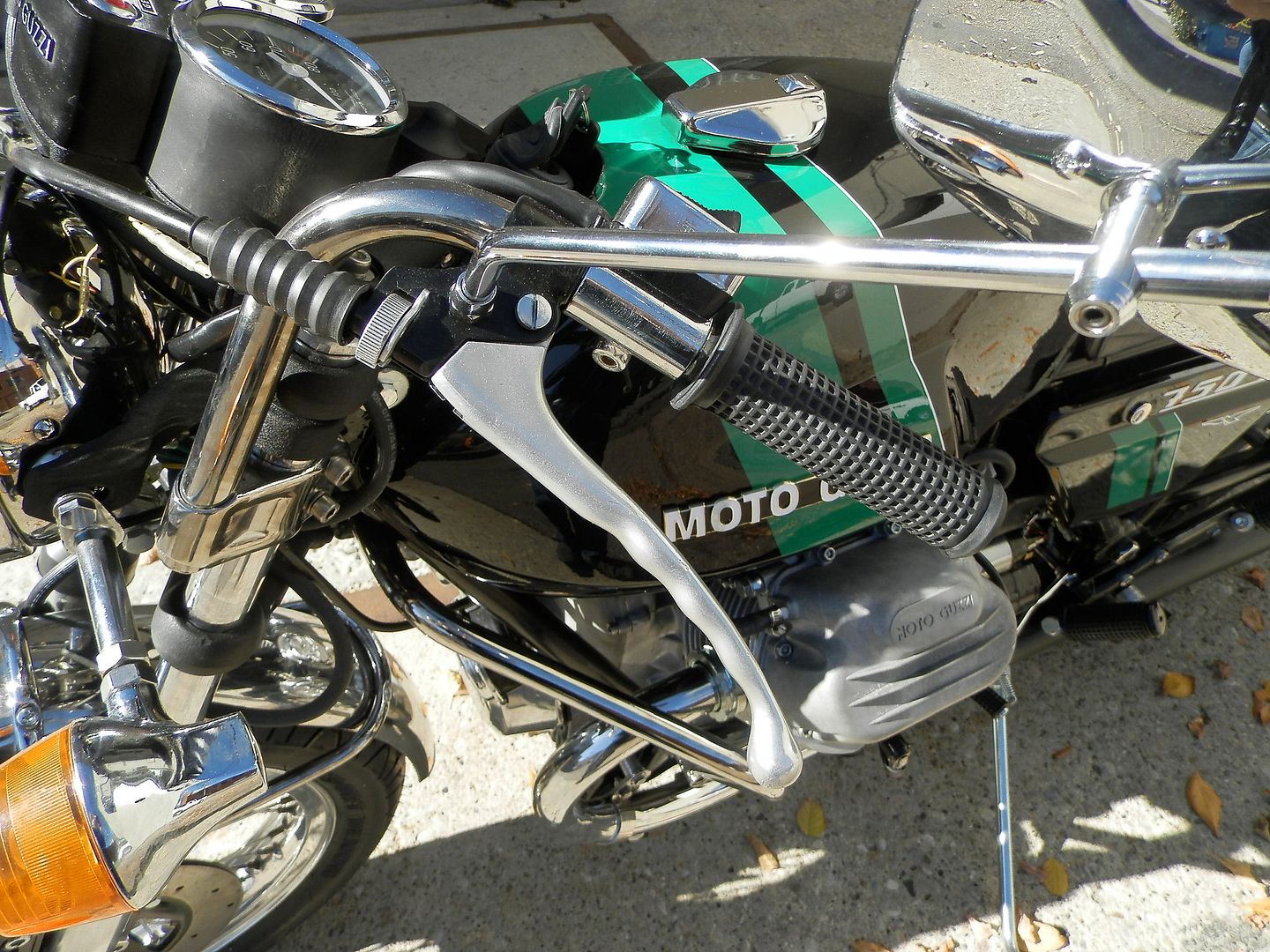

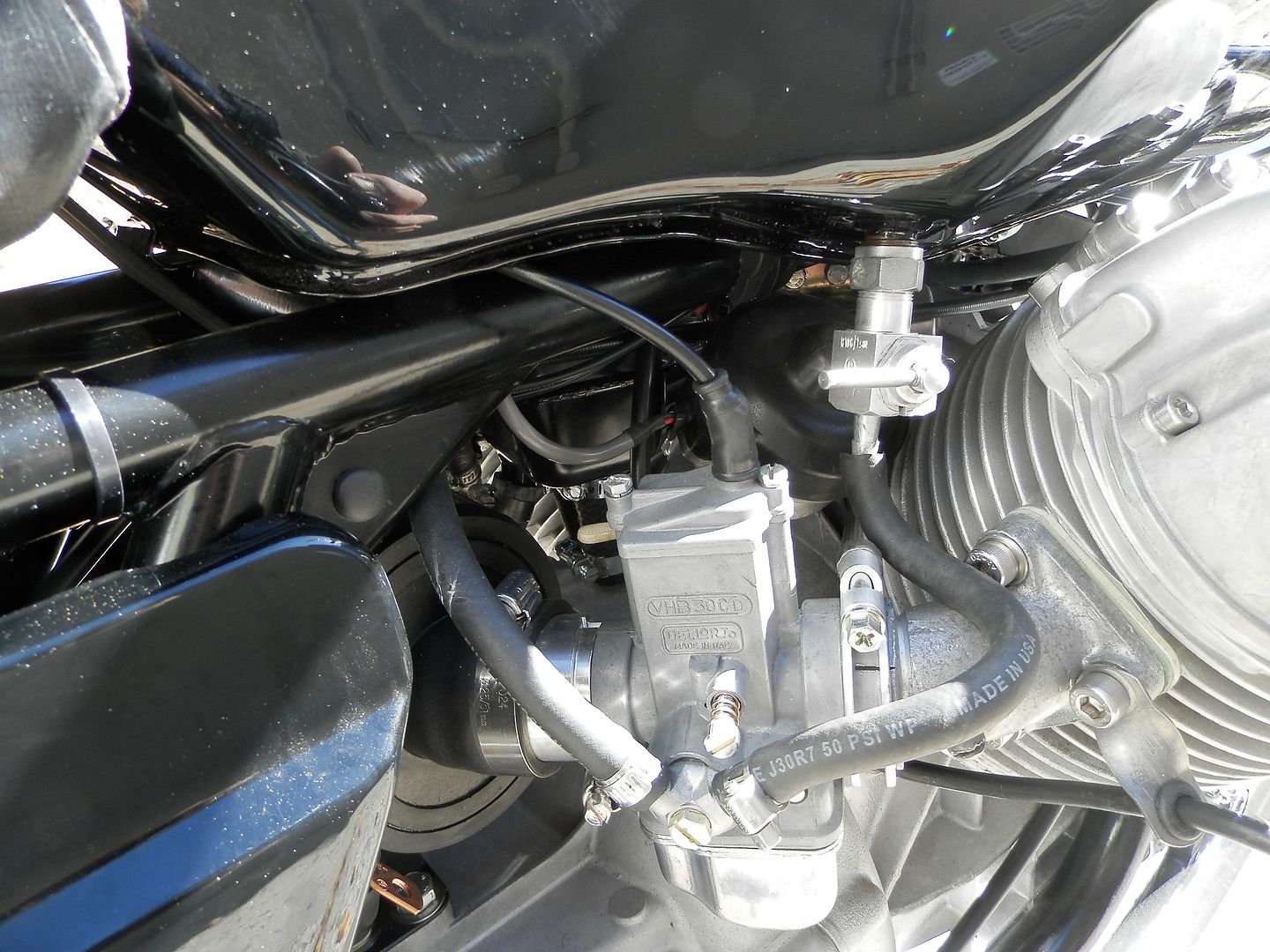

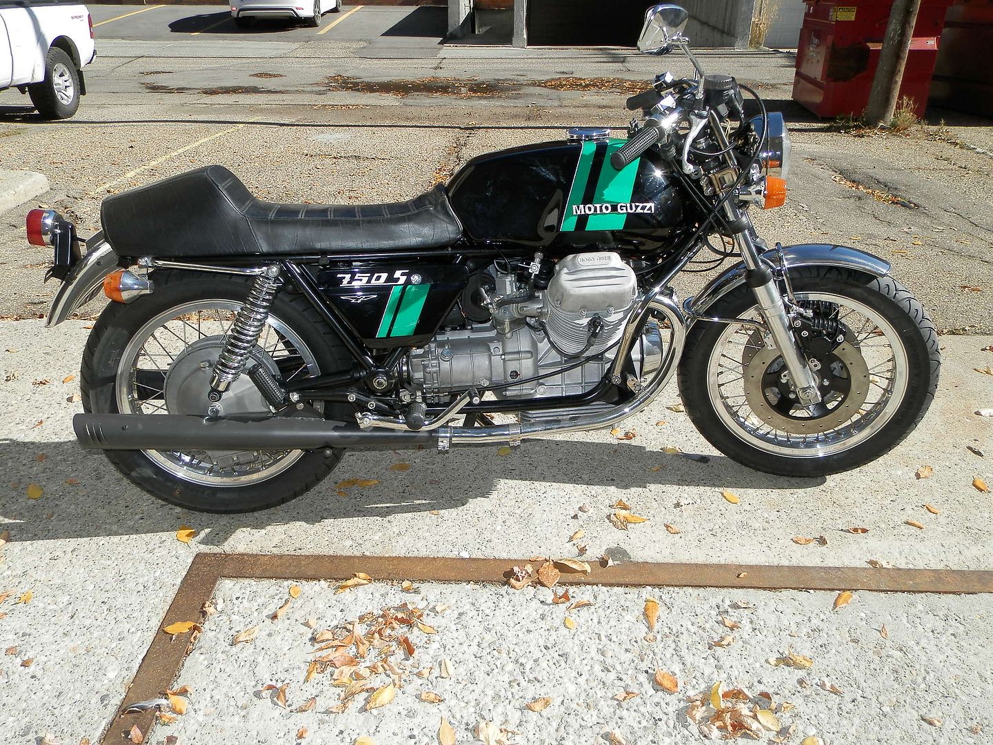

Re: 750S The Build is Done
« Reply #191 on: September 24, 2016, 03:06:32 PM »
I took some outdoor pictures today, I ain't much of a photographer though!
these may be helpful though to anyone one wanting to rebuild one or assemble a clone. It's about 97% correct except it would have come from the factory with the small non solenoid starter and the tachometer should have the fat needle.

What is that boss just below the brake rod? Left over from when there was a cable?
2001 V11 Sport

« Reply #199 on: September 26, 2016, 03:35:59 PM »
If anyone gets that critical about such a fine build I suggest that you treat them to "a punch up the bracket" to use some old Anglo Saxon saying  :grin:
« Reply #200 on: September 26, 2016, 03:46:47 PM »
Yes. that's right. Cable operated brake was on the left side.

  • Posts: 15234
« Reply #201 on: September 26, 2016, 03:56:37 PM »
That backing plate was originally the Loopframe 2LS front with an added stud sticking out the bottom for the torque rod attachment.
« Reply #202 on: September 26, 2016, 04:50:15 PM »
Yep. The same brake is fitted to the front of my old V7 700. The V7Sport/750S one still has the groove cut to anchor the brake to the loopframe LH fork.
« Reply #203 on: September 26, 2016, 06:19:03 PM »
The V7 Sport was a bit of a parts bin bike in some ways, sure the frame was brand new but the engine, transmission and rear drive were all carry overs from the Eldorado.
As Charlie stated even the rear brake plate is from the front brake of the 2LS Eldorado.
Guzzi still deserves a lot of credit for being able to work with very limited resources to create something so very different with their first foray from the venerable Loop.  Going forward from the V7 Sport each years iteration of a sporting Guzzi was a slow progression of the last, evolution and not revolution.
That brand from Germany with the boxer motor has followed a similar approach to development, as a sporting machine I  think Guzzi got it better from the start. For all the acclaim the R90S gets, I feel Guzzi was years ahead of the Germans with the original 750 Series of sporting bikes, and then came the Le Mans, no contest in my mind that Guzzi beat BMW hands down with the 850's.
